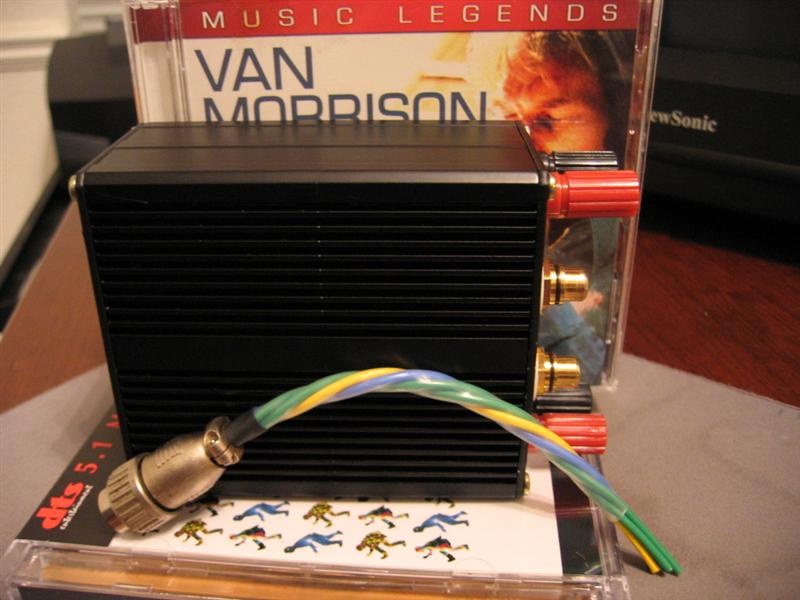

Hey Peranders-
Awesome looking board. Really nice work.
When are you going to have assembled boards ready to sell? 🙂
Joking... But no way I'm going to burn my fingers trying to solder that small.
What is the “extra” male quick connects on the board for? 2 for AC input, but I counted 3-4 more on the board.
Again, GREAT looking work.
Thanks,
Troy
PS, For my idea of miniaturizing... See attached photo.
Thanks,
Troy
