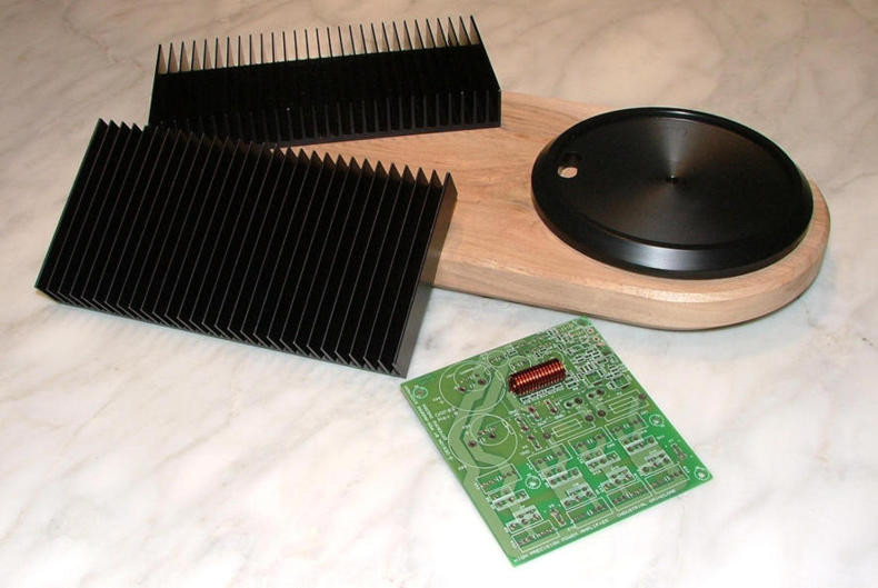

If you mean the blue thing, it's only for the photo, to show what is going to be used for the lug connectors. It's a lug contact without a cable.rabstg said:What is the “extra” male quick connects on the board for? 2 for AC input, but I counted 3-4 more on the board.

The blue female quick connect is plugged onto a quarter inch male quick connect that is soldered onto the board.
The part that is soldered onto the board is the part I'm curious about. I see 2 x pwr input, 2 x spkr output but then a few other "extras" on the board.
Thanks again,
Troy
Thanks again,
Troy
I have three GND connections and the purpose for this is, option for one or two rectifier bridges. If you have one bridge and four wires, two of them are ground.
