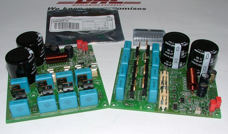

Hi P-A!
I have done all the SMD-work exept for the op-amp. I have not heard anything from AD yet, but if anybody knows if it's possible to buy the op-amp anywhere I'll do that. I don't want to solder on the rest of the components before I have the op-amp on place.
The only thing i miss exept from the op-amp is the output coil.
Could You send me two of these P-A??
BR AndyB
Hi P-A!
BR AndyB
Hi AndyB,
From Per-Anders' QRP02 pages:
Well, why don't you just take a 1.5mm diameter wire (single core, no litz, preferably 'copper-laquer' or 'transformer winding' wire) and wind 14 turns of it around an 8mm drill shaft or screwdriver?
After all, you're a beta-tester.
The 'end users' would have go through that, too. 😉
The tolerance of the coil's inductance should not be of too much importance, so even if you can't measure your winding result, 14 turns around 8mm should be sufficient (according to most literature sources).
Sebastian.

I have made two inductors for AndyB 🙂
No sek, I haven't investigated the need or "unneed" for the filters. I leave this to be something for builders to find out.
Just for reference:
Length 25 mm.
8 mm, 1.3 mm wire, 17 turns = 1.0 uH
10 mm, 1.3 mm wire, 17 turns = 1.4 uH
8 mm, 1.5 mm wire, 14 turns = 0.7 uH
10 mm, 1.5 mm wire, 14 turns = 1.0 uH
As you see it's not particulary sensitive how you make your inductor. Somewhere between 0.7 and 1.4 uH is normal think.
It's pretty easy to wound yourself. You just have to have something round, long arms 🙂 and a straight wire. I have praticed winding coils so I have technique but it's pretty heavy work.

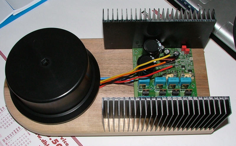

O.K. to be a bit more specific.
These are all the remaining caps for the amp and the caps for the rectifier part on the board. All I need now are the two transformers and the big power supply caps (4700µF/50V).
Then a bit more fidling around with the housing and that's it.
Keep you posted.
Cheers
Walter

Hi P-A
Didn't knew at the time of ordereing that ELFA was a distributor of Elna cap's. I just used the partnumber code from your sheet to order the parts I couldn't find elsewhere. I now gonna use the TSHA type from Panasonic. The 100µF/50V cap's are also from Panasonic but the FC type.
Cheers
Walter

And guess what......
A few moments ago the transformers and the remaining power supply capacitors were delivered.😀
That means I'm gonna be really busy tonight!
Walter
Walter
