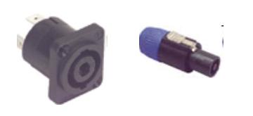

BTW .... are Neutrik Speak ons available in India? I have depleted my imported stock and need some more. A lot more.... by mail order.

There's a dealer for Neutrik on Lamington Road in Mumbai. I'm heading down that side today, let's see if I can pull out contact info for you and whether they'll ship to the NE.
He seems to have a good collection, and prices aren't that bad. Gold plated RCA plugs are about 50 each, balanced 1/4s are about 70 bucks, and unbalanced 1/4s are 65 or so. He revers me since the day I walked into his shop and bought 4 grand worth of plugs and wire in one go to rig up my recording rig.
I saw speakons on a poster on his wall, dunno if he's got stock? I'll check!

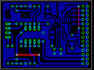

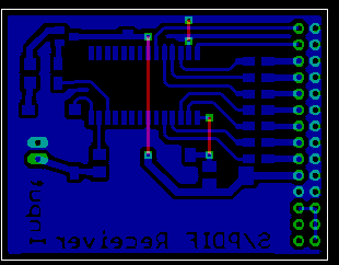

Tarun,
I have made two boards using SOICs, 1206 and 0805 sized SMD packages through this guy by giving him laser prints. All traces were 0.016" (that makes it 16 mil? Sorry, I always forget) I have a 1200 dpi laser whose density setting I set to max. I'm only worried about some tiny white spots that appear in large dark areas such as ground planes and really wide traces (done in Eagle using polygons). Anyway, the DSP board requires finer pitch than an SOIC, so I'm keeping my fingers crossed.
At work, I have a Tektronix Phaser (also 1200 dpi) whose output is a much more rich, dark black. I've sent one PCB using a print from the Phaser, I've yet to get it back. No, it didn't use SMDs.
I'll try and attach an image of my SOIC boards. They came out very well indeed. Perhaps their being glass epoxy helped the traces stick to the board better.

At the risk of recommending a supplier who you allege fleeces, you can look for the part number 3400958 on www.rsindia.com. Alternately, drill down from "Electrical" -> "Audio/Video" -> "Loudspeaker Connectors." And guess what? Unlike the others, RS will deliver by mail order. They even have people who can take a phone call and give you prices of any RS Stock Number item over the phone, instantly, and discuss delivery schedules, payment modes, etc. It's possible that part of the "fleecing" goes into running their superb encyclopaedic Website and providing this customer service? 🙂peterpan73 said:BTW .... are Neutrik Speak ons available in India?
Yes, with a 1200 dpi laser printer, you can do a little more. Yes, 0.016" is 16 milli-inches, i.e. 16mil. I saw the PCB layouts you've done. They look lovely. But with layouts like this, I agree a laser printer should be adequate quite often. 16mil is quite easy to handle, specially if you have a 1200dpi printer and a fresh toner cartridge. Your PCB layouts are actually quite straightforward, without tracks passing too close to other pads/tracks, etc. If you needed to take a track through two SMD pins, you'd have had a tough time, I suspect. 🙂roadkill said:I have made two boards using SOICs, 1206 and 0805 sized SMD packages through this guy by giving him laser prints. All traces were 0.016" (that makes it 16 mil? Sorry, I always forget) I have a 1200 dpi laser whose density setting I set to max....
And if a laser printout on tracing sheet does not do the job, get a bromide made as Angshu does. That bromide is much less expensive than a Gerber photoplot; it needs much less expensive equipment to make it, I guess. 🙂 Visha in Bombay makes very serviceable bromides, with very sharp edges and good contrast, from laser printouts on ordinary white paper. I've got those bromides made many times. Those bromides will be more than good enough to make the screens from, I think. The only problem with them may be that they may not last as long as the Gerber photoplots do, with repeated usage. But then, getting fresh bromides made is not very expensive.
I gave a laser printout on tracing sheet to Mr.Subramaniam three days ago. He called yesterday saying that he's tried making screens from that sheet, and it's not coming out well.. too much light is passing through the black areas on my printout. I knew my printer's toner was heading for end-of-life, so I put in a new toner and took a fresh set of printouts, and sent them to him today. Let's see what he says tomorrow. And these are very undemanding PCBs, with wide component spacing, 24mil or wider tracks, and all discrete components, on a single-sided PCB. (It's the PCB for a Randy Slone power amp.)
