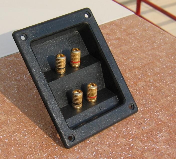

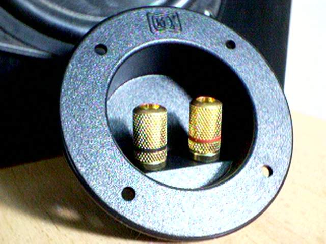

I use binding posts from MX, which come in a round plastic cup. Gold flashed, seem to be of reasonable quality, 50 bucks each.

I found quite a few other connectors which have these properties on the RS site. I'm thinking of using some of the cheaper varieties of these to connect an outboard power transformer to multiple amp chassis. Lowish voltage (+/-50V), high current, low contact impedance, high reliability, no accidental disconnection, and three cores in one plug. Very handy, I thought.
Me too. But normal binding posts either have no locking mechanism (banana plugs) or have locking but can't be easily plugged in or removed (spade connectors fixed by screws). As far as I can make out, Speakons and other similar connectors have the following features:roadkill said:I have a doubt: what are "Neutrik Speakon" connectors used for? I'm guessing for speakers...I use binding posts from MX, which come in a round plastic cup. Gold flashed, seem to be of reasonable quality, 50 bucks each.
- High current rating (16A or more): good enough for speakers
- Very low impedance: less than 100mOhms. Good for low voltage high-current apps
- Locking of some form: no accidental disconnection
- Easy plugging and unplugging without any unscrewing, shorting, etc
- Usually, for 3-pole connectors, the earth connection is made before the other connections, so that you can plug and unplug safely when it's live
- Insulating body (which most banana plugs don't have)

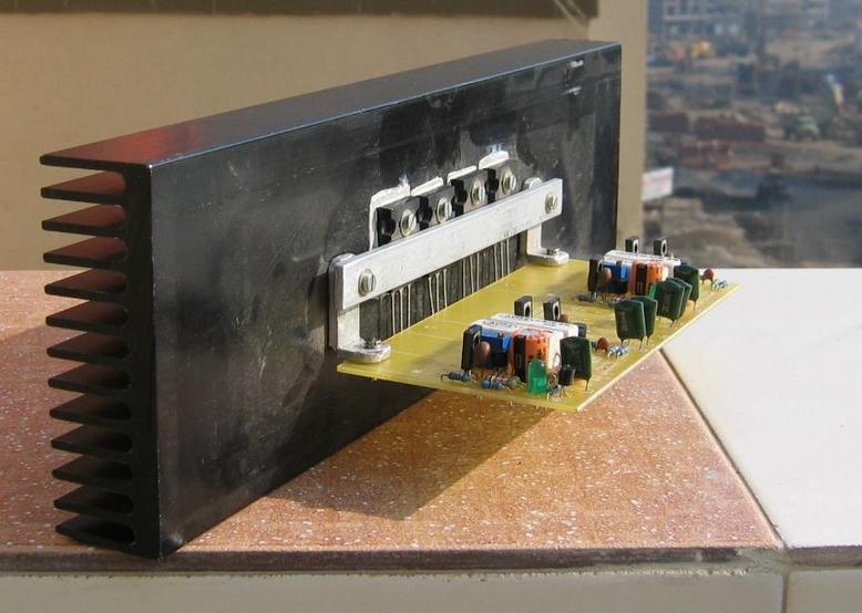

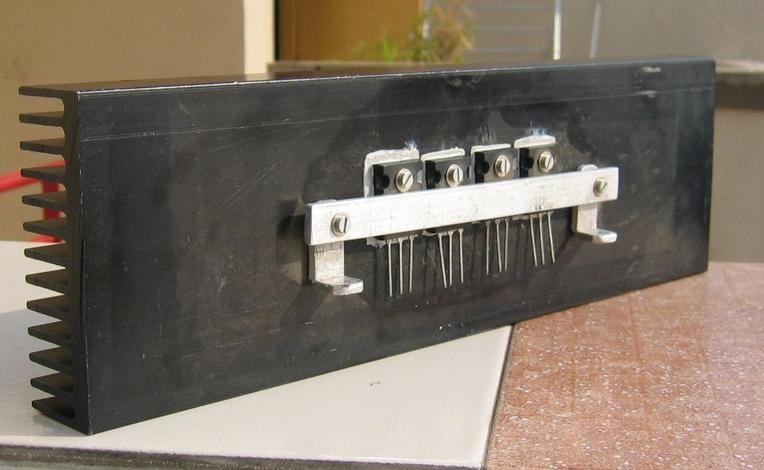

Heatsink with PCB
And this is how the PCB will bolt onto the heatsink. This is the partly populated board for the stereo P3A. I've decided not to populate the last few parts till I solder the hookup wires... it'll be very difficult to maneouvre the hookup wires once the larger components like fuse holders are in place.
I prefer to fix TO247 type transistors, and TO-220-derived ICs (e.g. gainclone chips) with a bar in front, rather than depend on that solitary off-centre bolthole at the top. If you just depend on that one bolt, the bottom portion of the IC/transistor tends to rise a bit, and this sharply reduces heat transfer. This is a lesson faithfully copied from Randy Slone's book.
The aluminium bar I am using cost me Rs.10/foot, from any hardware store which sells Al channels and sections for sliding windows and the like. The bar is about 3.5mm thick, and about half an inch wide. I drilled the holes. I use 3mm bolts. I fix them to the heatsink by drilling and tapping holes in the heatsink.
This heatsink cost me about Rs.550 from Visha. It is sold at a rate per cm running length. You can calculate the rate per cm. The only crib I have against this heatsink is that it's 100mm wide, not the exact 88mm I'd have needed to precisely fit onto a 2U chassis. Ah, well...

Banana sockets in plastic cup from MX
Thought I'd post a picture of this thing, since the camera was there. Just to show you what Rs.125 bought me. One thing missing is the pair of gold-plated brass shorting strips. One strip shorts both the black sockets, the other shorts the red ones. I've removed the strips since I will almost certainly be using the four sockets separately; I intend to use active xo in my speakers.
Tarun
What do the square terminals cost? Do they have a hole to insert bananas and then allow you to tighten the nut? I bought similar ones from Parts Express and Zalytron at about $5 each IIRC.
BTW, there is a week old thread on this forum for a group buy on a gainclone amp at $50 exclusive of tranny, chassis and hardware.
George
George
They have a hole for the banana plug, but no mechanism to tighten the grip on it afterwards. The whole square thing cost me Rs.125; I'd mentioned it earlier, I think.gjo said:What do the square terminals cost? Do they have a hole to insert bananas and then allow you to tighten the nut? I bought similar ones from Parts Express and Zalytron at about $5 each IIRC.
Yes, I saw it. The PCB was designed in a way which I'm not comfortable with. There are no mounting holes. What makes it worse is that the designer has made space for large and (I presume) heavy caps on the board. The entire board is expected to stay suspended in space on just the solder joints of the LM chip. This is very naive. One member has pointed this out, and the designer has added a mounting hole somewhere in the "centre"; I didn't bother to look.BTW, there is a week old thread on this forum for a group buy on a gainclone amp at $50 exclusive of tranny, chassis and hardware.
Personally, after doing some armchair studying of the gainclone chip and circuit, the only way I think such a circuit will be secure and reliable will be if
- the PCB is clamped to the heatsink with two L-brackets of the kind I'm using for my P3A above, and
- a metal bar is clamped across the chip, pressing it down on the heatsink. These chips simply do not press against the heatsink enough if you just use that one bolt on the top, and this fault increases their temperature, and that's when their super-sensitive SPIKE protection kicks in, making the sound audibly worse.
