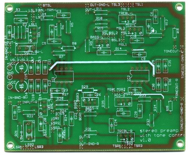

Got my first PCBs made
Got the PCBs for my preamp circuit (which I had discussed in another thread in the Solid State forum). They have been made with the services of Image for the films followed by the fabrication by Mr.Subramaniam's workshop. They're lovely.
I have bought PCBs from Rod Elliott. I can confidently say my preamp PCBs are better than those. For one thing, mine have a solder mask. For another, the tinning seems more even. And I paid Rs.250 for the pair of PCBs. (I have yet to pay for the films... that'll be another Rs.250 or so, I guess. But that's one-time stuff, not incremental.) In fact, even the PCB making costs are not really Rs.125 times two. Mr.Subramaniam's just charged me what he charges for ad hoc small-quantities of prototype PCBs.
The process of fabrication of single-sided PCBs which he uses is quite laborious and goes like this (sorry if I've misunderstood any of it):
One more very interesting thing that I discovered is that one does not need to get films made professionally for each PCB (thus saving money). One can take a printout on polyester sheet and give it to him, one sheet for each image. (For single-sided stuff, he'll need three images: (i) solder side tracks, (ii) solder mask, and (iii) component side legend.) I know I'd reported earlier in this thread that such printouts won't do, but he explained that they'll do, provided I'm willing to write off the printouts after each job, i.e. the printouts wil not be reusable. He explained that he uses some oily compound to make the film stick to the copper-clad board during exposing, to avoid air gaps, and this oily substance spoils the printout. He also said that if I am considering giving him printouts, it's better to print on translucent tracing sheet instead of pure transparent polyester sheet, because the translucent sheet absorbs ink more, and gives a higher contrast image. In fact, it is possible that a good inkjet printer (with 600dpi resolution) will give a deeper, richer film for his purposes than most laser printers.
I'm thrilled to see that I've been able to set in place at least one part of the supply chain for my diy audio activities. PCBs should not be a problem for me now onwards. 😀
And guys, this information is not for Bombayites alone. Mr.Subramaniam and Mr.Desai (of Image) are both very comfortable on the phone and over email, and I am sure they will entertain any orders coming in remotely. Personal visits are not needed. And these two firms work very well with each other, and trust each other's competence.

My first PCB from the Image+Balaji combine
Got my PCBs from the fab. Here is the track side image.
Mr.Subramaniam cribbed when I met him, about the small size of the solder pads. From now on, I'm increasing the sizes in Eagle. You can see how small the sizes are, but you can also see how accurate their fab process is, to get absolutely straight track edges, neat circles for the pads, and in most cases, holes precisely in the centre (done with manual drilling).

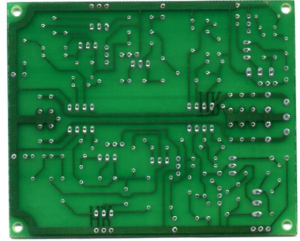

... and the legend-printing
Here is the legend printed side. For this particular PCB, assembly would have been very difficult without legend printing, I feel, because there's a haphazard distribution of all sorts of small resistors and caps, in all sorts of orientations.
