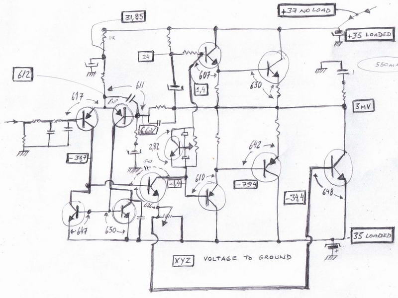

Already received the Sankens from my friend...mail here is wonderfull, and will go to
37 volts, as things are stable there...guaranteed stable using this voltage.
So, forget those dead Sankens...i am making efforce to fogive myself because of that.... stupid i was.
But now, a friend re-arranged the things to me, and another GEM will born next week
This weekend my birthday, so i will be around young girls in the beach and will have fun shopping...and eating as a thin dog!
Next week will have GEM, this time a pretty assemble...decent wiring, as it will be done to stay...from now to ethernity..will go to my son and to my grandson....hehe, near future the amplifier will be inside some watch...and speaker will be electrodes touching skin and transfering direct to brain.
I am afraid my grandson will use the aluminoum block to hold the door openned when we have strong wind days here...very common here strong winds.
Destiny is very bad when we go turning old..hehe...really bad.
Well, more two generations, if my grandson have one enemie... when young, can put the aluminium block inside one football ball...and ask the enemie to give a pretty good kick in that ball...for future they will find use for now a days amplifiers.
I will post some informs, a simple sketch, not pretty, but really informative... big utility to the ones decide to produce this lovely amplifier.

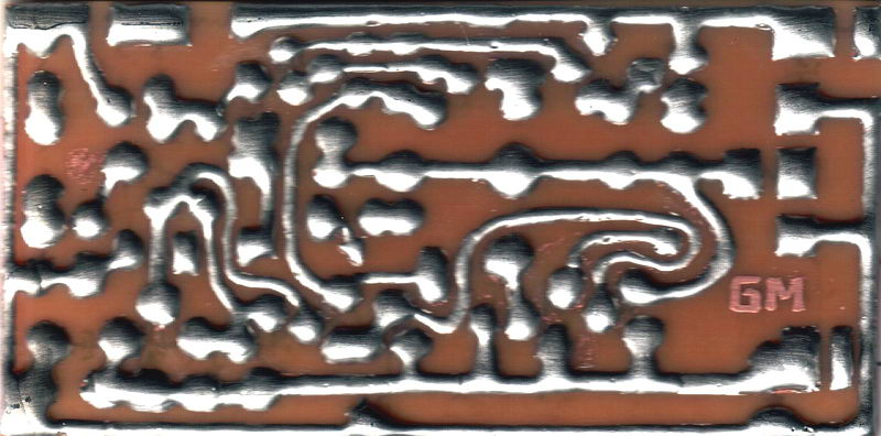

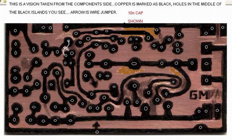

Here is the board ready, in stand by mode, ready to go!
Parts are ready too, all them tested.
So, will construct monday morning.
Will be listening 9 AM, monday, next week
Will have my Birthday watching "60 seconds" movie... "Eleonora" the car, the Mustang...the most wide world pretty automobile.
700 Horsepower and 300 watts of sound in my room...4 AKSAS and one strong Symassym.
regards
Carlos

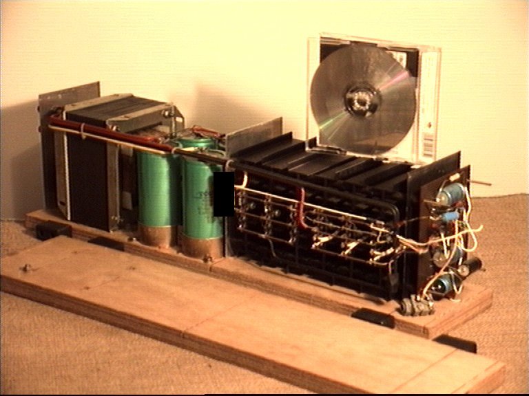

Hi EUVL,
I built a 100W JLH class-A 30 years ago, but it is not bridged.
It is big, and oh-boy does it and the room get hot after a few hours, much hotter than a 100W tube amplifier !
It became a test bed for literally dozens of JLH derivatives.
This is a recent photo, still with some test variations attached.
It is 24 inches (60cms) long. Shown here on its side, with one side removed. The transformer is about 6x6x5 inches. There is a thermal overcurrent cut out on the rear panel; it would pop if you permanently shorted the output wires for more than a few seconds at full output. (Can't even find them these days.)
You can spark its speaker wires noisily together at full input and nothing blows, not even the trip, but that is because it has pure class-A output.
Also, put it beside a 100W class-AB amplifier and it is like having a choirboy beside a rock star; it does not have the dynamics !!!
Pure class-A output current is naturally limited, and it cannot maintain drive through back-EMF induced loudspeaker impedance dips !!!
I had the parts for two, but was so disappointed that the second was never built.
I regard the GEM amplifier as retaining excellent JLH sound quality at normal listening levels, but it is also fully mature and ready to rock, as I am sure Carlos will confirm.
I also expect this circuit to simulate reasonably well on computers other than mine.
My finished monoblocks will use 2SC5200 where 2SC3281 are indicated.
Cheers ........ Graham.

Moray, already done my way, but not sure if you will consider that a board schematic.
I usually assemble over copper lines, but you can understand the view i attached, as something made over a transparent board, there's the copper lines, and you can make the usual holes and assemble over there as more normal assemble method.
Also i posted a image of the parts over the board to turn easy the construction...by the way, i can understand, in advance of your comments, that someone that use to assemble over traditional computer designed boards can feel unconfortable with my boards, and may loose more time trying to understand "another point of view" than construct your own board.
So, if you want to contribute, usind CAD and create a board for us, will be very well received with many thanks.
