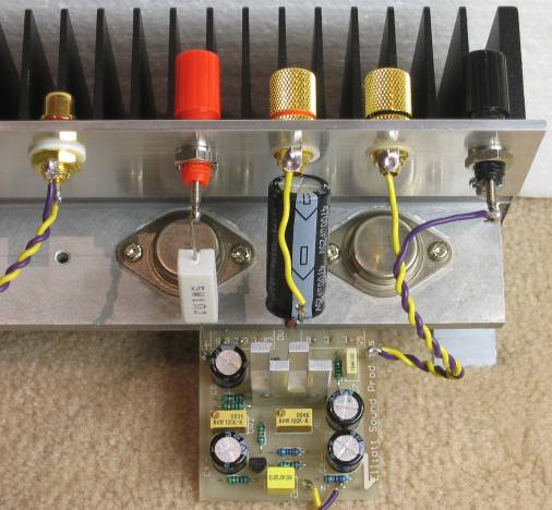

I have just finished my brand new GEM, and listening good music rigth now!
Had not problems with the construction, voltages are normal, off set appear a little bit bigger than the last one...11 milivolts, but everything in order...was assemble and power was switched on without any surprise...current measured over protective resistor that were removed and substituted by rail fuses.
I was afraid of the bias adjustment trimpot, so i installed a 110 ohms resistor...and ready to go!
100 ohms trimpot is in the maximum...good current in the extra NPN, having something around 250mA....and 620 mA each rail.
It is producing more than 100 watts RMS over 4 ohms...but this is not important, as that difference is nothing to human hearing, as 10 or 20 percent increase is not perceived.
NO CAPS!...any cap, no Miller....and reduced to 22pf the input units, 10 pF the feedback line and 220 pf the feedback transistor base to emitter connection.
My rails condensers are 470uf each one... cable from PSU have 25 centimeters long only.... all condenser bypassed with 100N
From feedback line to ground; 39 ohms and 3300 uF
Bootstrap is using the correct value, and to positive line decoupling filter,in the input, was maintained the 220uf.
My zobel is using 2,2 ohms.
BC556C gain is 310
Voltage amplifier gain is 100
Driver gain is 85
New Sankens, 90 the NPN and 105 the PNP

You only have 250mA in the class-A, but you still should not have 650-250=400mA in the class-AB. Just go for 100mA class-AB.
I'm sure you always double check when hot; if I set for 500mA total when hot, the cold switch-on current is only 350mA, but the amplifier soon stabilises and still runs well the moment it is powered-up.
NO CAPS ! Excellent.
That means you have got rid of the stray capacitance you had before. Having tightly twisted wires running between pcb and the output stage transistors can do this, and I suspect the lack of basic stability you had before played a part in the failure when you increased the gain-bandwidth of the output stage devices by increasing the supply rail voltages. (You can always bridge for increased power.)
I note that some JLH class-A constructors twist the wires going to the output devices, but that is *not* correct; I also note that some JLH constructors complain of instability problems where there should not be any. I have made capacitors by twisting wires together in order to obtain some particular response at RF, but it is very hard to predict what the resultant value will be. Thus I wonder how amplifier constructors know what additional cross-couplings they are creating when they twist wires.
The stability without additional signal path capacitors is also most satisfying for me too, because it means that the circuit is properly repeatable, whilst for those who do experience a problem, you have already proved that a simple 47pF Miller capacitor at the VAS is an effective cure.

Wire capacitance. I have only one critical wire between my pcb and the heatsink, a short fine one between the mirror and the VAS.
All others are neatly hardwired on the heatsink.

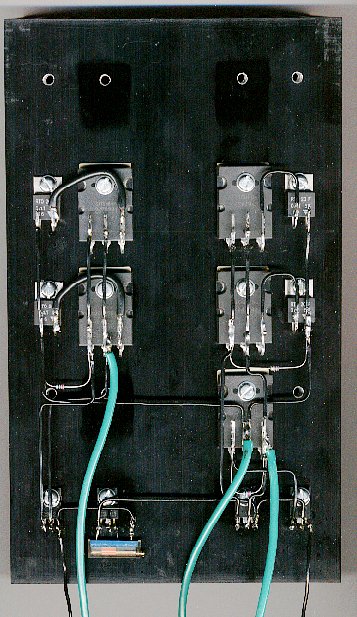

I have pulled the prototype heatsink off my amplifier and scanned it to show how neat and easy it can be for all those who ensist upon risking oscillation by mounting anything after the first four transistors on the pcb, or running all wires back to the pcb.
Note that I have a 22 ohm resistor where the class-A bias pot should be. This turned out to be exactly the correct value with my transistor, the 390/820 ohm VAS collector resistors, and the +/-36V rails, so it was substituted.
My wires and solder joints are still not what I would make for a finished product (this heatsink has carried many protypes and my iron was too cold).
Note that I use thick film emitter resistors, whilst back on the pcb I use old non-inductive 4x 10 ohm carbons for the Zobel.
The thin bottom left wire goes to the bootstrapped supply, and the thin bottom right wire is from the input stage, both on the pcb but separated from input transistors by the additional supply rail filter capacitors.
The thick wires go back to pcb as L=+ve; C=output; R=-ve.
The power transistors are 2x NPN to the left and 2x PNP plus lower NPN to the right.
This is so much easier to construct, and will be easier for me to modify, or repair in the event of failure.
Why complicate when the most basic option is the best ?
Uncle Graham advises you that your circuit might oscillate if constructed differently to the manner already specified, and if it does you will need to experiment by fitting Miller 'C' etc.
Cheers .............. Graham.
