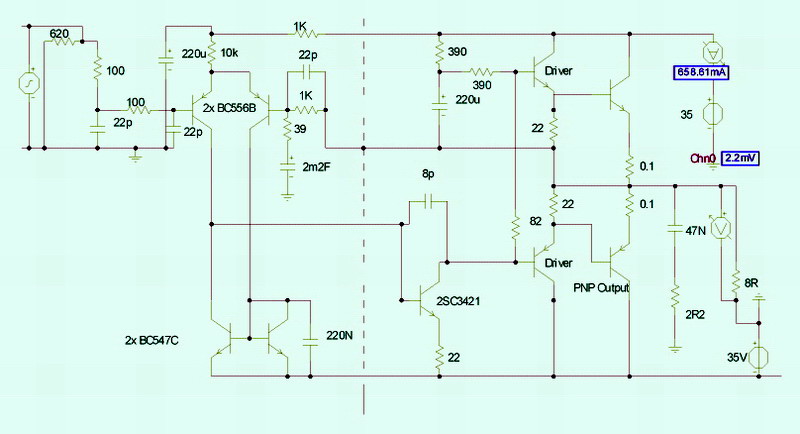

Well, made with short wires and worked fine.
Till i decided to reduce a little the bias, and adjusting i turn trimpot to the other side.... Plaft!...gone the extra transistor, the extra NPN, the control transistor.
I advance too much it's VBE, and that one, beeing a fake TIP35, could not accept 15 amperes...gone!
So, having not the same stile transistor, only TO-3, i decided to make changes, to see how tollerant this schematic will be to modification.
I changed the bias current, the bootstrap condenser, removed the bias adjustment trimpot and auxiliary bias transistor...the VBE multiplier....hummm, very sophisticated name to a variable resistor, and put it into work again, now around 700 miliamps when hot.
Sounded very good..i am hearing it now, will go observing the differences .... first hearing told me nothing different related the GEM, non modified, amplifier.
Of course will be different, but i will need some time to find those differences.
Oh, i was forgetting, the input transistors were substituted by BF422 and BF423.
regards,
Carlos

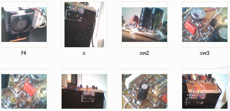

This is the "non aproved" amplifier, the modificated one.
Graham will be shocked with the wires length....
Oh dear Carlos, can't you see capacitance there?
- Yes Graham, i can see, will use some "L" shape aluminium, to bring transistors more close to the board, this way, wiring will reduce from 50 milimeters length into 15 milimeters length.
- He disappeared...so shocked he is.
Some images of the non aproved unit will be posted hear..even non aproved, can kick many amplifiers with pretty Industry Brand names on it..without any effort!
This one is something to construct to hear...but be prepared with 10 to 50 pf capacitor to put as Miller, over the voltage amplifier, as i made three constuctions, and this one needed the Miller.
The first and second constructions, did not need the Miller unit..i turn crazy with those things, the first one, had 25 centimeters of twisted wires...and nothing oscilated, and used a very sensitive transistor as Voltage amplifier.
Well guys, I have a long way to go..have many things to learn and understand...and this is GREAT!
regards,
Carlos

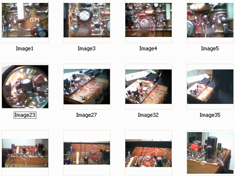

Because appearance, because fail somewhere in audio reproduction, the normal decision
Is comdemned the unit to death or dismount (better because of Sankens).
But the pictures cannot show you the sonic results.... but i can tell you some idea...It is a big Power DOZ, with wonderfull bass response...and off course, better dinamics and higher speed...even defective in audio focusing. (This unit guys, not the Graham design)

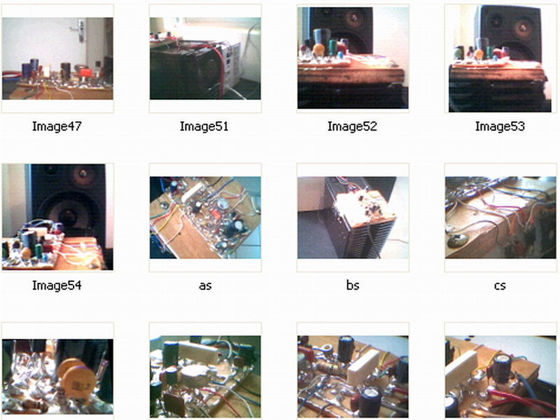

More images.
regards,
Carlos
Hi Carlos,
I'm doing some catching up here. Post#144.
Great to see you trying slightly different circuitry, though I would never experiment without resistors in the psu rails to limit current long enough for the fuse to blow.
Don't forget that it is the series bootstraped resistors that set the VAS/splitter collector current, and so any changing of the values here will also change the Vbe for the class-A output transistor. If you changed from 390+820 to 390+390 then you increased driver current from approx 28mA to 43mA; so the class-A bias resistor would have needed to be adjusted down by 35% (approx 22 to 15 ohms) prior to power-up - or - Plaft!
The Vbe multiplier invertedly amplifies the temperature induced bias voltage change across itself to match that of the output transistors it feeds. When mounted on the heatsink this allows its generated bias voltage supply to compensate for increased current draw by hot class-AB power transistors.
I don't think the 22pFs at the input would be big enough to filter digital/RF noise. I used 220pFs and assumed cable capacitance with a proper pre-amp/audio/portable CD source. Capacitors at the differential input don't just filter source input but can affect how the NFB loop is able to control high audio frequency resolution.
I'm now up to downloading your mini-pics from post 148 onwards, and will come back shortly.
Gee. Look what happens when you send Carlos a circuit.
He studies it from every angle, including inside-out, which as you say Stocker, is to everyone's benefit - including mine - which is why I send them !
Cheers ........ Graham.

Hi Carlos,
Shocked ? Not at all.
In fact I applaud you for trying it like this.
You can change anything to try out an idea, or go through a whole range of component values and different types to see which 'sounds' best.
This way teaches so much, but then if someone builds it differently to yours, it might perform differently !
Okay, so it needed a Miller C.dom.
Much better knowing you could do that, than not have anything working at all.
One of the reasons I don't like Miller C.doms with class-AB is because their hf current draw from the input stage is non-linear at the point where there is a sudden collector voltage swing through the class-AB voltage bias range that becomes necessary when the output current is phase shifted by a real loudspeaker.
There is a narrow range of circuit related values at which the C.dom can have a beneficial effect, but beyond that it starts to affect hf audio.
The capacitor should also be very high quality; ie. not ceramic.
Good to see your progress and I would be very pleased to read your final conclusions from this work in progress.
I have not had a chance to try anything more with mine since I drew out the circuit. Maybe soon.
That test CD is not from vinyl. There are some genuinely low frequencies on it, but sometimes the Analogue>Digital process also induces sub audio error and this gets coded onto some tracks.
Most 'normal' systems are completely deaf at these frequencies though !

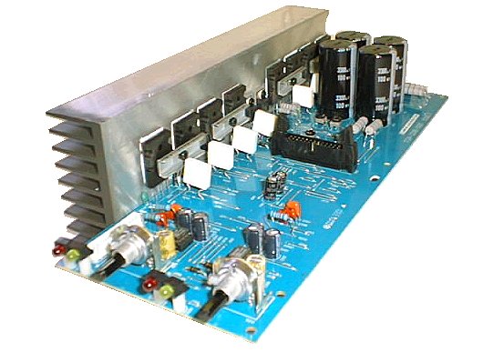

Kanwar, observing the assemble, i had the idea that it is using long jumpers, and it
is possible, that some of them have audio signal passing...so... long lengths or wire, even beeing dangerous to produce parasitic oscilations, are used and can work fine in many amplifiers.
I could see some Panasonic Systems, using 2 inches long jumpers connected to power amplifier input.
If you can inform this unit construction details, to confirm or dennie my argument...please, use this space, our forum.
That's the reason why Kanwar.
