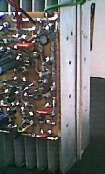

Greg, here is the Cygnus, the leach amplifier brazilian copy.
A simplified schematic...one model use TIP41 and TIP42 as drivers... a very low frequency unit.... i think 3 db roll of may be around 3 Megahertz of something around this limit.
It is beeing used to Public Adress now a days...and also may units are inside enormous trucks, the Electrical trios, with people dancing over the truck's ceiling and all instruments there....a refrigerated inside,with double power generators and many PA units, surrounded with hundred of enormous speakers, exponential baffles, use to make our carnival parties, and some out of date carnival parties too...travelling whole country, during the year.
And there is Cygnus...pumping air like a hell...producing pressure in my abdomen... and hitting "down countries too".... your arm hairs start to move...and you cannot avoid to protect years...as 20 or 30 kilowatts are not uncommon.

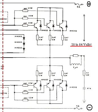

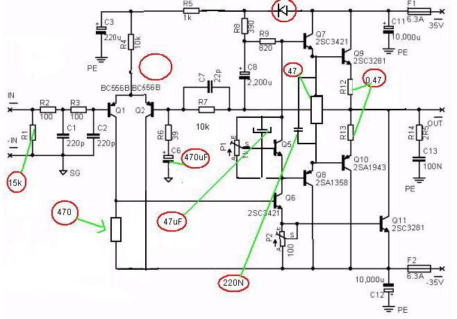

Hey guys!...One Aksa fanatic sent me this schematic
He asked not to identify him...he is shy.
Of course, his changes suggested in text, will make the amplifier alike Aksa..... of course, this guy is an Aksa fanatic..he use AKSA T Shirt and already travelled to Australia to have a picture together Hugh....poor Hugh, may felt embarrassed with that.
Here is the schematic, sorry Greg, i use your schematic to put modifications over it, because your schematic is very pretty.

Hi Carlos,
Yes I was laughing exactly where you said I would be.

Hi Carlos,
I need to get back here quickly.
That circuit in Post#57 could blow someone's bass cone out or smash its voice coil.
There is no start-up bias to Q6/Q8/Q10/Q11.
Q7 and Q8 will generate a monstrous power-up thump.
The 470 ohm Q6 base resistor will need 2.3mA, thus C3 will need to charge to 23V before bias stability can be established (too late speaker trash)
The +ve rail diode will ruin class-A bias control; ie. 390 ohm for bootstrap pulldown, but 1390 ohm for release.
The cross-coupled 47R/220n will also affect class-A biased control because Q7+Q9 work with Q11 in class-A, and Q7+Q9 with Q8+Q10 in AB.
There is very also high gain with poor bass because R6 has not been reduced to 390.
but hey, don't let me stop you having fun !
Cheers .......... Graham.

I love those things, and the man sent me his picture, with Aksa T shirt....ahahahaha!
I never known that Aksa has a brand printed on T shirts...hehe, will ask one for me, i am a customer... my money gone to Australia, and has it value returned in sound pleasure, each dollar already return.
Hello Hugh!...i think a T Shirt, Hiper, Extra, Super large, Heavy Duty may fit...remember...190 centimeters and 340 pounds heavy.... a musculous man!...ahahahaha!
live is wonderfull, in special when people try to modify schematics.
there's one component in 55 Aksa.... that one, if you remove....pluft!... half the quality goes!
So, not a good idea change designs....i will fix my wiring Graham, but will make in the rigth channel amplifier, this one will stay the way it is... will close inside a wood cabinet, with holes to air flow, fan and cables and finished....because i will not hear it's beauty..will hear it's sound.
Thank's all the informs, the US fanatic Connor guy will read that.
regards,
Carlos
