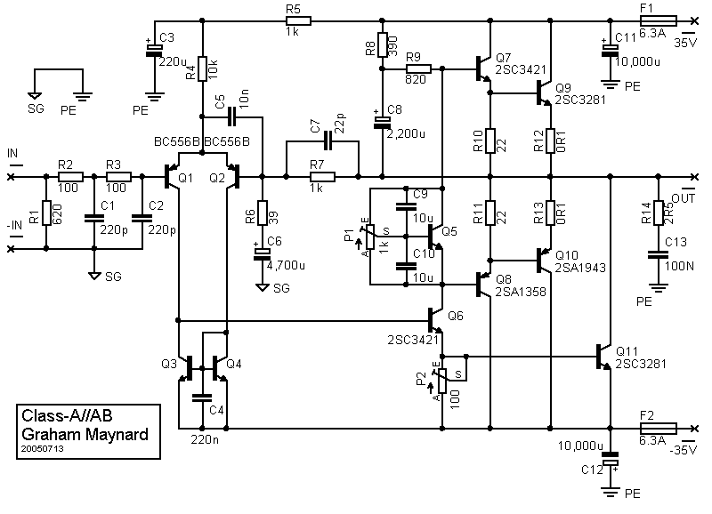

Graham, I have a schematic over GM.25-8, what became of it? The amp Carlos now has built
is very similar.
The design sure looks interesting and getting a pcb may be harder than expected because the circuits are a bit "nested", right? Not from one end to the other. It will be interesting to see where this design take us.Graham Maynard said:I now see that you bring all wires to the pcb - this might be the cause of your oscillation.
Hi peranders,
The 25W-8 was not powerful enough. This is.
It might look a bit nested but as Carlos said it can be opened out to look more conventional.
With all the drivers and power transistors on the heatsink it becomes very easy to wire up.

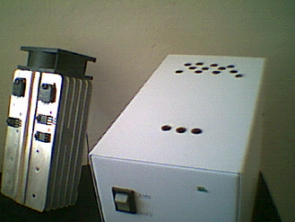

I spent a long time twisting wires, my slow speed drill is damaged, was a hand work
Also i had to fix transistos, and in this case, i had to produce some insulations too.
I was very surprised that did not take too much time to finish, adjustment was fast and easy, but some care must be taken related the bias adjustment, as trimpot has not limiting resistor to avoid excess of current. When you advance control too much..current can go to 10 amps fast!... but this can be done without problem, with the inclusion of a single resistor.
I continue to listen at it with pleasure, and now it is plugged in my DVD, Pearl Harbour Movie is shaking all home glasses...this amplifier go to very deep bass reproduction, and quality is very good. When the bomb penetrated the ship floor, crossing many stages and stopping in the ship's kitchen.... you can perceive, with details, the bombs delay helical mechanics spining... all voice wonderfull, but not too much emphasized in "S" letters, also rain is rain, and claps are claps, bells sounds as bells too.
As all of you know, it is hard to perceive clapping different from rain, and without a helping image to inform you, some doubts can ocurr, as very few amplifiers can inform that to your brain....well, having that "resolution", we can say that the amplifier is fine.
Related the amplifiers published, of course related the ones i could have or construct, as i can remember, only Graham 25W, Aksa55, Symassym from MikeB and this one....Oh!, the first JLH design have to be included, naturally.
I have here one class D also...but rain are claps and claps are rain...i could not perceive difference, also Sound stage is negative...all sound appear having no deepth, separation is good and dinamics too.

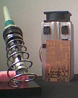

This time i will get him..... i found some "unstable" schematic to give a 12 bore or 12 gauge, double barrel shot!!!....ahahahaha!
The circuit is hot as a hell...this way i will use small heatsink!
To avoid guys discover that i am "preparing the results" i will put a fan over it.
To the output TIP35 will be used
To drivers will use reasonable pair...not so good 2SB1566 and 2SD2395
To Voltage amplifier, the good 2SC4793 (ahahahha!...low gain!!!)
And to differential..... BC556C and BC547C
The circuit has not Miller compensation capacitor...he is a destructor, and also a wonderfull thing when guys know how to use it, as need special material and deep tuning.... changing from 2 to 2 picofarads, the value, hearing sibilants sounds.... a kick in the bull!

Graham Maynard said:If you lived near Mauro
'Mauro' num pais tropical.
Mmm, Carlos, shouldnt the heatsink fins point the other way around 😀
Hi Jacco, now is Jorge Ben Jor, because of numerologist advise him to change name
To have more success, the old guys (more than 70!) with genuine black hairs (still natural black) tried to change his name.
Result that he disappeared in limbus...maybe dragged by an Universe Black hole, or travelling with grass to Sdrovosvária!
hehe, really...not a good position, but the reason why is that my design department decides to put that thing horizontally inside an enclosure, having another one exaut fan...this is breathing air througth the fins...hehe...will melt everything!...will be Graham fault..... terrible i am!

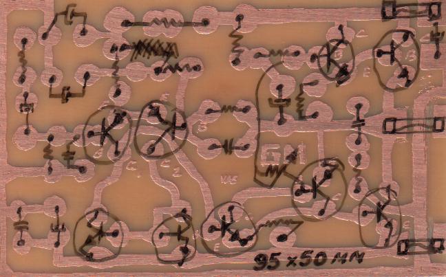

Parts shown over the board.
As i already explained, i use to solder over copper, but you can adapt this to create the standard board, the one with holes.
I forgot the bias trimpot, it was missed in the board and i draw the connections....put some aerial trimpot, make your adjustment...wait amplifier to reach good temperature and adjust it again.
Now remove trimpot, measure its resistance and replace it with a fixed resistor, if not exact value, use lower value than the one you measured, to reduce bias, in place of increase it.
The bias is a little high, this represents enormous heat....79 watts of heat is difficult to manage...so, some reduce may be better to control heat, and will be worst to amplifier audio reproduction....well, there are sittuations that you have to make some choice, depending the heatsinks and fan you have.

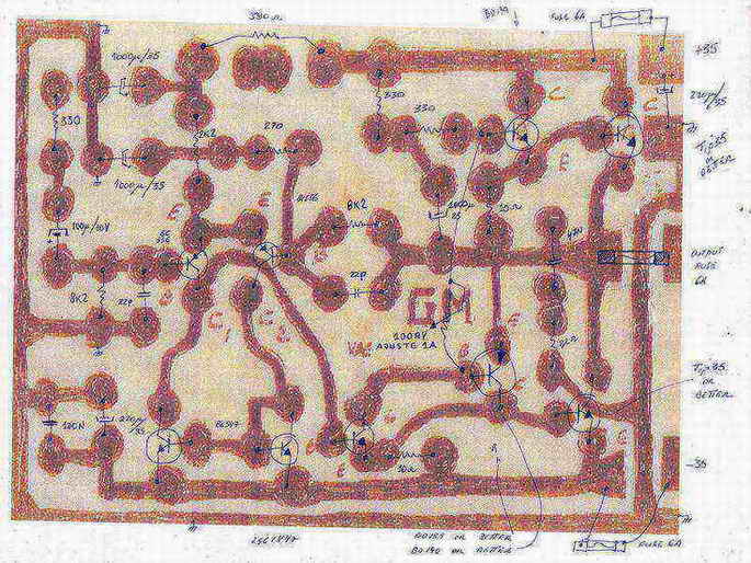

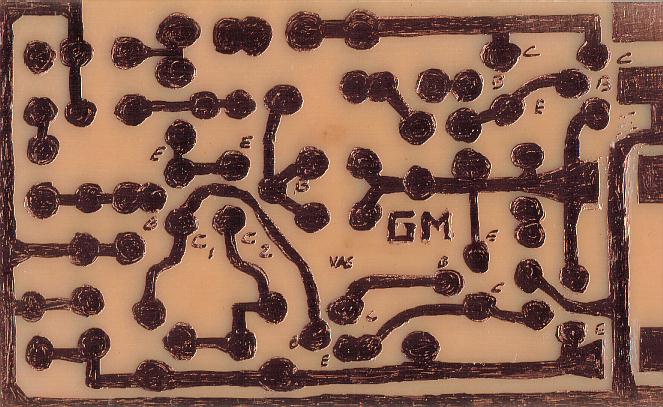

Here is the board, notice that bias trimpot was missed related to copper lines
So, this trimpot must be installed some way to adjust.
After that you can replace it by a fixed resistor, this trimpot is 100 ohms unit.
I will assemble and test tomorrow morning, lasting some time to Graham evaluate boards and decisions i took.

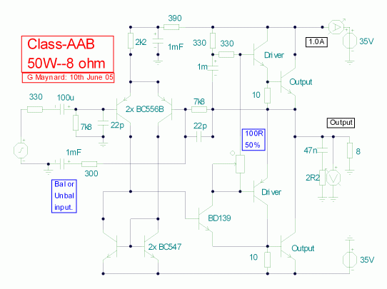

Hi Carlos,
I check my e-mail fot the 10th June circuit - it said 'stabilisation not determined', so I hope you do not end up 'destroying something.
I did have that one running but it was an intermediate circuit, and thus would be a backwards step from the 8th Jult one.
Try 2k2 in series with VAS base.
Cheers ........... Graham.

I was having a look at the schematics of Graham's amp in posts #3, #4 and #5 and thought I do another to help me understand the circuit and give me a little practice using a schematic editor. 😉
Anyway, I think it turned out pretty clear and I thought it may be of help to someone else.
I used Carlos's version of the schematic (single output devices) and Graham's component selection. If someone sees an error please let me know.

The last amplifier, a Graham diagram that was in development, not finished.
I decided to construct, but Graham told that was just one experience, one step into Diamond creation, and that had some adjustments to be made.
I did those adjustments, but really....aaaagh!...the amplifier has nothing to compare with diamond...i promiss to give a shot in every sh-- amplifier that i assemble, my dirty revenge, but as Graham is a very good friend, i will dismount board and construct there another P3A ( as i already made one once)....and probably will shot P3A circuit...because Rodd is not a close friend, and Graham is a close friend, so, if i dislike some board...hehe, better to be Rodd's circuit assembled there, than Graham circuit assembled over.
I made the circuit, the second one published, but really not finished as Graham told..... he told that i will go backwards, alike crab walking backwards......and crab remember me a good name to this amplifier...crab!...crab!...crab!.......ahahahha!
Please, DO NOT assemble that one, go to the first one, the finished and tested Diamond, a genuine product from the King of UK!
God bless my Kings!.... long life to the Kings!
I will show you some pictures of the crab..... it works...but is normal and standard, having nothing of special, alike thousands of amplifier you can find in web..... another grain of sand, very alike other grains of sand.
regards,
Carlos
regards,
Carlos
