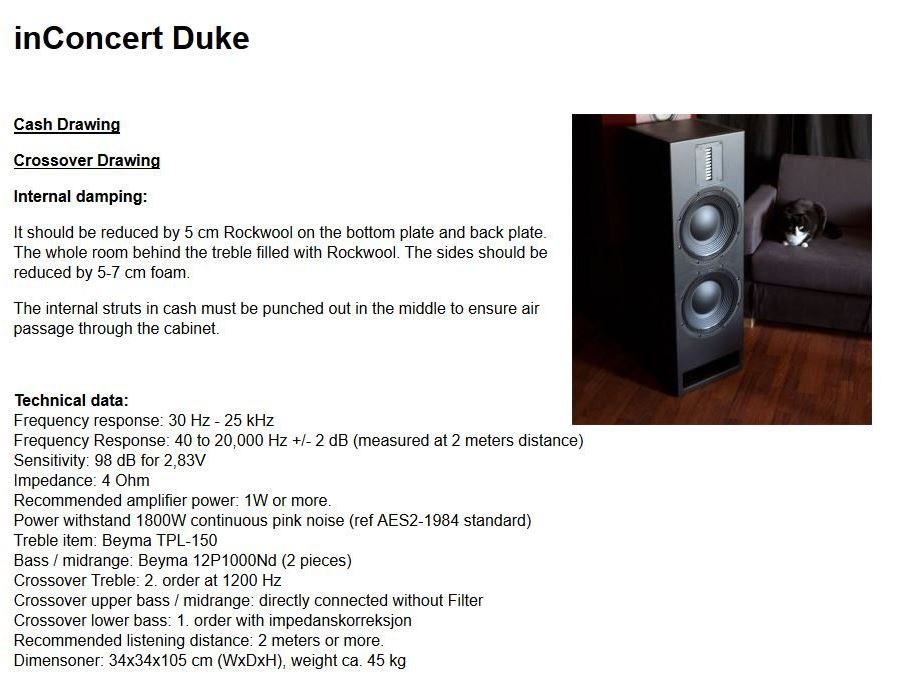

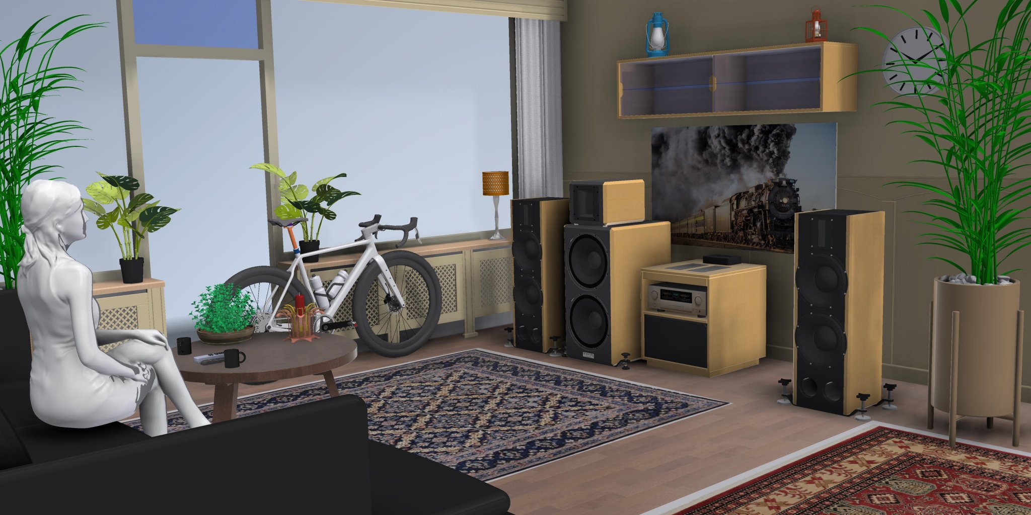

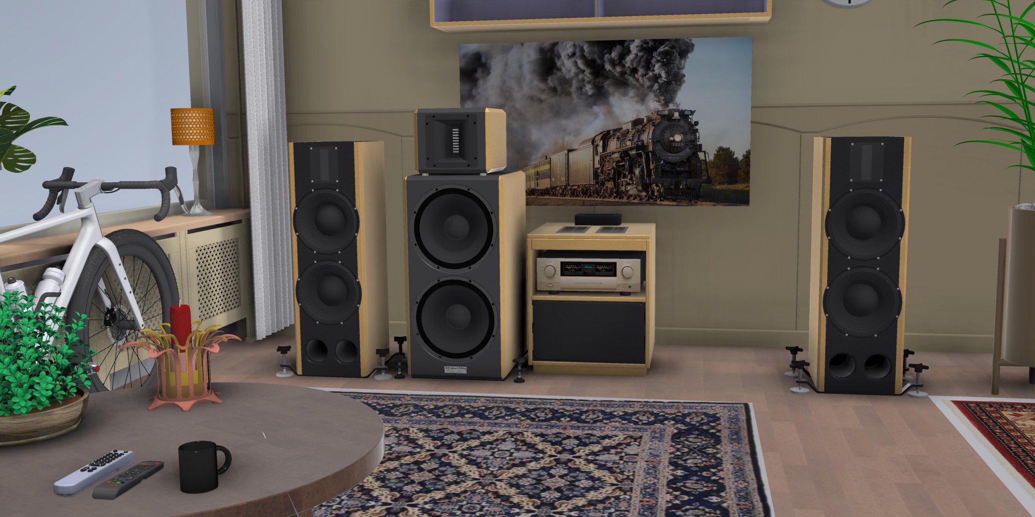

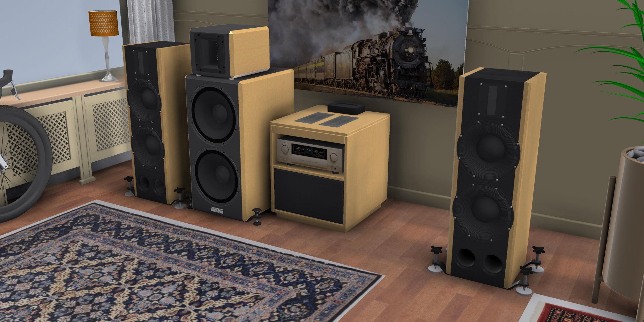

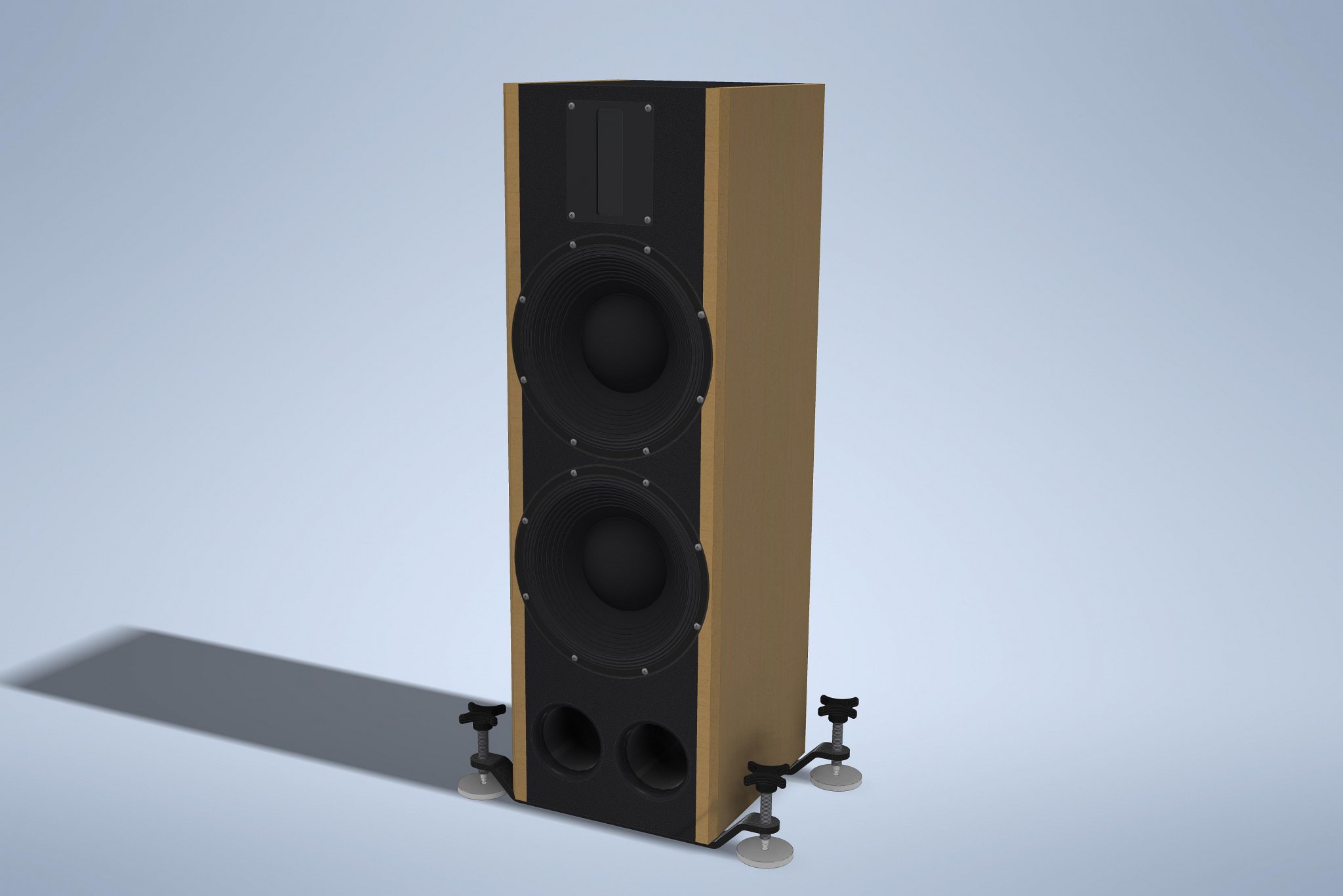

Or I like to build his a little brother, the InConcert Duke.
But the InConcert Miles are absolutely the most powerful and best speakers I've ever built.
