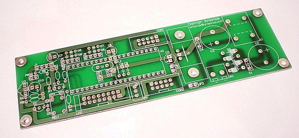

Hi Georgio,
I will reply later in more detail to your post, however, I could not resist commenting right now on the quote below:
Thanks for an interesting link. The article didn't mention anything about affecting sound quality, it only comments on source's performance, which is not neccessarily the same:
"Another problem with this technique is that a shunted pot presents a varying impedance to the source as you turn the knob. A pot without a shunt resistor presents a constant impedance to the source, so the source's performance doesn't change as you turn the knob."
So, success with implementing such attenuator will depend on the source itself, but with well designed outputs, it shouldn't present major problems. My source has high current drive capability with 6 ohm output resistance.
I'm using series 10k resistor at the amp's input (fixed) so input impedance never goes below that value. I don't need wide range of volume setting for normal listening, and so far, I only needed shunt resistors values between 402R and 3.48K. That varies input resistance between 10402R and 13480R. I don't think it affect any performance. 😉
I would not recommend linear pot for such application: only a switch with discreet resistors.
After saying that, the attenuator board I'm working on, has constant input impedance that does not change through all 130 steps.

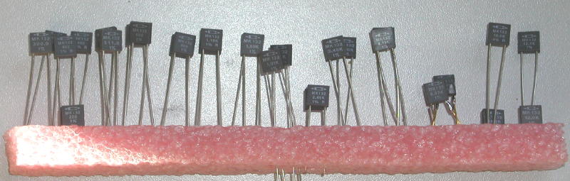

Regarding 22,000uF caps I have some Siemens Sikorel, but those would be quite expensive. Another good brand could be Nichicon Super Through from Percy Audio.
The attenuator still needs programming to be done. The resistors I like here, are nude Vishays from Texas Components in series position, and with GC amps, Caddocks MK132 in shunt position.

Thanks for appreciating my products 😉
I will have more Aleph30 boards next week, as I ordered new batch. I also have one more set of output mosfets left.

I need to ask Veteran about progress, as he was developing software. The boards layout is completed, the only option might be different resistor choices.
On a control board therte is an option for source selector.
