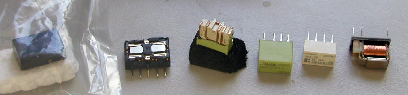

Choice of relay?
Hello Peter! I've been calculating (vs building !) on resistor attenuators for some time. One of my dilemmas is over the relative merits of a single series with multiple shunt resistors (one for each position), and whether multiple connections/contacts in the signal path are audibly detrimental.
I gather from your posting that the shunt portion of the attenuator can/will also affect the resulting sound, correct? Based on your listening, is the audible effect of a resistor the same in either shunt or series usage?
Do you have any opinion regarding the effect (if any) of multiple relay contacts in the signal path?
Is there a particular relay type/model which you have found to be preferable and/or have included in your PCB layout?
Lastly, I'm assuming that there is no relay coil drive circuitry on your board, true?
Looks like a great project! Thanks! - Ted

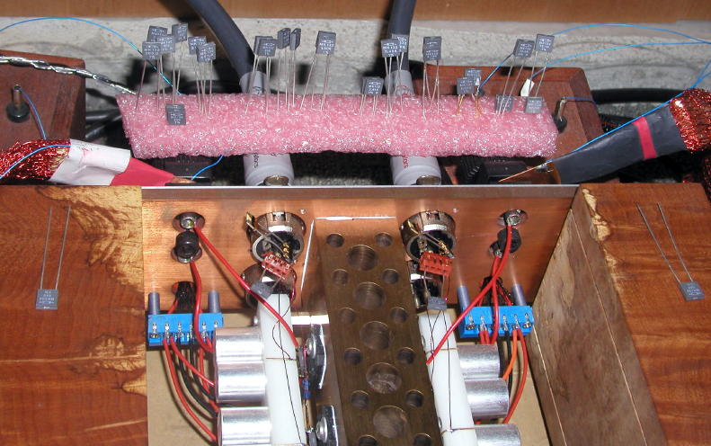

I'm presentyl have such setup as well, although it is rather temporary. I don't have a switch for shunt adjustement, a simple socket where I insert resistors is used instead. So far I only needed 4 resistor to adjust gain comfortably ( for 10k series they were between 866R and 2k5 in parallel with 22k permanent resistor at amps input). I can replace resistors on a fly, without switching amp off, and kinda like that arrangement😉

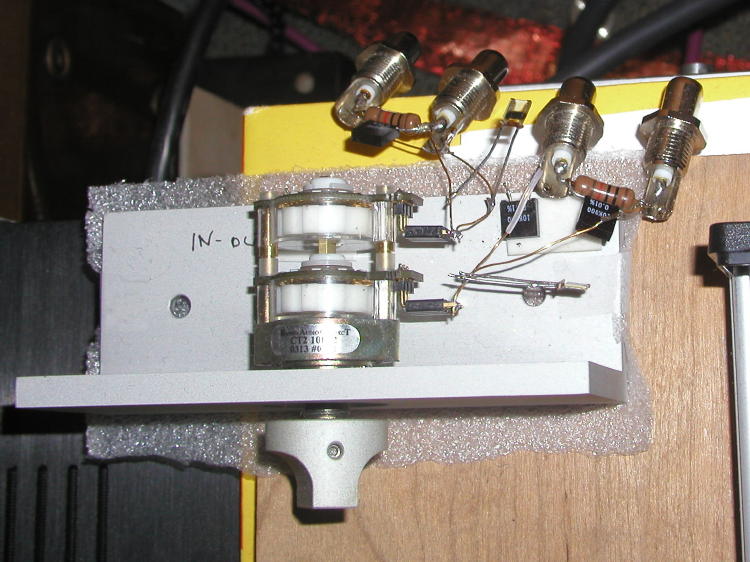

I found out how improtant is the proper choice of resistors in building top notch attenuator by my first approach to improve on Placette. I used a fixed series Caddosck TF020 and DACT switch for shunt adjustement. That could have seem like seemingly better approach, as series element was fixed and didn't change (no switching in direct signal path), however, that circuit did not compare to Placette that was actually much preferred. I later changed series resistor for a Vishay, but still, it didn't improve things much. I can only presume that DACT was there to blame. 😉

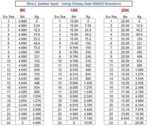

When comparing shunt and true ladder attenuators, one can notice that the shunt attenuator moves away from constant impedance only at certain volume settings, setings which usually are not being used anyway (with reasonable error margin of course).
Below is the table posted on DACT site for true ladder attnuator resistor values. Let's have a look at 10K attenuator. As we can see, the series resistor value starts to change significanlty with pos 19 (where the difference is more than 20% for -12db setting).
In my particular setup, I never set the volume higher than -12dB position, with -16dB being usual loud setting.
Now, why on Earth, should I go with true ladder arrangement, employing 15 almost same value resistors (at $10 ea.) and adding a series switch? I couldn't care less if total impedance is 10k or 12.5k.
How can it be simpler, not to mention sounding better?
