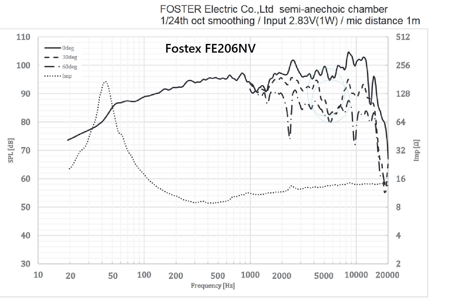

on the small side - and with your subwoofers - perhaps Fostex FE206NV (or previous EN)
