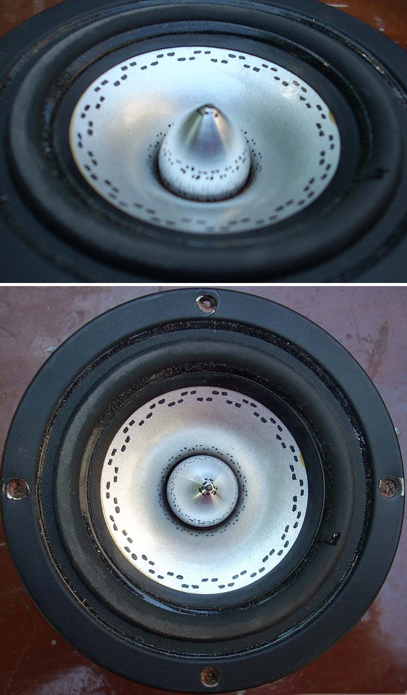

@Pierrick59 here:
My latest fullrange is behind that cloth. Its Phillips

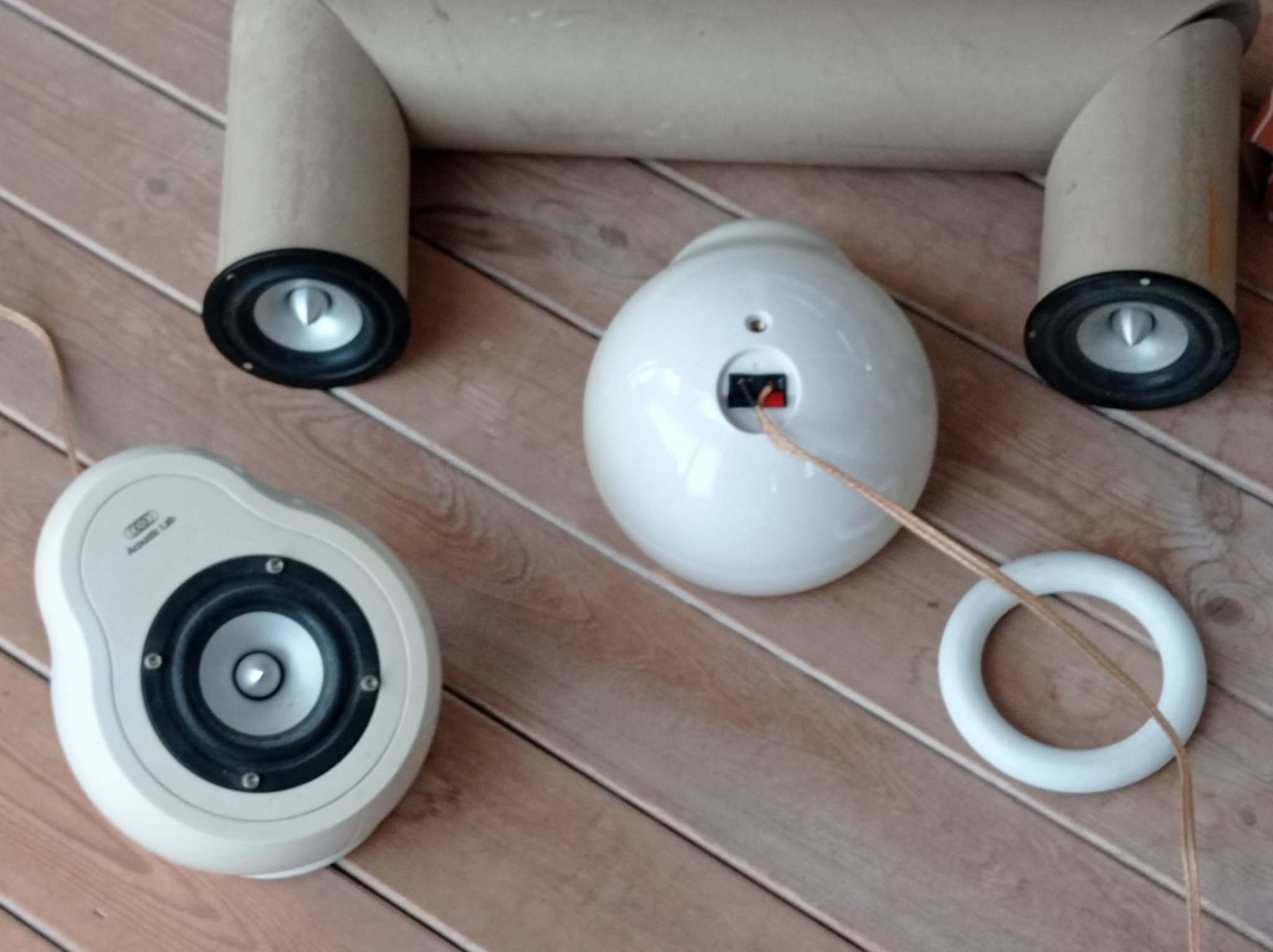

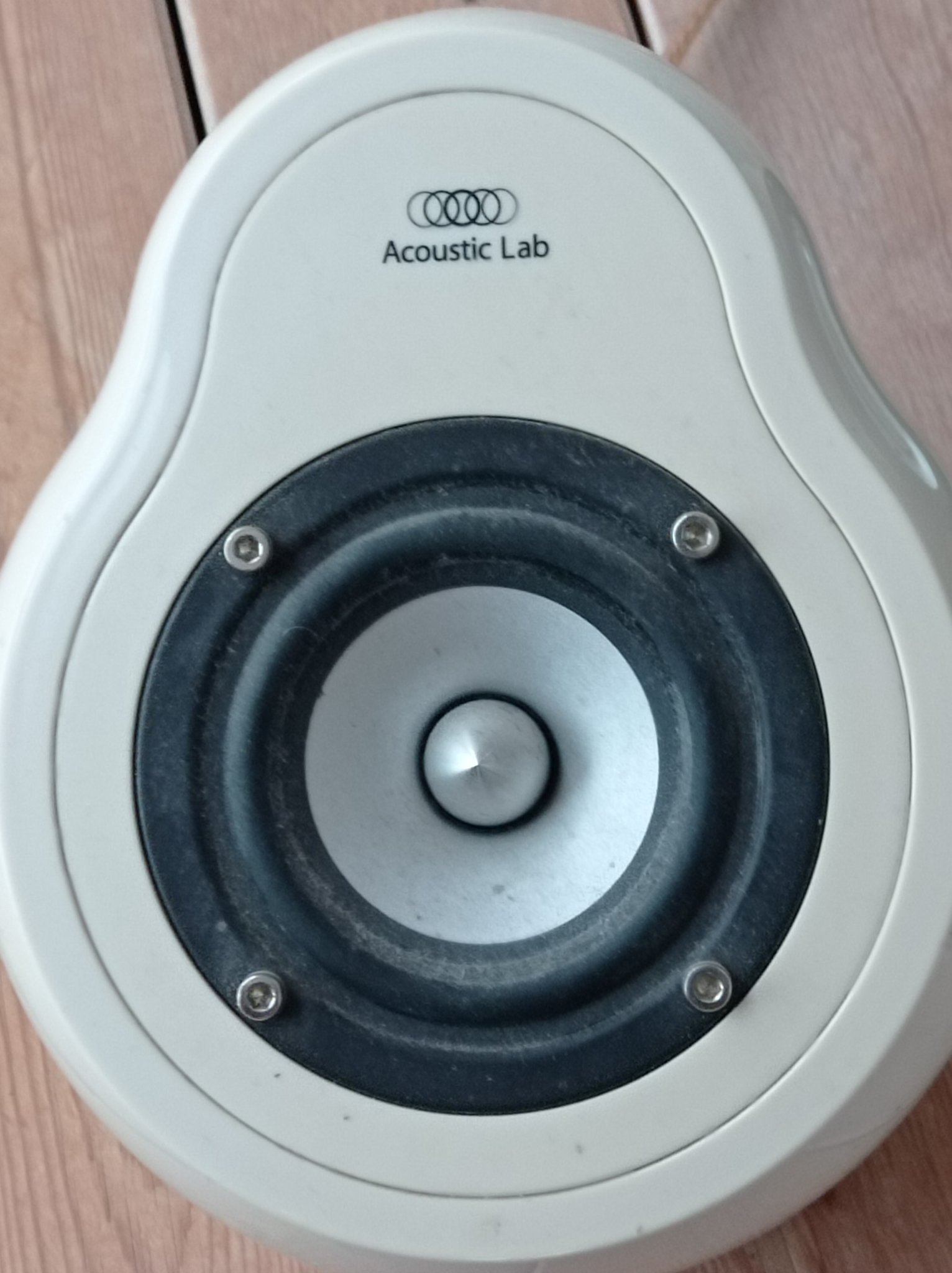

Here are my pc speakers: their identical drivers, and my future dashboard speaker for my Colt. I dont know if I will turn them aperiodic vented or use one or more of the many passive drivers I just got from AliExpress.

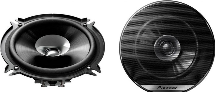

With cfa amplifier and little bit eq a Pioneer t-sg1310f sounds pretty high end due to good cone material

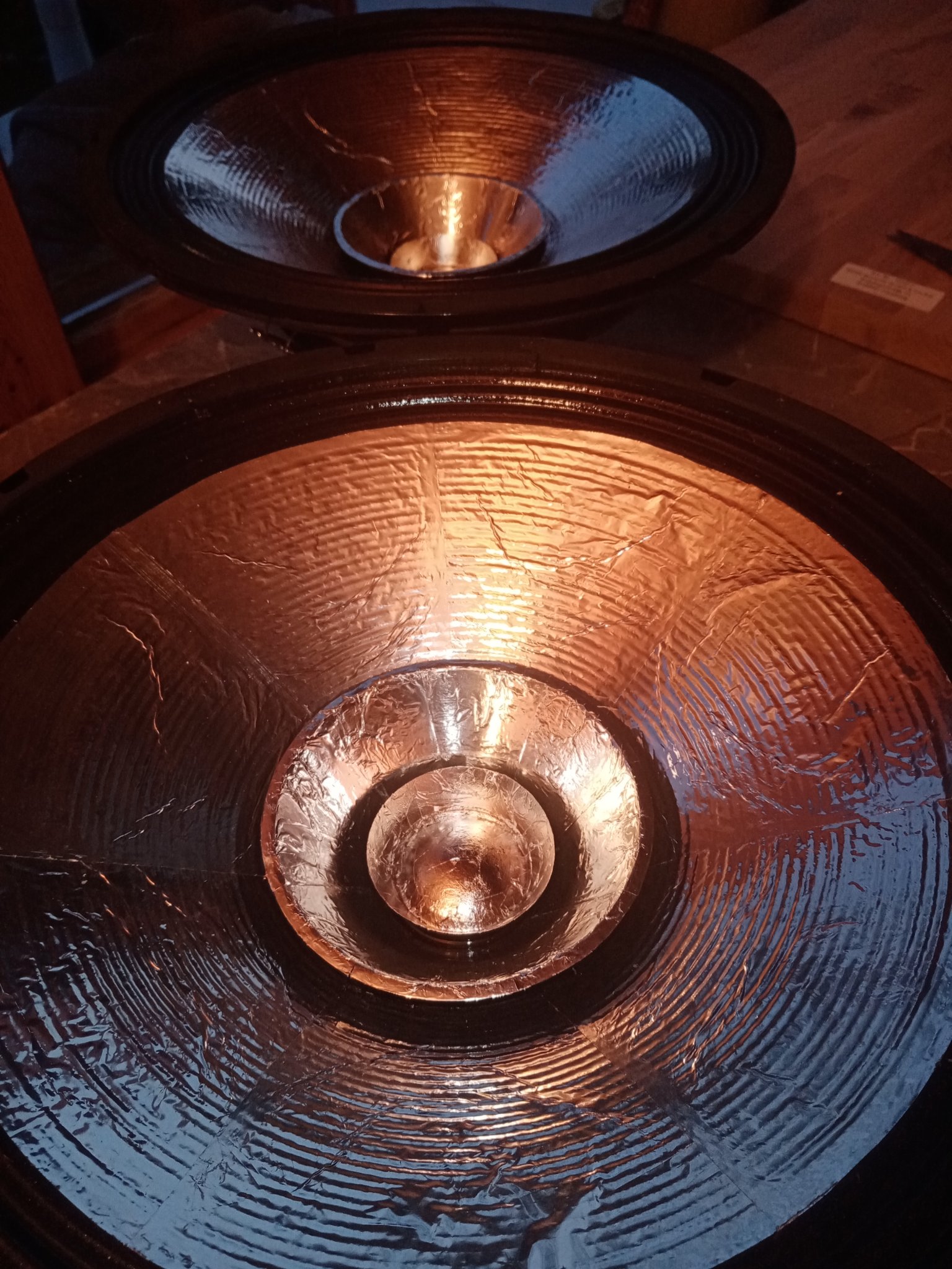

The King for me is this 15 inch fullrange but with my aluminium sandwich mod, Fane Sovereign 15 300tc
