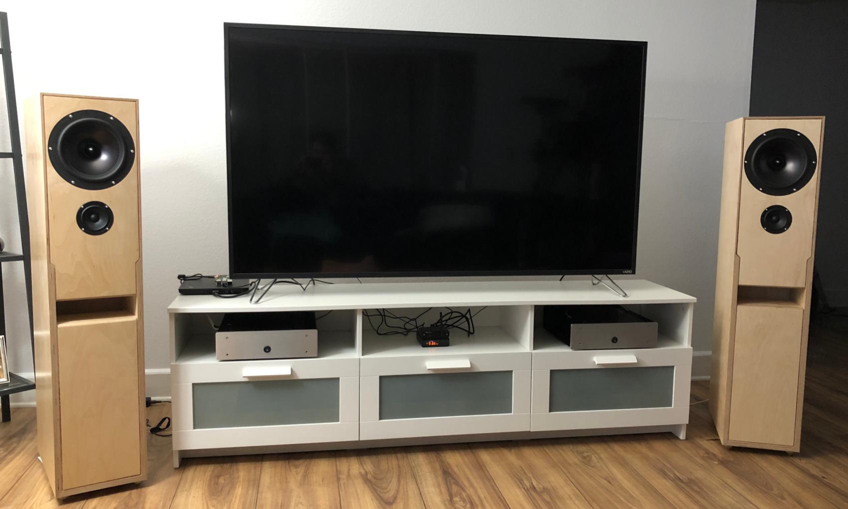

Beautiful build of this speaker by @as8912:

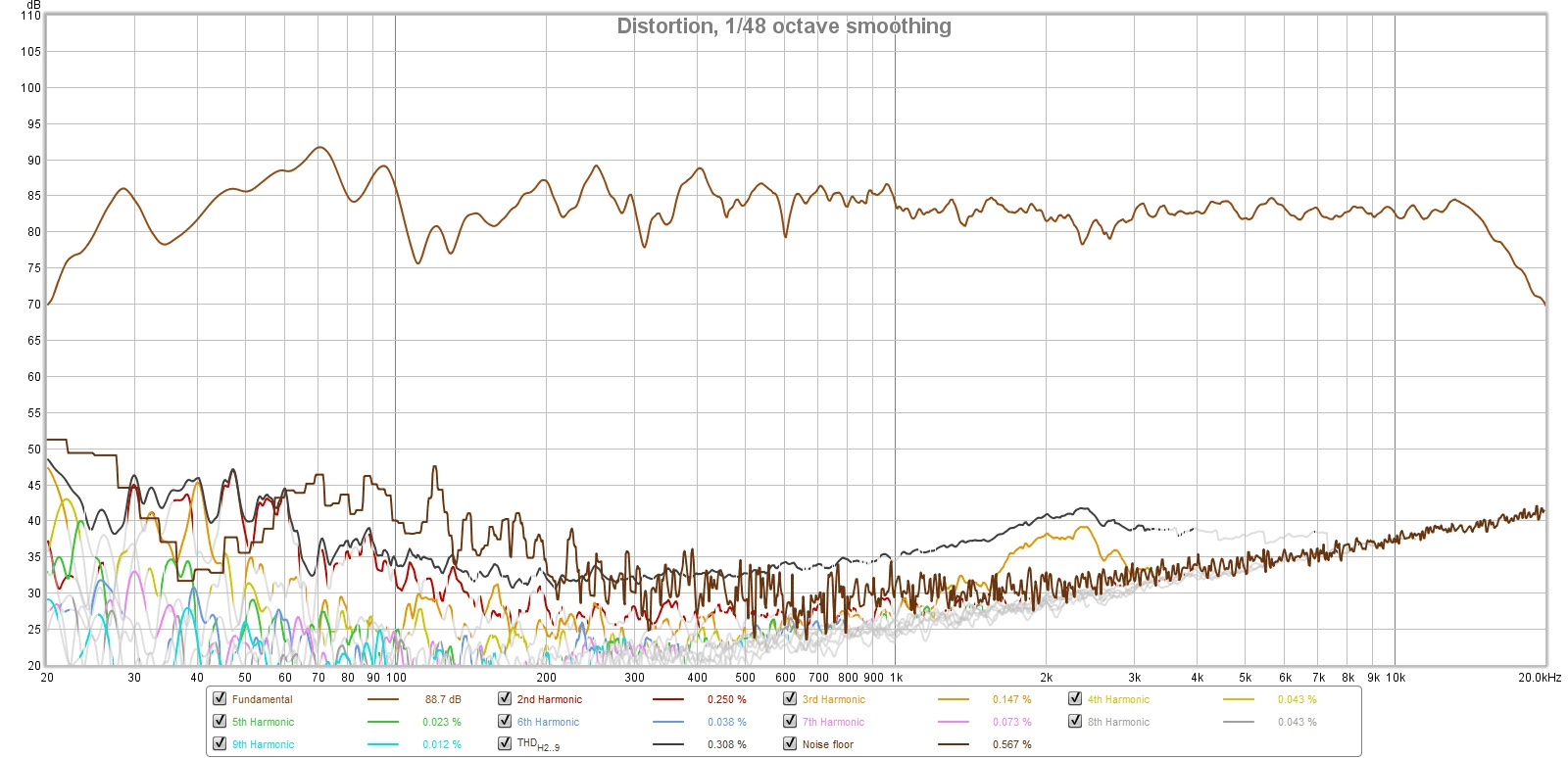

Here is a measurement of the response, there are some room effects and floor bounce etc below 300Hz:

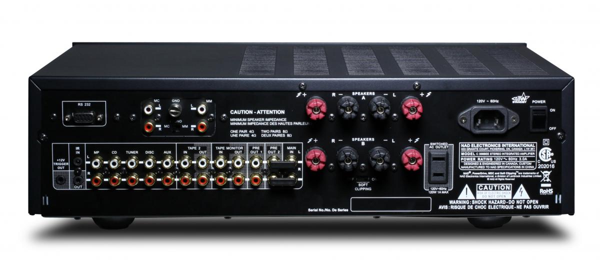

NAD 356BEE (it could be changed, an amp or preamp can be studied)
Many NADs are nice eniff to have a pre-amp out and a power amps in… yours has two pre-outs. 80 watts. What do you currently use to drive the woofers.
DCX 2496
The stock analog sections are useless. Might be OK as a sub XO and EQ only.

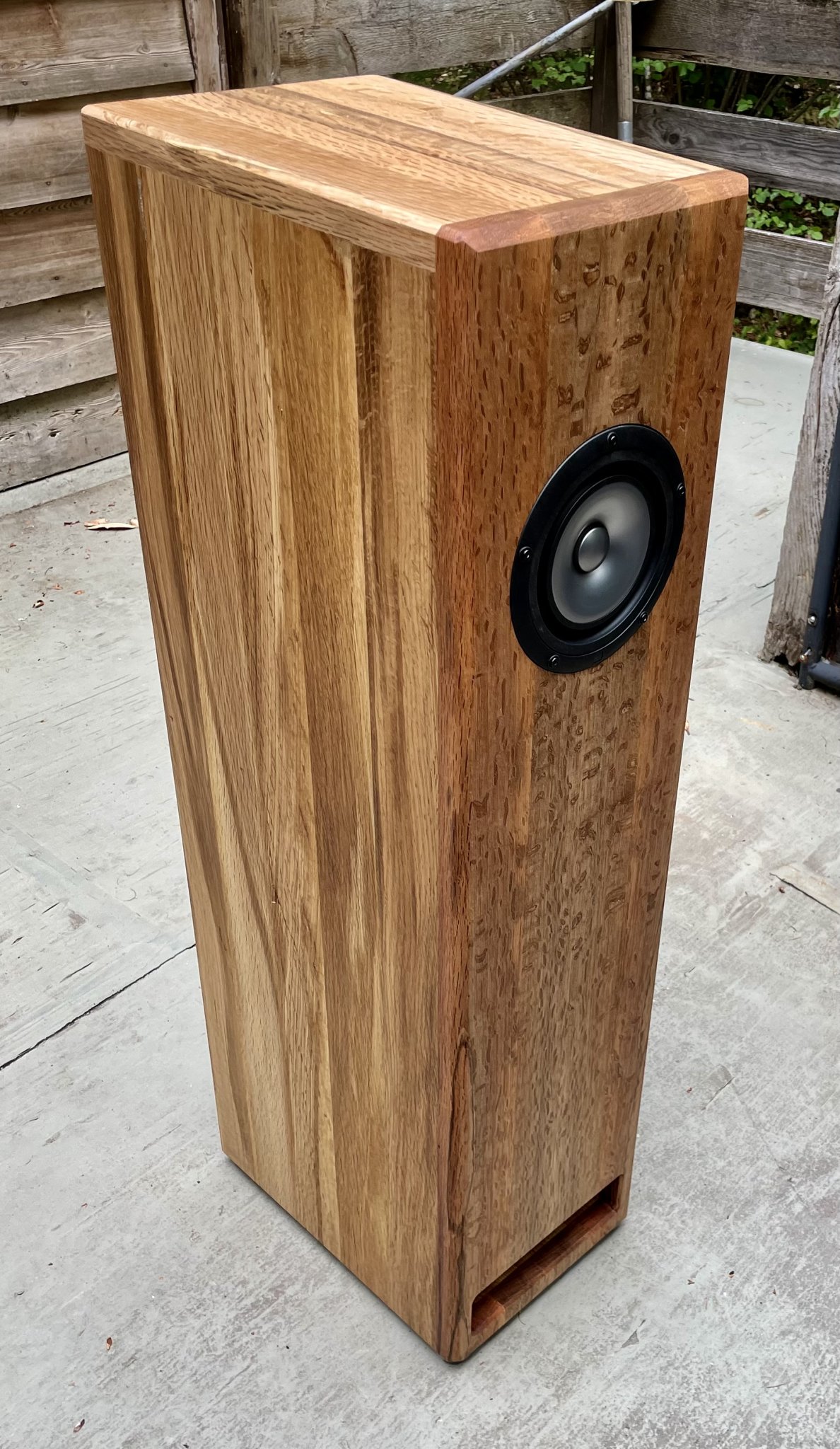

A10.3 is NLA and getting hard to find. I am working on a tweaks to the A11ms (and A7ms) that (mostly?) kills the “tizz” at the top. Other than that i really like them. Bernie built a paitr of solid FHXL w A!!ms. (i currently am listening to the first modded a11ms in Compact FloorStanderr dMar-Ken.

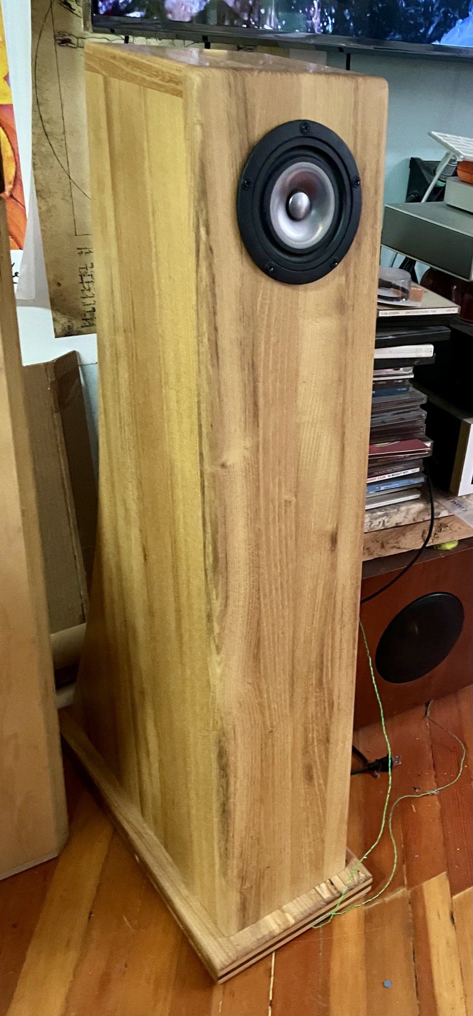

I hav eto take some pictures of the CFSers, here is FH3 with A7ms and Pensil11ms. All solid wood and right up in quality/koolfactor as the Sibelis.
