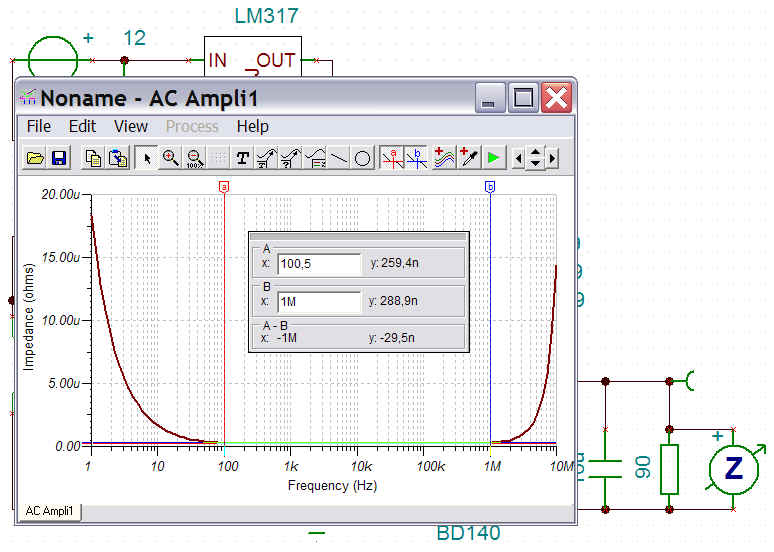

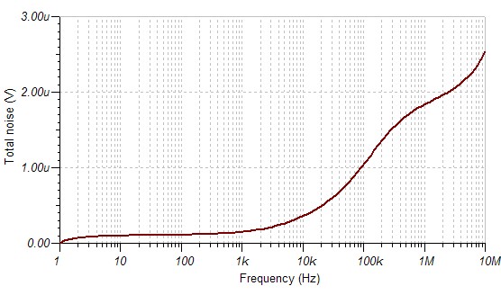

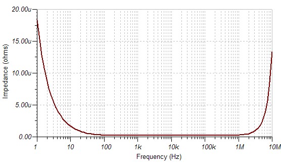

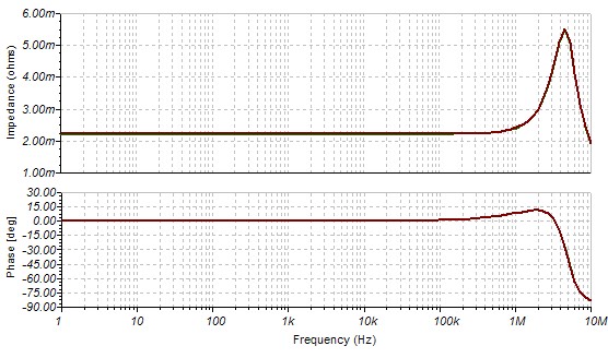

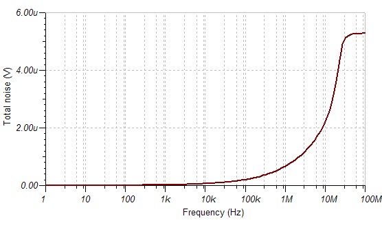

Hi
Yes it is.
intermediate version is stable curves (bond will not be published)
and bottom of today (srb-Snoise) 🙂

Hi
Yes it is.
Are these curves for real or simulations?
The impedance curve gets to improve on the Jung Super Regulators?
They were 100 microohms at a 10K frequency:
http://waltjung.org/PDFs/Regs_for_High_Perf_Audio_2_B.pdf
How can that be possible without the massive feedback in Jung's regulator?
That sim performance absolutely will not be what you get if you build one - the TL431 will dominate, it can be a noisy little sod - and does not have much gain at all; certainly not enough to drive output Z down to these levels, or maintain it there to a few 10s of khz, let alone Mhz.
