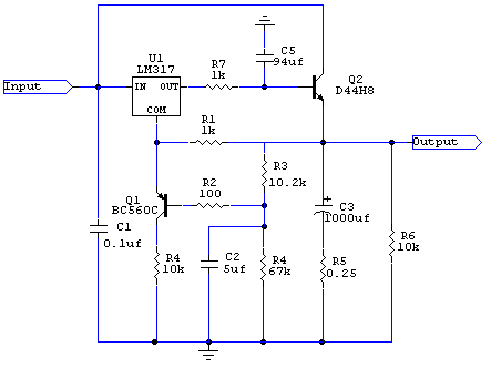

I tried to add a follower to the circuit, but did I do it right?
How will the value of C2 affect the performance of the Fred’s circuit?
Fred recommends a 1-5uf cap. I build it but only had a 94uf. It works fine (I think) but it takes approx. 10 seconds for it to reach the final voltage (did you say low corner freq. :D)
The smaller cap 1-5uf performs better at higher freq, but is there anything else?

Hey Guys,
I haven't following this thread, and I'm not sure what you are trying to do, but this R7/C5 thing completely destroys any regulation that was present in the circuit. The circuit degenerates to an emitter follower for anything except the very lowest frequencies. Are you aware of this?
Now that you say it and I look at it again I see your point. R7/C5 is within the feedback and will remove any high feq. noise from the loop.
So I should at leaste lose C5 if I want to continue with this circuit.

"So I should at leaste lose C5 if I want to continue with this circuit."
No you need to lose a lot more than that.................. the negative feedback loop is in the IC and is inaccessible externally. You are degrading the performance of the regulator.
The adjustment terminal is the negative terminal of a 1.25 V voltage reference who positive terminal is connected to Vout. The programing resistor and the resistor to ground constitute positive feed back. Bypassing the resistor to ground reduces the amount of positive feedback which has the same effect as increasing the negative feedback. You have to understand what a circuit does before you go throwing parts at it to change it. I will never understand why people do this. :whazzat:
