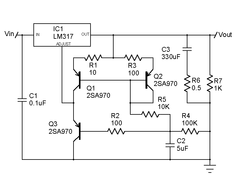

One way for improving the 3X7 regulator
It really is worth using a current in between Vout and ADJ since the variation of the 1.25 volt reference in the regulator IC is the main contributor to PSRR and output impedance degradation. I have a circuit that should work pretty well with easily available parts. The transistors can be any thing with a very high Hfe at a milliamp or two. C1 should be a film cap and you can get away with something like 1uF if you what. I believe the voltage out is about 15 volts for the resistor values shown. I also have another design with a current jfet and a diode thermally coupled to the regulator with copper tape. The thermally coupling and the likely hood that you don't have a jfet CCS in your parts box may make this an easier circuit. You could get rid of Q1 and Q2 and put a resistor across Vout to ADJ but the performance of the circuit is not as good as with the current source.

Fred, I stumbled across your post while looking for a compact - yet well performing - regulator. How does it compare performance wise to the ordinary LM3x7?
I have some question:
1. What would the regulator for the negative rail look like apart from using a LM337 instead of the LM317?
2. And how much capacitance can be used at the output of the regulator while maintaining stability?
3. How can I calculate the output voltage? Input will be around 25v.
I'm in the process of drawing my first PCB (yes, I'm a noob as you might have figured from reading the above questions, sorry). The space is tight so there's no room for the Jung superregulator. The regulator will power 3 or 5 OPA134 for an L-R 12db/okt or 24db/okt crossover.
I hope you can answer some of my noob questions. I'm not exactly an EE...
Fred,
while this design is discussed, there is one thing I have wondered
since you first posted it. Q1 and Q2 looks like a multiplying current
mirror, but I don't quite get it if that is important and has some
advantage I don't get, or if Q2 could just as well be replaced by
a diode? Not that it matters much in practice if using cheap BJTs,
I am just trying to understand the design.

Yes Christor, it can be a diode. I have actually built the circuit with a 1K resistor from Vout to ADJ since the extra complexity and cost of the transistor current source really didn't add to the performance. Something that occurred to me drawing the schematic, is that the ADJ terminal of the LM317 is sitting on top of a simple shunt regulator to ground (biased by a constant current source action, as well as bootstrapped by the three terminal regulator), a pretty neat trick for one transistor and a few passives. I will make some noise and PSRR measurements this week since my wife felt sorry for me* and let me buy a 24 bit sound card ( which can measure in the microvolt region without any external amp on the input to the sound card). I have another IC regulator circuit with an external voltage reference which is suprisingly simple for its performance. The design looks sort of interesting and should be a very substantial improvement over LM317/LT1086 type regulators (even with the shunt transistor circuit added to them). The LM317/transistor circuit appears very stable ( the voltage moves less than +/- 0.1% after the regulator warms up) and seems to survive output and input shorts without the addition of protection diodes. I have also built the jfet CCS version and with the addition of a diode thermally coupled to the regulator, it's output voltage is very stable as well.

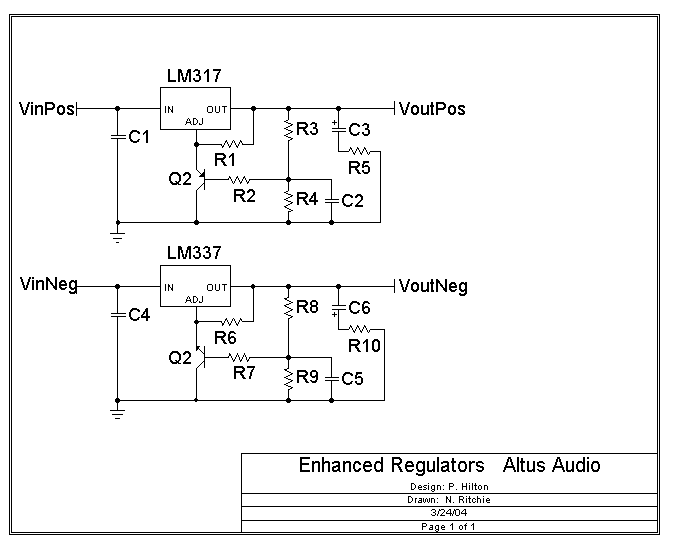

What I ended up building is a one transistor addition to the three terminal regulator. The three transistor circuit doesn't add much to the performance and is not worth pursuing IMHO. Any good small signal transistor with an HFE of several hundred will work. Use a 1K resistor to program 1.25 mA through the transistor the error current through the voltage divider that sets the voltage will be 1.25mA divided by the Hfe of the transistor. You will want at least 100 times this current through the resistor divider to minimize the error. The transistor should have a base resistor of about 100 ohms to limit fault currents from discharge the bypass capacitor connected to its base and to provide better RF stability. All the bypass caps in the schematic are metalized film except the output electrolytics. About 0.1 to 0.47uF on the input to the regulator and 1 to 5 uF for the cap to ground connected to the base are fine. These are not that large size caps if using a metalized film cap. Stacked layer Polyesters would be about the smallest and polypropylene the largest (but with better performance). This circuit is not that critical for cap values. Put a 0.5 ohm resistor in series with the electrolytic output cap to ground. The main idea of all this was to use film caps of fairly low values with the transistor to make the impedance at the AJD terminal lower. There should be a large amount of leeway in the parts values for this circuit while still achieving a great performance improvement over the data sheet bypass circuit. I did not show the preloading resistors on the outputs but I would shoot for a minimum of 25 and preferably 50 to 100 mA. The output impedance is proportional to this current load and higher currents give lower output impedance. They also give more ripple on the raw supply so a balancing act is required to optimize both of these deign goals.

Fred: In the quest to make a silk purse from a sow's ear, interestingly enough, I also made a souped-up 3-terminal regulator circuit strikingly similar to yours. However I placed C2/C5 in your circuit directly at the base of Q2, to lower the drive impedance into Q2.
The cap used here turned out to be surprisingly audible, so I would suggest doing some swapping and listening. My own preference seemed to be tied to a good high-frequency impedance curve on the cap. OS caps and tantulums sounded better to me than any normal electrolytic tried, including audiophile as well as industrial grades.
hth, jonathan carr

I am glad you asked since I didn't get my message across, my fault
"Is this correct values?"
Absolutely not........... The idea is to make R3 R4 large to get a good low frequency corner for the filter. R3 should be 10K or above (probably not greater than 50K for the transistor base current to be small in comparison to the current through R3) I am using an A970 and C2240 for the transistors but anything with a beta of 400 or more at 1 mA will work. BC550 and BC560 would probably work very well and as would the 2N5087 and 2N5210. The Hfe for the ZTX450 and ZTX550 might be a little low but might work with adjusting the value for R4 and R9 to compensate for the larger base current. The electrolytic on the output should be in the 220uF to 1000uF range and don't leave out the series resistor. Quality and not quantity is what one should look for in the caps used.
Sorry I was vague, it was 4 in the morning.........
Fred
jcarr said:
Fred: However I placed C2/C5 in your circuit directly at the base of Q2, to lower the drive impedance into Q2.
Is it a way to form a LF filter to avoid HF noise entering the base of Q2 ?
Have you tested with an additional cap across R4/R8 (> 100uF) ? According to ALW (see here), this cap seems to do a nice job.
Well, it's not exactly the same purpose, but I was wondering...
Edit : Sorry Fred, was typing while you replied... My additional cap question is in the case C4 is directly connected to Q2's base...
