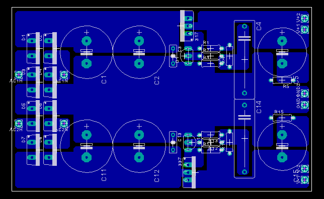

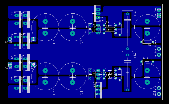

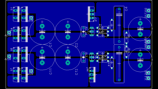

If you use SMD/MELF resistors and can physically get the junction of R3/R4 really close to the base of Q2, you may find that you don't need any additional base stopper resistors at all, in which case R2 can be eliminated. Ditto on the negative side.
But if you can't make a physically tight layout, and significant pcb or lead trace remains between the junction of R3/R4 and the base of Q2, I would leave R2 intact (and get the trace/lead length between R2 and the base of Q2 as short as possible), Otherwise Q2 may exhibit signs of instability.
Besides, Fred's point is valid. Fault protection should always be considered.
Look at the schematic, consider what you can accomplish with the board layout, and weigh the possibilities of some kind of fault condition occuring (including human error).

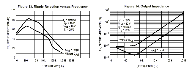

No the AC loop gain changes........ check the data sheet figures below for the LM317 below to see how much bypassing the ADJ terminal improves PSRR out and Zout over a large frequency range!

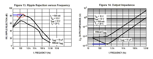

Dear Fred,
Your improvements in ripple rejection ratio and in output impedance are shown by blue lines.
Fred Dieckmann wrote “Yes, and similar improvements in PSRR”
As you can see from the data the circuit with Cadj=10uF _already_ has nearly the same PSRR as your one (red circle). I always thought that the ripple has the frequency 100-120Hz, why we need the improvement below? 😀
Fred Dieckmann wrote “No the AC loop gain changes........ check the data sheet figures below for the LM317 below to see how much bypassing the ADJ terminal improves PSRR out and Zout over a large frequency range!”
