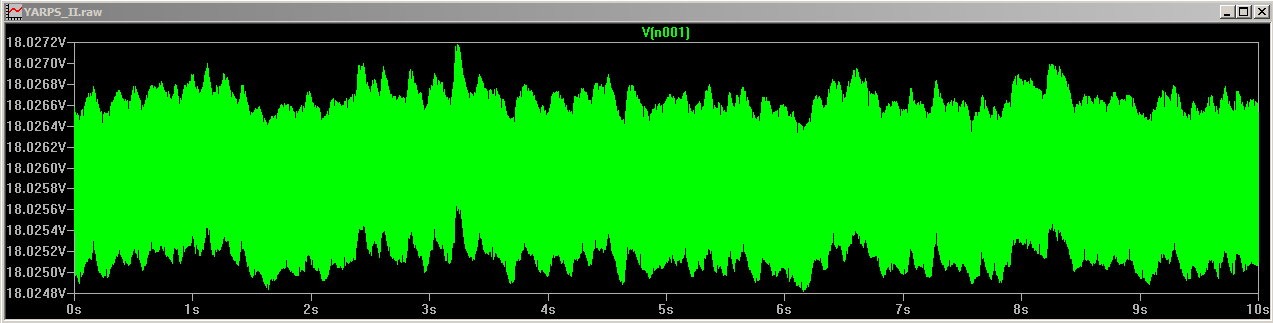

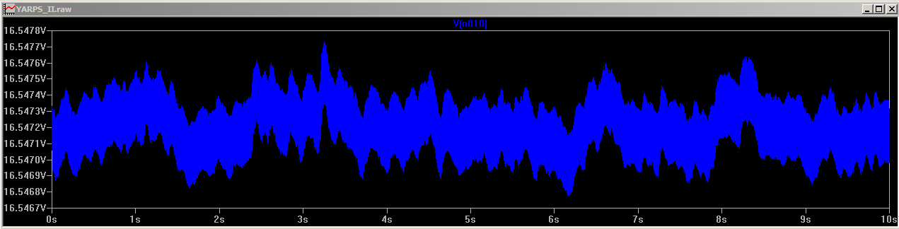

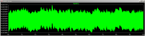

Hi Carlmart, This blog entry has some scope measurements which clearly show what a difference the resistors in the CRCRC network make to the ripple pre reg --> http://www.diyaudio.com/forums/blogs/wintermute/574-yarps-finally-some-progress.html It doesn't show only having the resistor in one leg of the supply though. I did test that as well and it did make a difference to the final pre-reg ripple (from memory it was significantly higher without the r2/r4 and r102/r104).
Thoese extra resistors were one of the things I was unsure about when I first simmed it, because I had not ever seen a PS with resistors in both the +ve and -ve legs.
I may have documented that in my measurements thread, I can't remember. --> http://www.diyaudio.com/forums/power-supplies/188975-lm317-experiments-measurements.html
Unfortunately now that I have made the final circuit it will not be easy to test the difference, as I don't really want to desolder the resistors from the board. However I can show the difference in the sim 🙂
Yes the pre-load resistors are to improve performance, I think it was Jan Didden that pointed out that LM317s perform better with a higher current draw, so this ensures a minimum of about 40mA of constant current draw 🙂
Tony.

Seeing those scope measurements, it's incredible why such a mod is not the first thing that is provided on any DIY job. At least on low current stages on preamps and power amps.
Even if ripple rejection specs are good, having less to reject should always be better.
Yes it was an eye opener for me as to just how much difference CRCRC made to the ripple. As you say though low current. Even with a very modest current draw (the sim output above is 250mA) the voltage drop is quite significant. The higher the current the bigger the drop. the difference between having or not having R2/R4 is about 1.5V pre reg in the above sim.

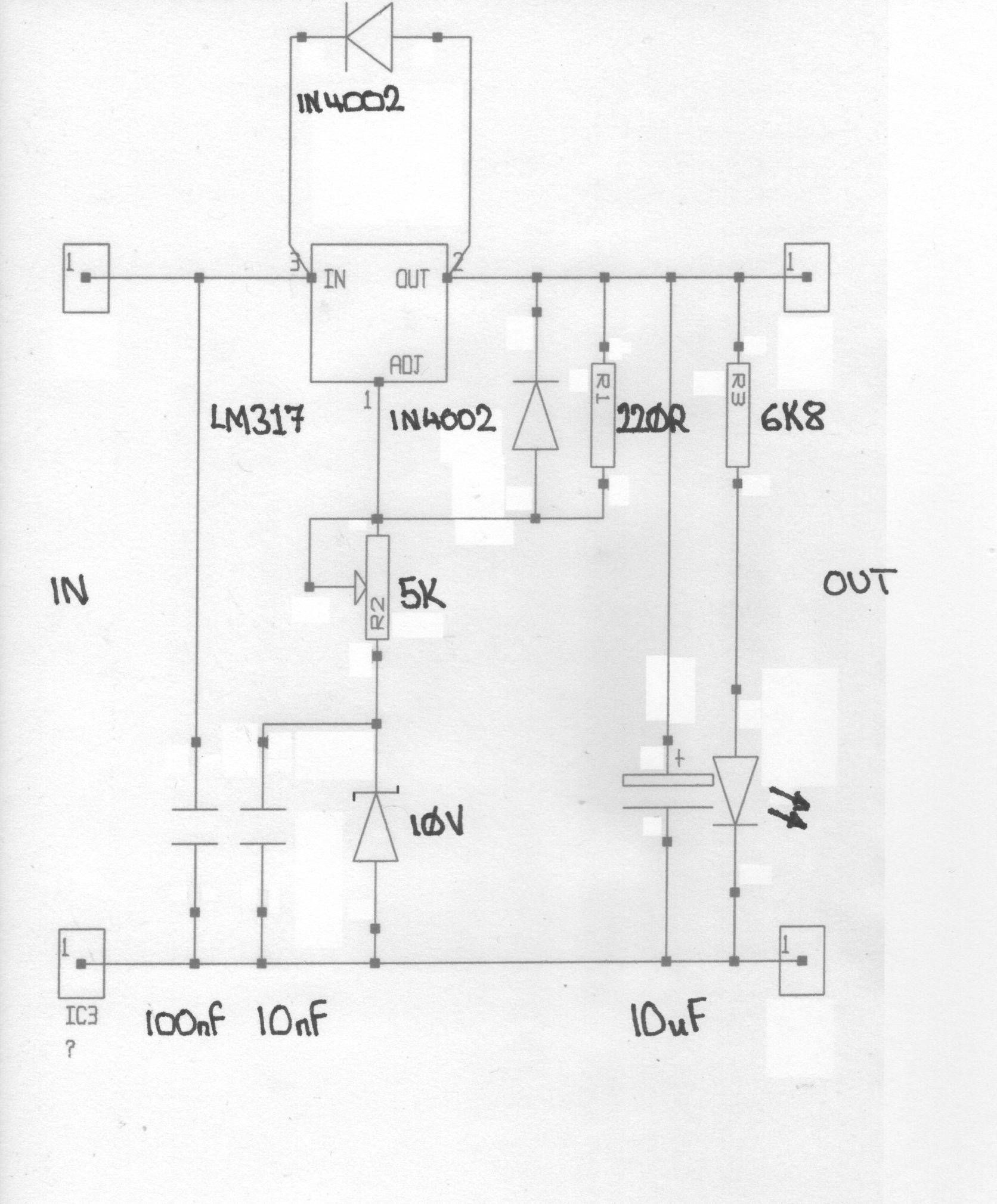

The upper 1n400x caters for back emf bypass when the transformer shuts down. Keep it.
The lower 1n400x caters for back emf when the regulator shuts down and is needed to discharge the cap smoothing the ADJ pin. 10nF does not require that extra diode protection to be added. 100uF across the Zener would require the extra diode.
The voltage from OUT to ADJ (if the regulator is not broken) is ~ 1250mV.
The current from OUT to Zener cannot exceed 1250mV/220r ~ 5.7mA
The worst case dissipation in the Zener is ~ 57mW.
In normal stop start run operation no setting of the 5kVR can damage the Zener.
@ 18V output the 6k8 has ~ 16V across it. The current passing to the LED is ~ 2.4mA
The total demand from the OUT PIN is ~ 2.4mA + 5.7mA + load current. The load current must equal or exceed 16.9mA at all operational conditions for the 25mA desired REG load to be true.

It works and the design is perfect, other than the possibility of damaging the zener without the extra resistor with R2.
I used this to replace the Shuntkys while I was trying to get my Pumpkins to work.
Do bear in mind that my load has over 30000uF in it and draws over 20mA in its own right.
There were two areas that were proposed here to improve and the reason for this topic:
1) The adjustment pin arrangement, where a transistor was added.
2) The output capacitor, where a resistor was added in series with it.
The 3X7s do not seem to like low-esr capacitor types, and the series resistor corrected that, allowing using any cap.
OTOS the 3X7s do not like too much capacitance, so if you are using 30,000uF as you say you are, that would go against many people that think otherwise.
