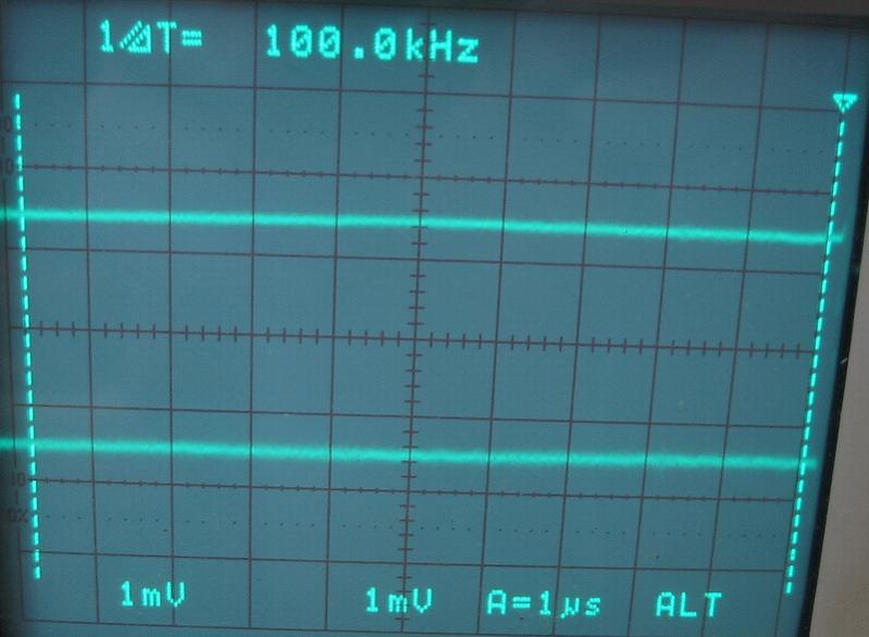

Hi ZLyzen, The output current is unaffected by the transistor. It is used to improve the noise rejection of the reg.
I have built a dual rail supply based on this idea from Fred, though I used two LM317's not the usual LM317 and LM337. latest test results here ---> http://www.diyaudio.com/forums/powe...7-experiments-measurements-3.html#post2834444
Earlier in the thread I posted differences between a standard setup and with the BJT. ---> http://www.diyaudio.com/forums/powe...7-experiments-measurements-3.html#post2834444 Note that at that point I had quite a few noise issues with my sound card preamp causing 50Hz interference, however the difference between the standard, and BJT circuit should be apparent 🙂 The standard circuit is improved by increasing the size of the bypass cap, but as can be seen it has little effect with the BJT circuit. This was the escence of Fred's design I think. that it was possible to use a small quality film cap for the bypass, rather than a much larger electrolytic.
