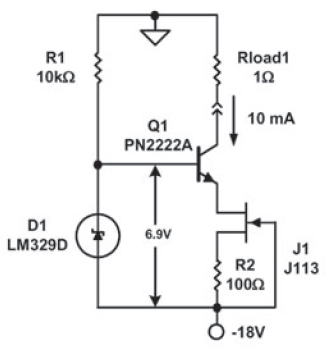

If we're going to give it a good rework, may I suggest considering an upgraded CCS such as the one from Figure 9F of Walt Jungs recent AudioXpress article: Sources 101: Audio Current Regulator Tests for High Performance, Part 1 Basics of Operation.
Better than 120dB noise rejection across the audio band!
Terry
P.S. a J507 is a possible substituted for the J113.

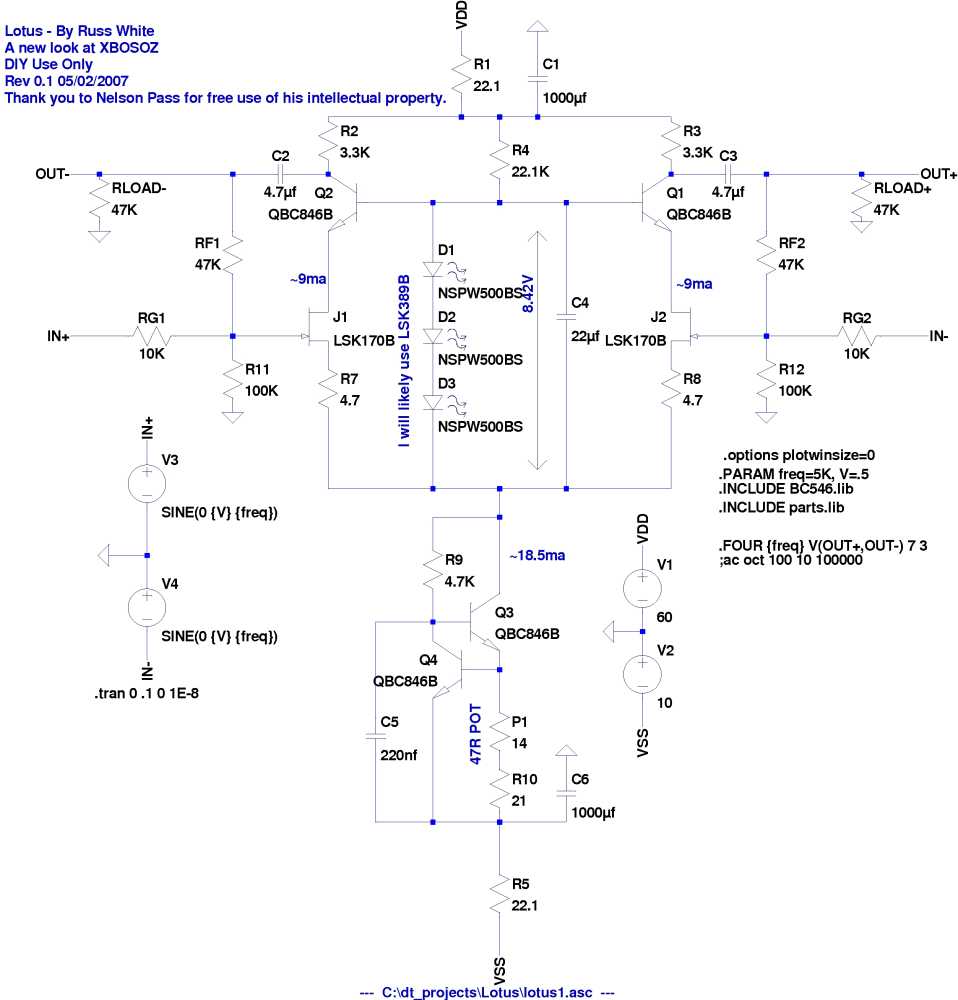

Trying to come up with a name for this pre that is not some long chain of Xs ,Ss, and Cs etc.... 🙂
So I thought Lotus might be cool.
Anyway here is my first take. It simulates very well. and should be able to swing about 45VPP with 60V at VDD. This should drive F4 very well. 🙂
Here it is. Feedback appreciated. :yes:
Cheers!
Russ

Not to complicate matters, but don't assume that better specs translate to a better sounding current source. I've seen the Jung article and can say that I've tried a number of those current sources. The ones that measure better are not necessarily the ones that sound better.
Grey

OK I have been working some more on this here are my ideas:
I would like to use dual transistors all devices.
For CCS and Cascodes:
BC846B
http://www.onsemi.com/pub/Collateral/BC846BDW1T1-D.PDF
For the JFET pair:
LSK389B
http://www.linearsystems.com/datasheets/LSK389.pdf
This should give excellent thermal tracking between devices and provide close tolerance for the JFETs.
It will also make for a nice compact layout.
None of the active components dissipate more than 200mw each 400mw combined for the cascodes. Those I may need to use single device packages do to thermal conciderations... Not sure.
Here is the simulated distortion at 20khz 4Vpp.
Harmonic Frequency Fourier Normalized Phase Normalized
Number [Hz] Component Component [degree] Phase [deg]
1 5.000e+03 4.356e+00 1.000e+00 -0.05° 0.00°
2 1.000e+04 7.539e-08 1.730e-08 91.62° 91.67°
3 1.500e+04 5.269e-05 1.209e-05 1.97° 2.02°
4 2.000e+04 5.979e-10 1.372e-10 101.77° 101.83°
5 2.500e+04 3.884e-08 8.916e-09 -178.54° -178.49°
6 3.000e+04 1.119e-09 2.569e-10 35.65° 35.70°
7 3.500e+04 1.916e-09 4.398e-10 -43.82° -43.77°
8 4.000e+04 3.270e-10 7.505e-11 -64.78° -64.73°
9 4.500e+04 1.051e-09 2.413e-10 141.68° 141.73°
Total Harmonic Distortion: 0.001209%

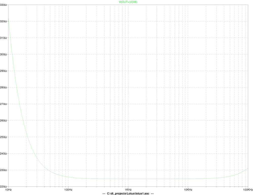

Attached is the output impedance graph...
Notice it is now down to about 225R

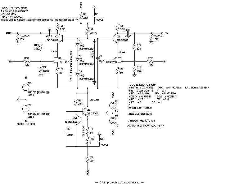

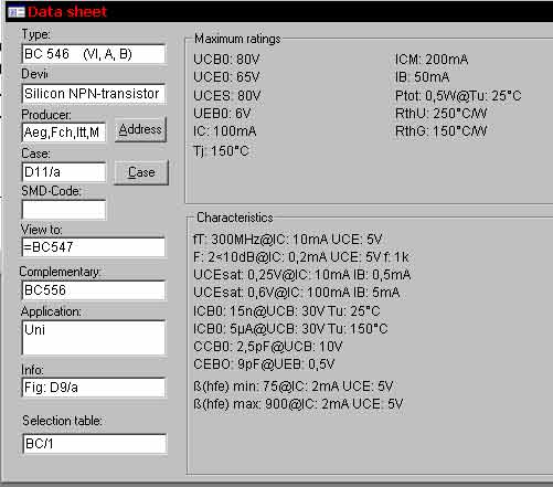

Russ White said:
Yes once I got a good look at the datasheet I see that. I will probably use two BC546C TO-92 types. They should handle 200mw each fine right?
yup
decrease current through halves to ~ 7mA.........jfets will be further from sat. , cascodes will be slightly relaxed
I overlooked - what are PS voltages?

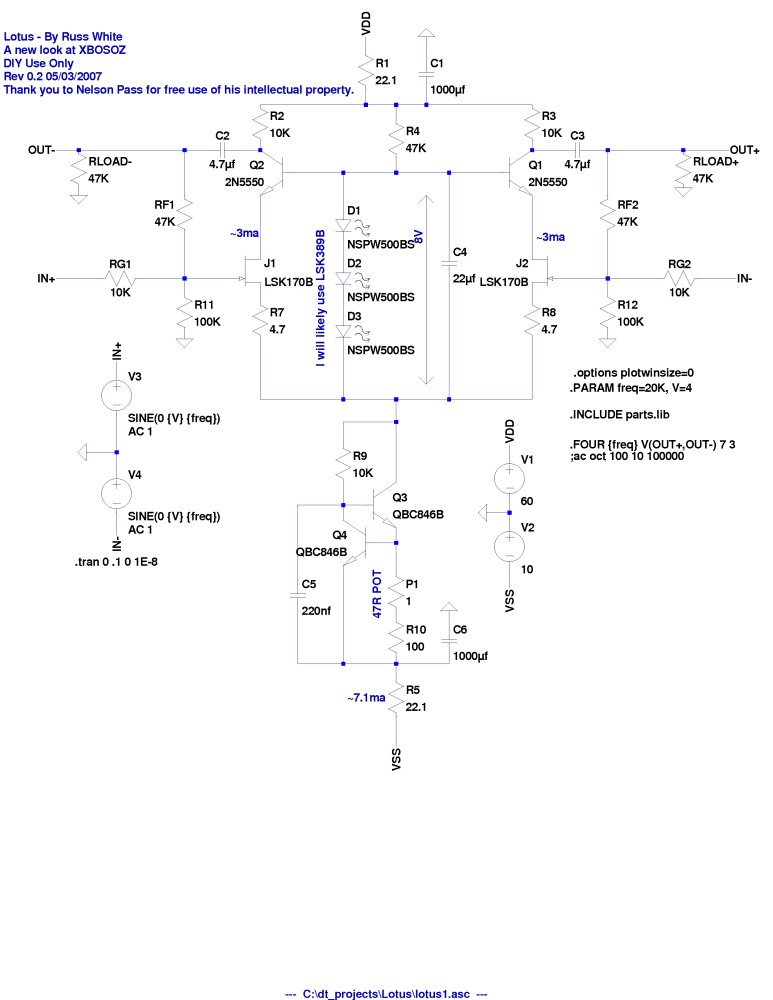

OK so this whole JFET deal is a bit new to me.
Looking at the datasheet for the LSK389 I see that the "B" version has a minimum saturation current of 6ma and a max of 12ma.
Thats quite a range.
I guess I have to plan for the worst?
I suppose I should probably aim for just over half the lowest possible sat current which would be 6ma. So 3ma bias current? or should I go up a bit say to 4ma and hope that I don't saturate?
What happens if I do hit the saturation current? (don't really see much in the sim, might not be modeled)
Anyway, Maybe something like this?
OK...........choose middle of working region............that means 9mA per jfet.........
3mA is waaaaay too low
when you hit sat current.............clipping

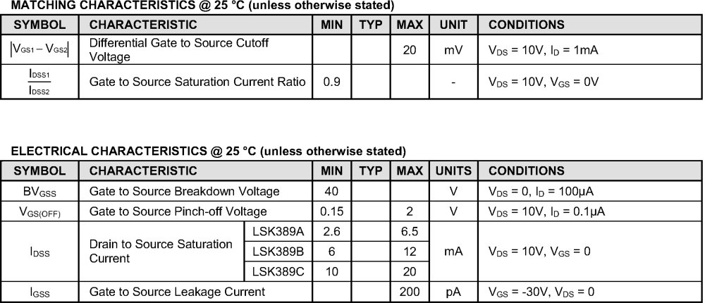

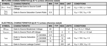

Ok now I really need to sort this out... 🙂
It would seem to me I should keep the JFETs operation in their linear region, right? with the "B" part 6ma could be in the saturation region. So it would seem to me I would want 3ma for the "B" part or 5ma for the "C" part.
I would not want to operate them in saturation right?
Here is from the datasheet:
without exact selecting it's hard to tell where little jfet will go nutz........but in real world that's not that complicated and serious;
to be sure 158% ,just place trimpot where it belongs - in CCSink and everything is OK ; instead resistor only,put combo resistor+pot,covering typical range of 5 to 12 mA and everything is OK
there is no need to over-engineering here
