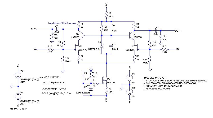

Russ White said:Ok I am simulating a couple options. 🙂
How far off does something like this look?
:EDIT: changed back some values I was testing in simulation:EDIT:
take feedback from outputs-after caps
toss out C6......
decrease R9 to 100E and put trimpot 47E in line or-even better- use two bjt CCSink
use something as BC546C instead 5550 in cascodes
take all this with salt........
Nice iteration...
Needs a cap to grd after R1, no need for C2.
VSS would need a similar treatment as VDD, like a R1 plus the missing cap.
- Improving on X-BosoZ to mate the F4
