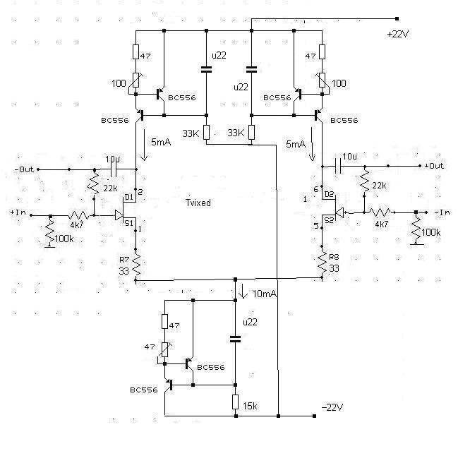

The J-fet modification was just what the BosoZ needed. I had a little debugging to do on my boards since I couldnt get the bias right. I had 7,5V zeners for D1 and that didnt work. I have been listening to it for a couple of hours and it sounds very good with the j-fets. There is more air and details in the topend as expected, expanding the soundstage. The J-fet upgrade is very worthwhile. This is the smooth sound that I was hoping for.
Thanks to Metalman and Zen Mod😎 I am looking forward to make it balanced out again and hook it up to the A-X's. Pretty exciting, how that will turn out🙂

Edit. For easy search, this is the schematic with the changes needed to make the J-fet X-BosoZ. See Zen Mods link below😉

Edit. For easy search, this is the schematic with the changes needed to make the J-fet X-BosoZhttp://www.diyaudio.com/forums/showthread.php?postid=1195149#post1195149
correction!!!!!!!!!!!!!!!!!!!!!!!!!!!!!!!!!!!!!!!!!!!!!!!!!!!!!!!!!
this is correct schmtc:
http://www.diyaudio.com/forums/showthread.php?postid=1195270#post1195270

steenoe said:............................. I had a little debugging to do on my boards since I couldnt get the bias right. I had 7,5V zeners for D1 and that didnt work.................
another quoting.........
as you mention to me in PM, it was crucial to down-rate bias through each half to 10ma,so we can freely assume that -with BL iteration- that is max current one can use for 2SK170 in that circuit.
with more than 10mA ,gate is too close to 0 volts ,so much closer to non-linear region ........
so- seems that 0,7V difference between mentioned zeners isn't much......but it is .........

here is older variation,I think from jfet-bosoz thread
"poorman variation of steen's jfet bosoz"

BrianDonegan said:So, funny thing. We are about out of X-BoSoZ boards, and trying to decide whether to reorder, and what tweaks we should make if we do... Hmmmmm.....
I'm pretty sure that Metalman will give you blessings for this last schmtc.........but he and steen deserve each.......say.......50 pieces ?
BrianDonegan said:trying to decide whether to reorder, and what tweaks we should make if we do... Hmmmmm.....
imo, them two K170's should be placed very, very close to eachother on the revision board, maybe even add a 7th mounting hole just to be sure.
