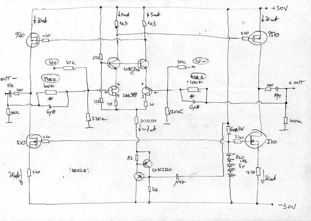

tnx. I already told you.......even when I scribe something ditto from my head , result always remind me on Aleph..........I'm anxious
but-what is even more surprising,at least for me ' is fact that I really don't need any of them.........preamp or amp.......
😎 but it is so big fun learning

post exact schmtc and I'll try to re-draw it for ya 🙂
Thats very kind of you, indeed. Once we have a finished roadmap, I am all set to test it.
The schematic was posted here:
http://www.diyaudio.com/forums/showthread.php?postid=1193716#post1193716

edit-tell me voltage of d1 in your schmtc , V+ and V-
editedit -steen - if you ever decide to build this "new" jfet schmtc ,I'll draw toob rectification and shunt regs for ultimate version...........hehe - which will last max 6 months at your place

Voltage of zener D1 is 6,8V.
Positive rail is 60V, negative rail is 20V.

tnx . noted
tube stuff.............you will...at least susy preamp .....in best forum tradition - it'll be named Death of All Papa's Preamps .......DoAPP
