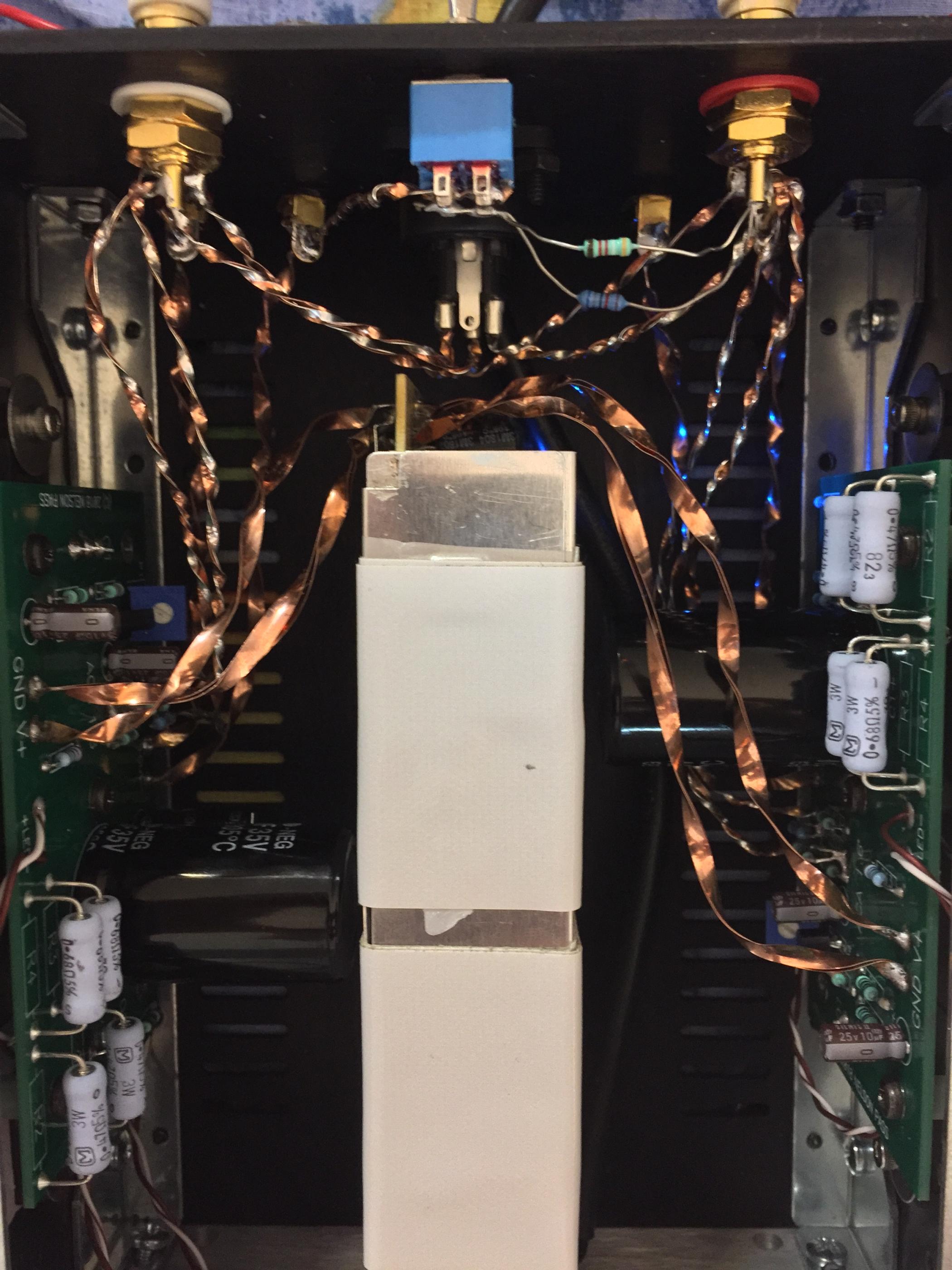

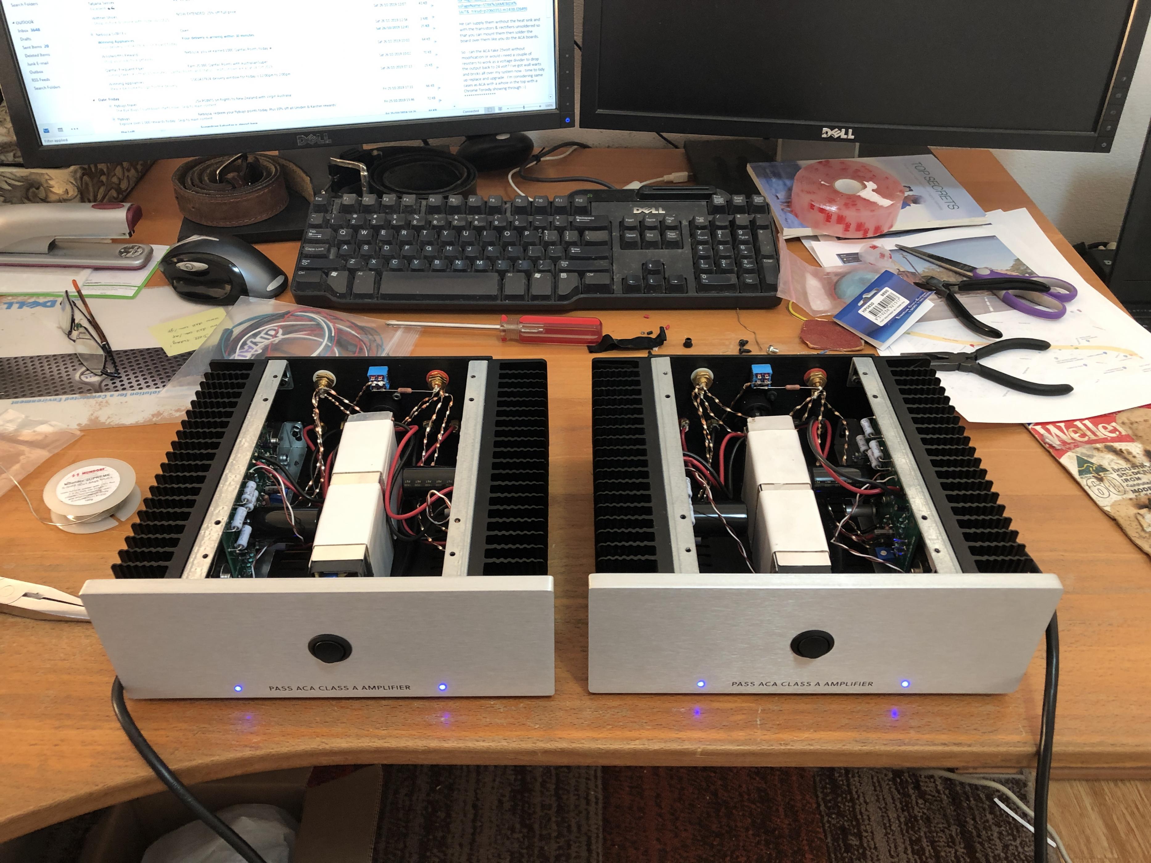

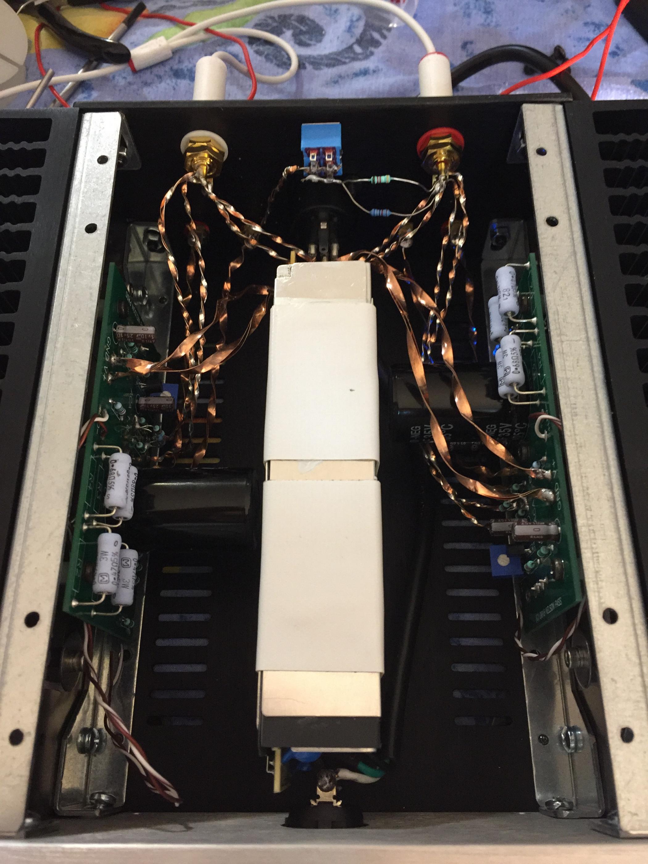

I had a bit of time to play; connected my ACA's, dual monoblocks, power supplies installed inside the chassis, configured for bridged operation. There's simply no comparison, ACA's blew my (modified!) 820BX4 out of the water.
Incredible difference.
It's not that 820BX is bad, it's just that ACA's sound is sooo much more natural, fluid, extremely fast... and... spacious.
Build ACA's... and then move to Aleph J... or simply, go straight to Aleph J.

Those twisted copper flat wires, your ACAs look stunning! Right now such kits are beyond my budget. My whole rig is worth $600. Good thing is it sounds quite exceptional for the money 🙂

Re: wire...in general... try using a solid core copper wire. For input signals, use a bare (unshielded) twisted pair, CAT5e solid core copper. Do not use litz... some CAT5e cables use litz twisted pairs.
For power and speakers, use thicker solid core copper wires. Again, avoid litz cables...

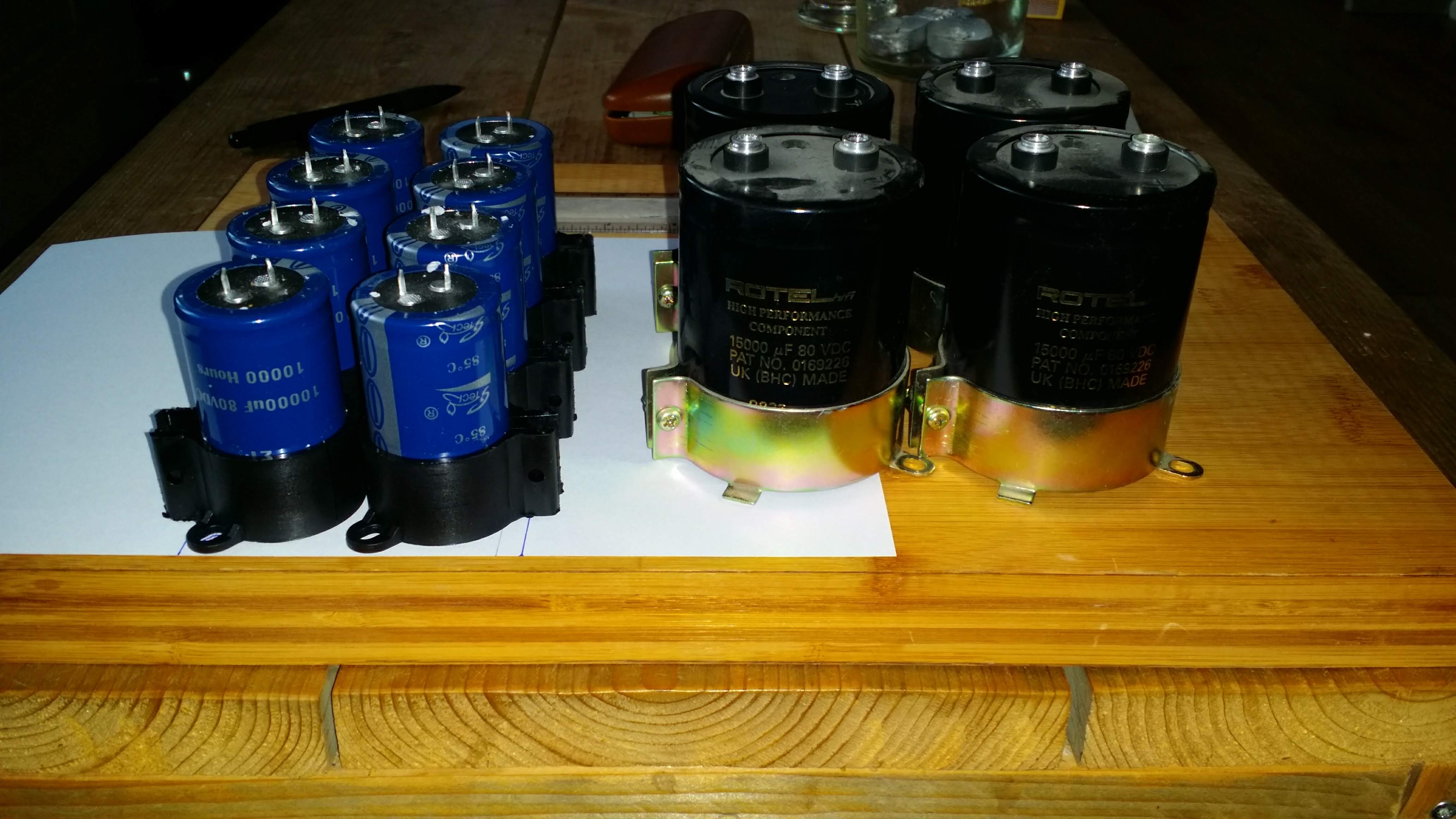

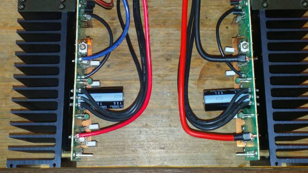

Overhaul & upgrade Rotel RB-991
Hi there,
After reading this thread a few months ago i reached out to Per and asked him if he could do something for my 2 Rotel’s RB-991's.

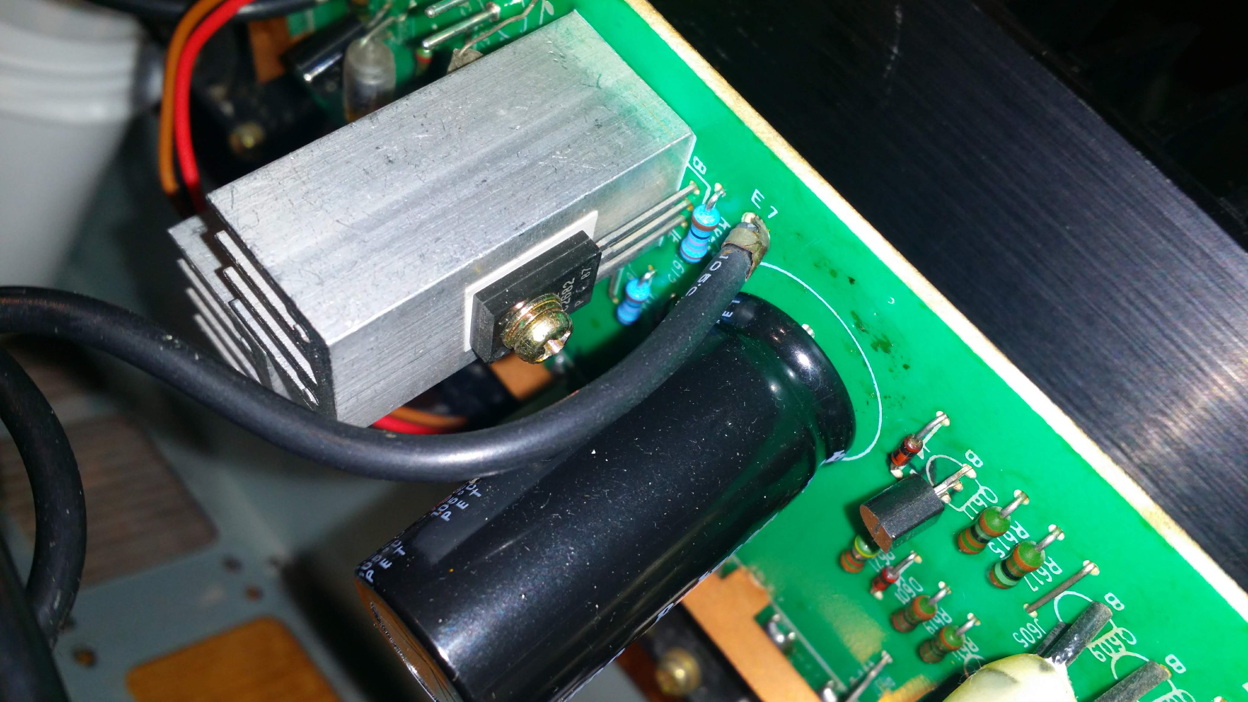

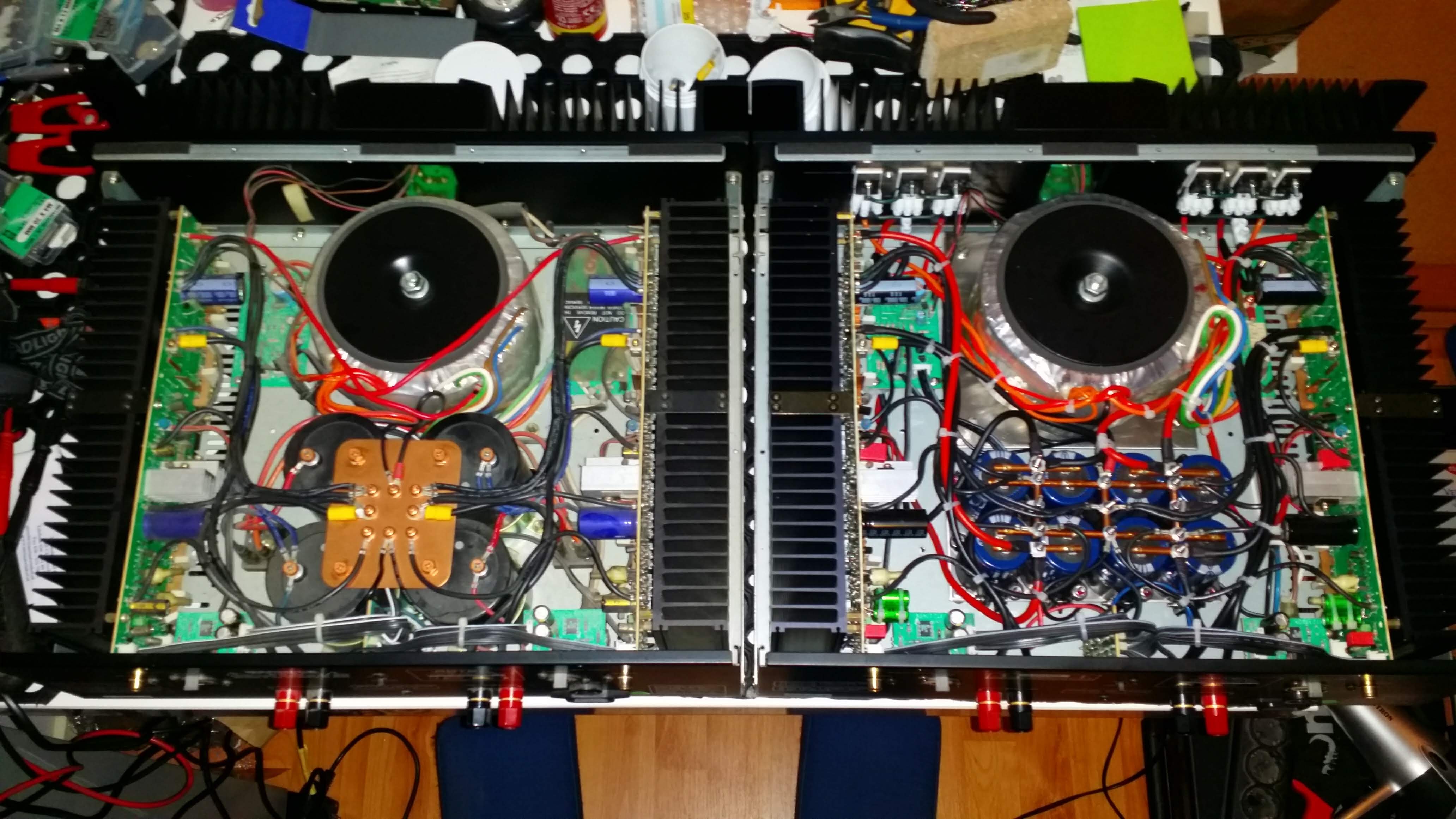

After 20 years of amplifying music they needed some tlc.
Per gave the tech manual a look and told me that this amp had a completely different design then the amps he was working on. He was very busy so he asked me to go ahead with the planned upgrades and be patient for a while.

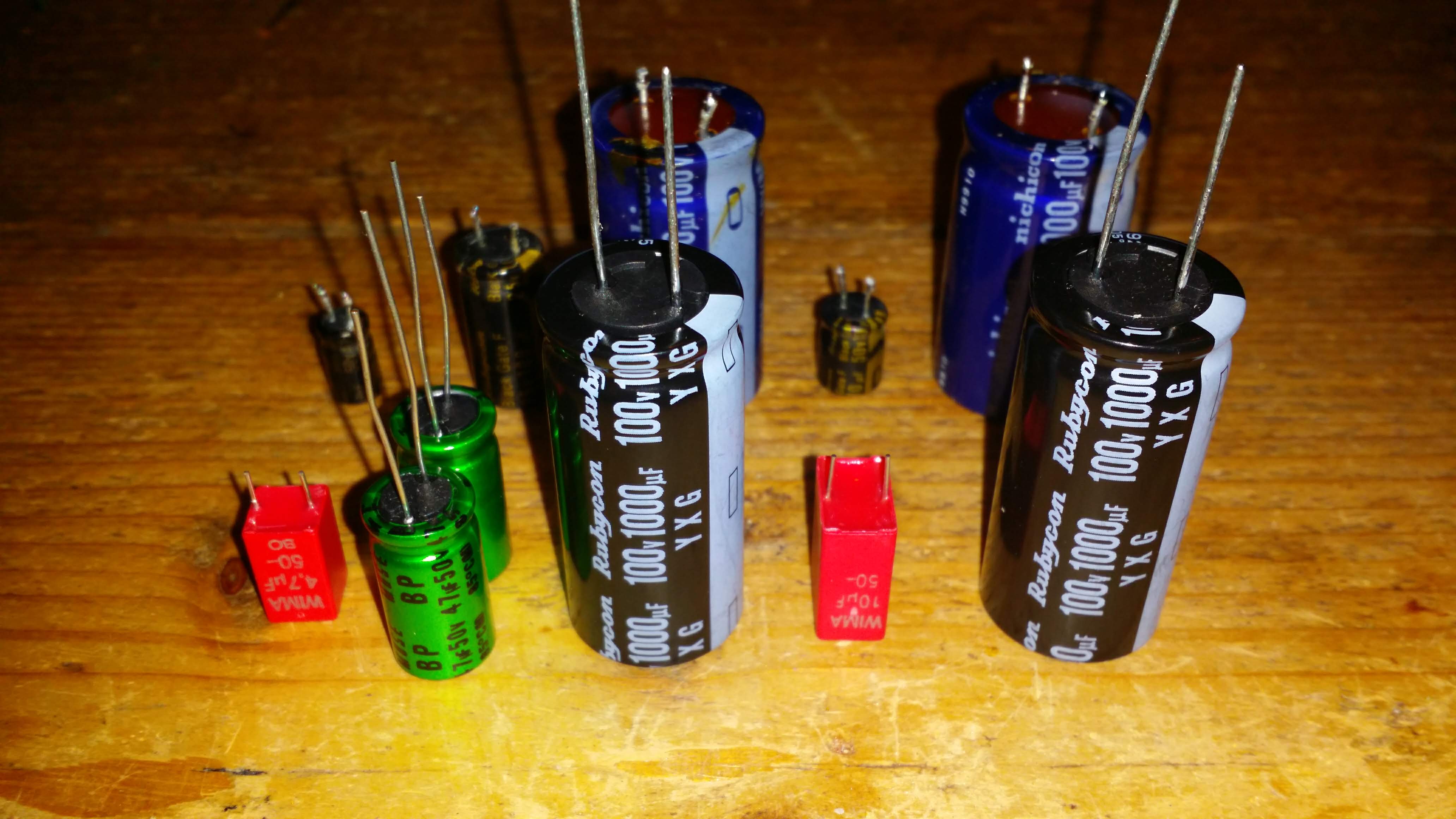

I went ahead with replacing the psu caps, rectifiers and the electrolytics on both channels.
The aftermarket psu caps where bought from DNM which stands for Dennis Neil Morecraft, he has the patent for the slitfoil capacitor. The caps are made by Supertech to DNM's specifications. Stock was BHC 80Vdc 15000uF, the DNM's do 10000uF so i replaced 1 BHC for 2 from DNM.

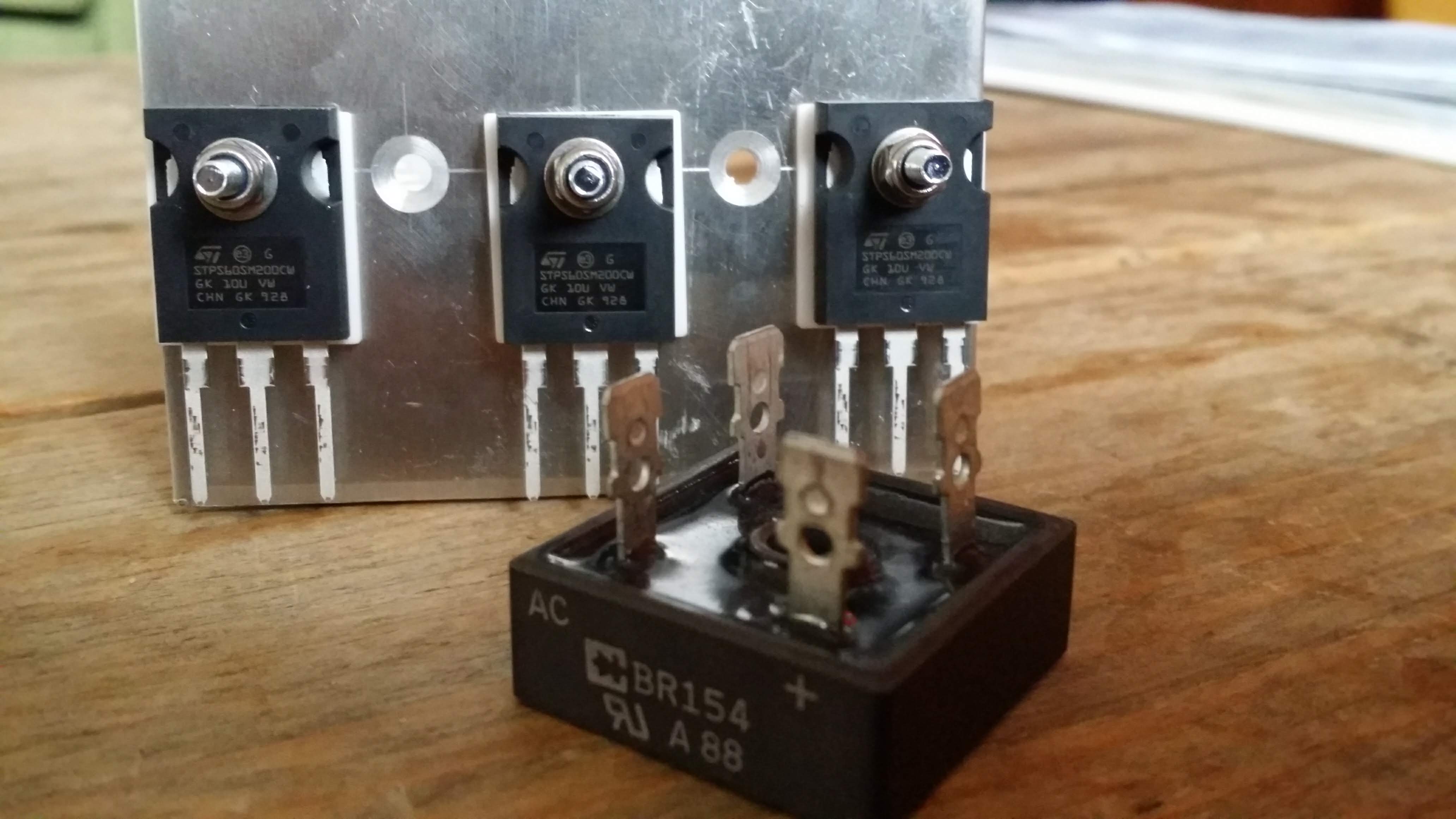

Stock rectifier(s) pulled out and replaced with 3 x STPS60SM200CW Schottky diodes. Psu wiring to the channels was replaced to 6 mm2 copper litze with crimped copper terminals.

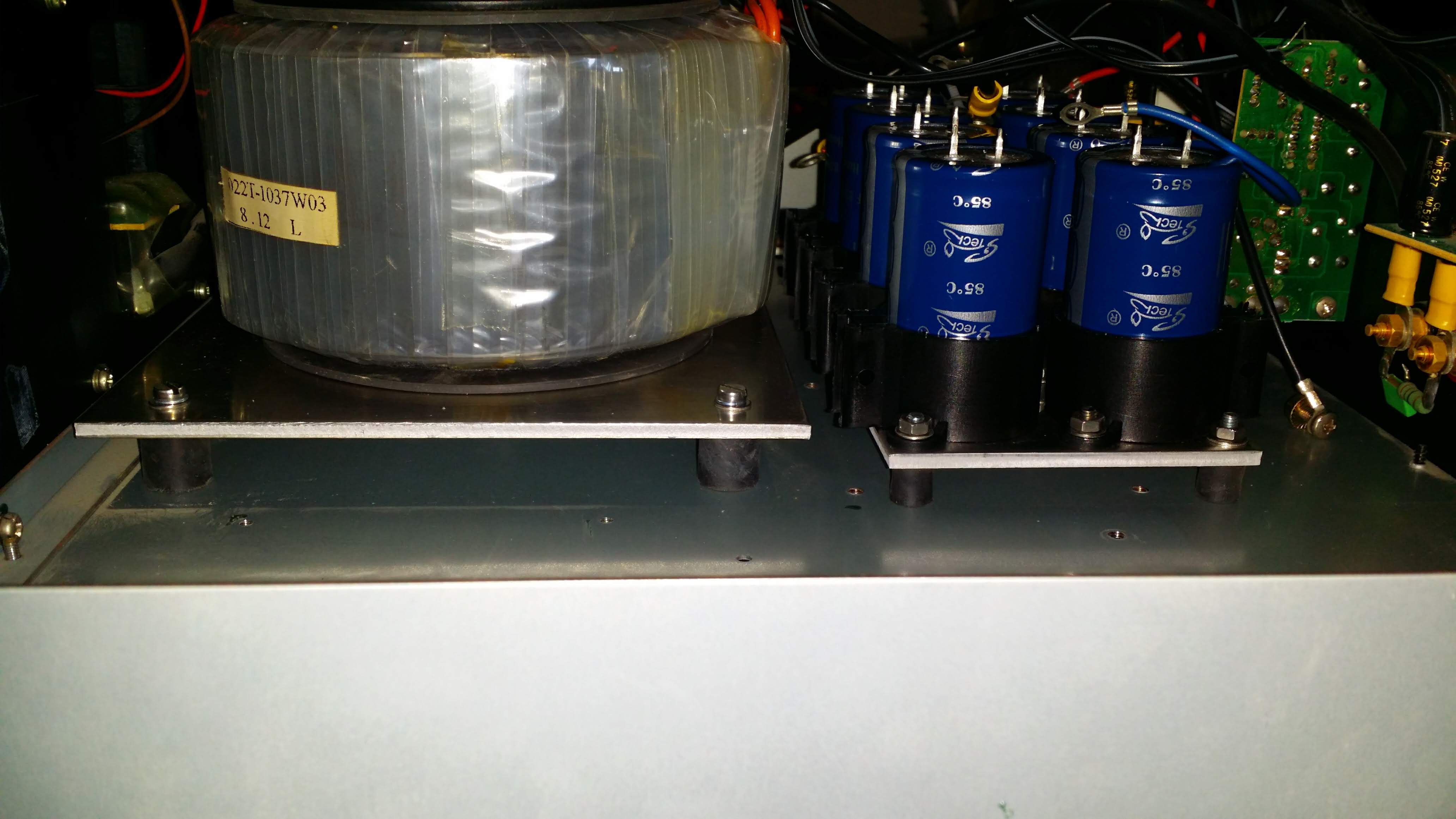

Toroidal trafo and psu caps bank where placed on separate 4mm thick aluminium sheet panels with vibration dampers connected to the chassis to minimize vibration influences.

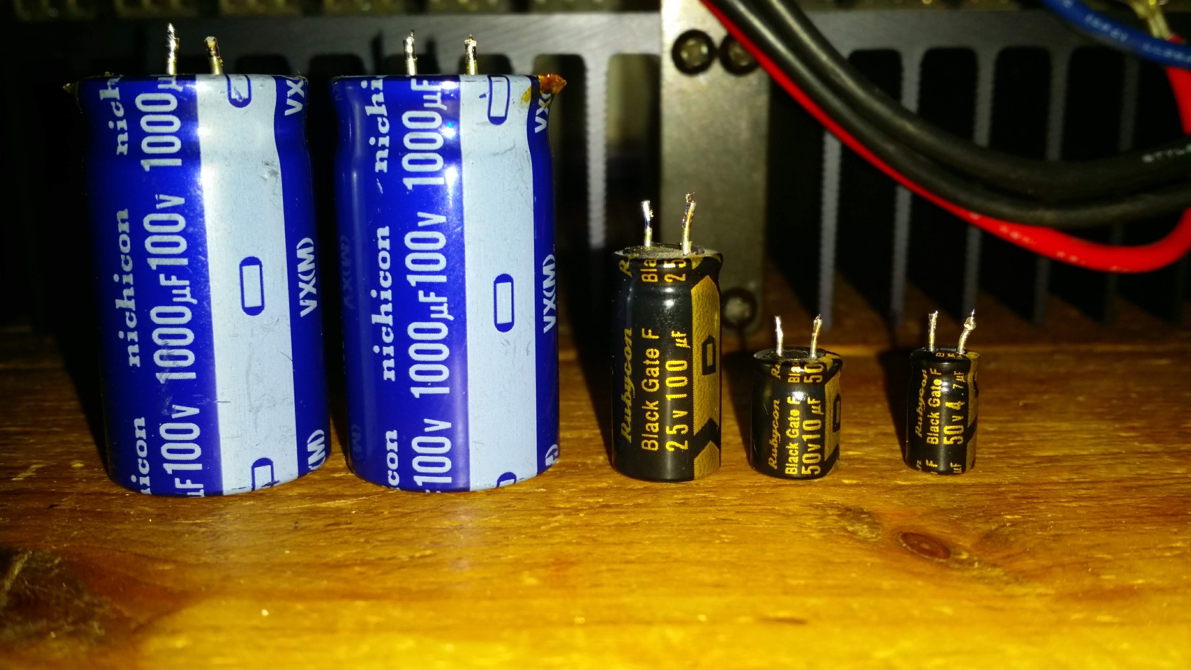

Electrolitics:
C601/602 50V 4,7uF Black Gate replaced by : Mundorf Mcap EVO 1uF
C607/608 25V 100uF Black Gate replaced by : 2x Nichicon BP 50V 47uF
C611/612 50V 10uF Black Gate replaced by : Nichicon FG or Elna SilmicII 50/10
C623/626 100V 1000uF Nichicon VX(M) replaced by : Rubycon YXG 100/1000
I started with Wima’s on 601/602 and 611/612 but ditched them because i didn’t like the sound.
I haven’t made up my mind yet soundwise on the Nichicon’s or Elna’s on 611/612.

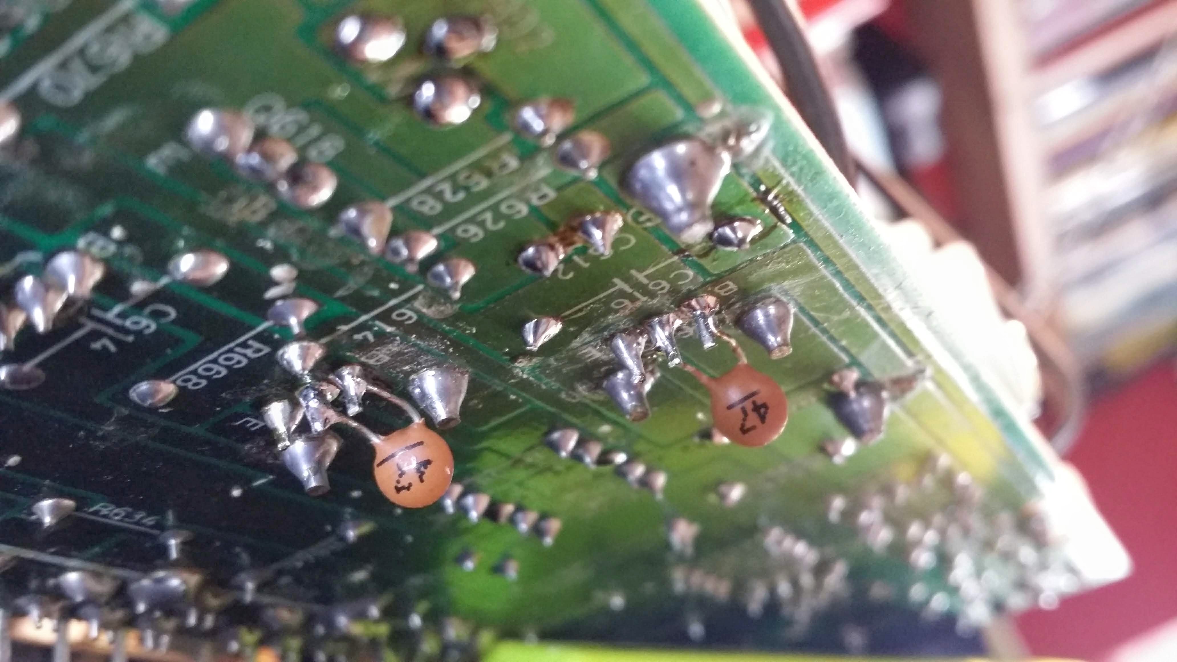

Part 2:

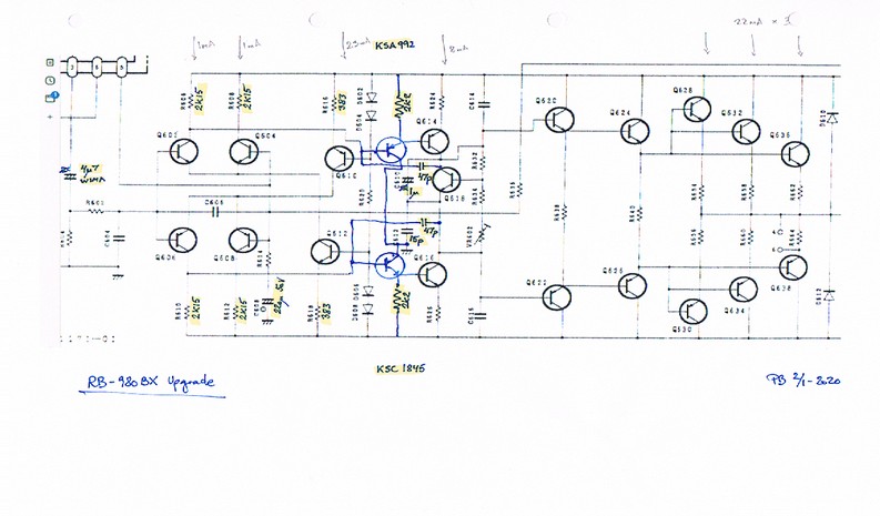

Then it all started to get very technical for me as Per guided me through the amps and asked me to take measurement (Vdc across) on resistors R629/623/630/624 (100R) at VAS transistors Q615/613/616/614.
The VAS transistors where very hot to the touch and that showed in the measurements, almost twice the voltage as was calculated!
Heatsinks where dissipating 1,1 Watt but are designed to handle 0,5!!

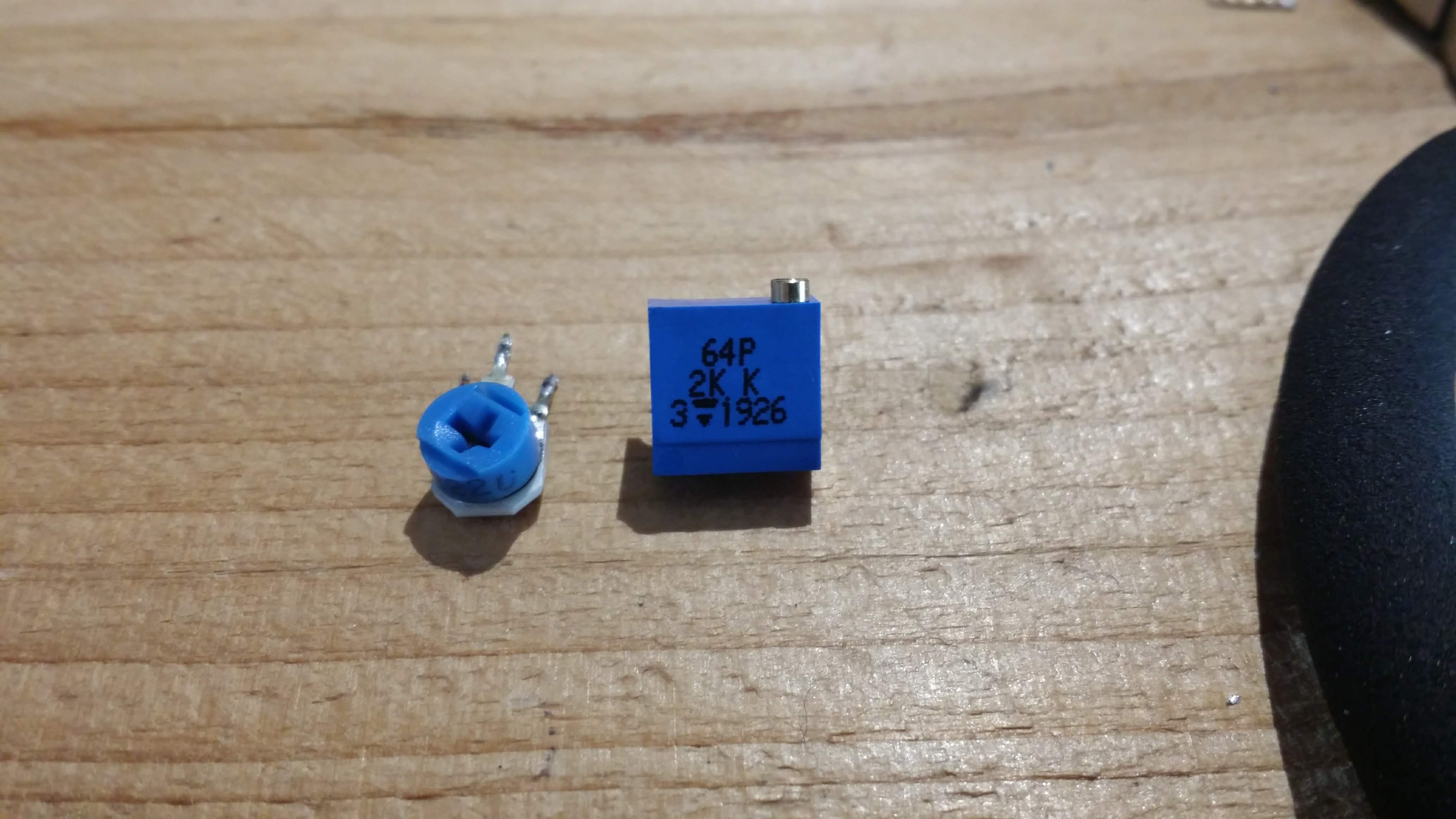

Per recalculated the value for the resistors to 196R but we settled on 187R 1% 0.5W metal film.
I also ordered new multiturn 2.2K 0.5W trimmers for the bias, the old single turn trimmers where very difficult to set.
After i did this job the VAS was indeed running cooler, warm, not lukewarm but warm.
This made the amps already sound better, like without effort, less restraint….
Per warned me about the next step because it would affect the much loved Rotel sound.
By design the VAS is heavily loaded to create this Rotel sound.
It is done with C609/610, a 330pF with a 33K resistor parallel.
Both of them where replaced with 1 x 15pF 100V ceramic npo cap.
Miller caps where placed between VAS base and collector, 2 x 47pF 100V ceramic npo cap.
After i did this upgrade i was warned about oscillation and had to measure Vac between output terminals before listening to music.
There was no Vac measured so i switched them both on and was in for a big audiophile surprise.

I'm quite proud of what i did because i'm not educated in electronics at all, i know how to solder though and not afraid to rip a big amp apart into its components so i would like to offer a very big thank you to Per for his knowledge and patience with me :worship:
My stereo set is composed of a NAS to a Rpi3b (Volumio software) with ALLO Isolator and Kali attached, I2s to Doede Douma 1794 NOS dac, output to Silk tvc’s connected to 2 Rotel RB-991’s (Bi-amping) connected to Chario Millenium II
Did your damping improve? You’re man after my heart w/the PS & internal wiring upgrades and everything inspired me to get busy.
I’m using the subject amps in a tri-amp config. The 981 drives the mids & tweeters; the 980 drives a pair of woofers. If you have tips on parts selection to upgrade:
RB-980BX: focus is bass - LP’d ~120hz though 200hz is possible
RB-981: focus is mids, bandpassed 120hz & ~2Khz; tweeter HP’d ~2Khz
...I would be very grateful. I know the 990 series amps have been compared to Krell and Levinson w/out the mods. OTOH I’ve read the 980/981 called “baby 990s.”
I confess speed is not my forte’. I’ll start w/ studying your work very carefully. That and obtain schematics - yup when I do I’ll come back up on the net.
After I finish these, two each, a RB-985 is next. 5 100 Watts - considered by some a 5 ch 980BX.
I admire DIYers. I’ve done a little. Thanks in advance for your help & reading this far. Tony

I have actually recently repaired and upgraded a RB-980BX that had similar issues as Smartdriver's 991.
The 980 is actually a bit easier to modify as the pcb is more accessible and I could place emitter followers on the VAS stage.
I enclose the schematic that I finally decided on and my report on what was done and achieved FYI.
Per
Ok. So adding:
2 transistors - BTW what does the emitter follower do
2 resistors
5(?) caps
Any other upgrades or additions for the font end?
Power supply upgrades:
4 Smaller caps/channel
Bridge rectifiers adequate? Or high speed diodes?

Hi Tony,
The emitter followers function like a buffer or (sort of) like a unity gain (x1) opamp. They provide the same ac signal from input to output, but have a high input impedance and a low output impedance. This reduces the VAS transistors' loading of the LTP input pairs and significantly reduces distortion.
I have designed two types of small modules, a current mirror (CM1) and a VAS3 which do it all (includes all the transistors, capacitors and resistors) and are much easier to install, but the very high rail voltages in the 980/991 would make them run too hot.
I am working on an idea (which Smartdriver is also interested in), and will be testing it on a RA-971 which I have had on my to-do list for too long.
So, if you have a bit of patience there may a workaround available soon.
Re: Power Supply, I believe the key is to have a high capacity and a low ESR (internal resistance) as possible so the reservoir caps can deliver the power required quickly.
Multiple caps do do that, but you need the space for them.
I wouldn't put in high speed diodes, after all they are only rectifying 60 Hz (50 Hz in our money). Even that requires a set of snubbing caps to slow down and reduce the diode switching noise.
But I know that some disagree with me on that point.
I agree Per 😉 this is a unticked box on the "to do list".
I read somewhere that you don't need to mount them on every diode because the ringing happens in the secondary of the transformer, so use one snubber on the secondary. Does this make sense to you?
