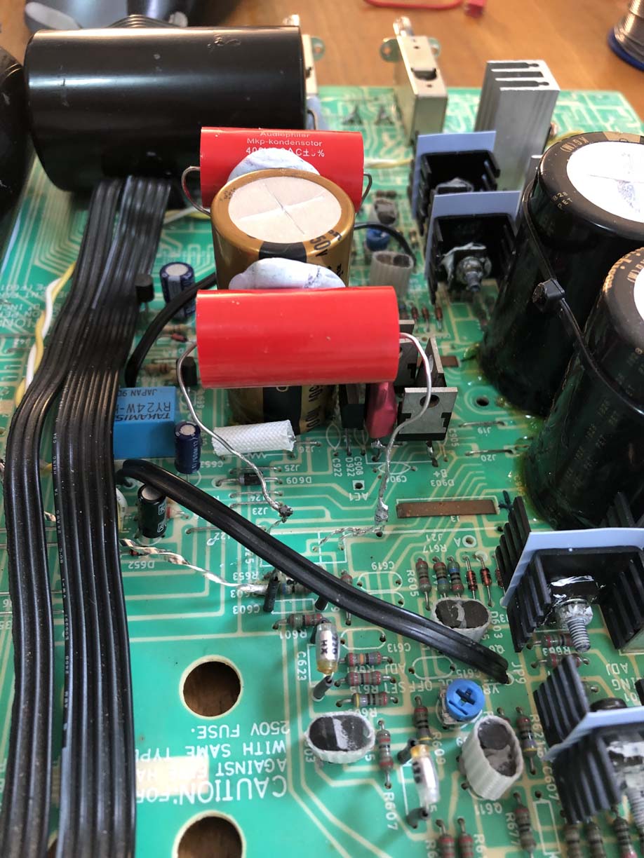

Anyway, here's two "before and after" pics. Cosmetically you could call it "barn find" to "concourse level" - but regarding audio quality it is more like "beam me up".

The 2nd modification stage therefore was set to further steady the current supply to the input and VAS stages by improving the ripple on the DC rails.

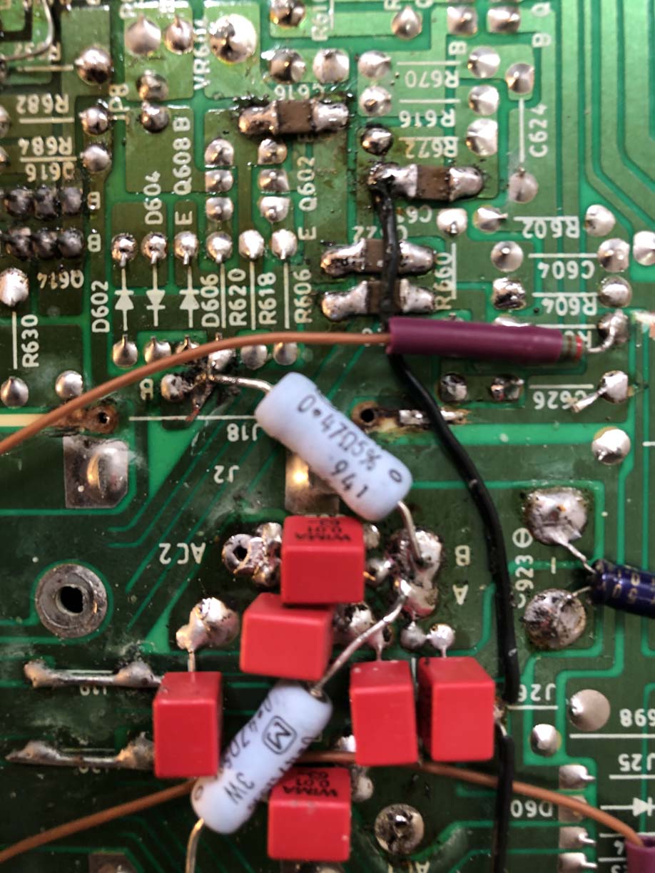

First by filtering the input stages' positive and negative supply rails with two 100ohm/100uF/100nF lowpass RC filters and then inserting a cascode transistor in the tail-current source using the filter mod from stage 1.
Does this work? - You bet.
Stage 2 results:
Input stage rail ripple:
Reduced from 30mVac to less than 8mVac

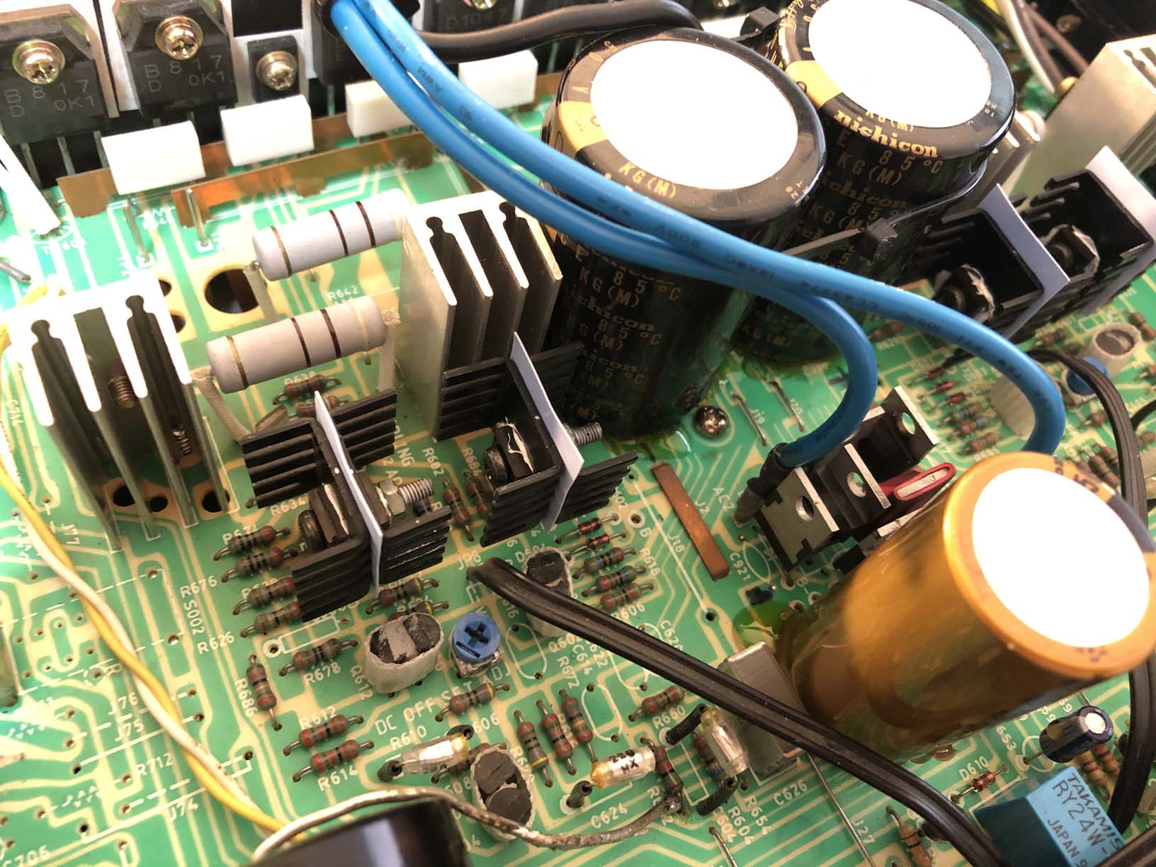

I'm a bit puzzled about how should I incorporate the filtering mod in my 840BX4. A solid state technology is not my strong suit.
The amp has a separate B+ rail for the power amp input stage (called +B3). It's independently rectified and smoothed although the ripple is 50 mV, much higher than in its little brother 820AX. The B- rail is shared, so it complicates things for me. Also positive and negative rails are coupled by C621, to make things even harder for me to understand.
Where should I put 100 ohm resistors? Perhaps at the input of +B3 and between R627 and R673? Should I place caps as close as possible to input stage transistors or is it not necessary? On the negative rail, do I need caps also after R685 dropping resistor?

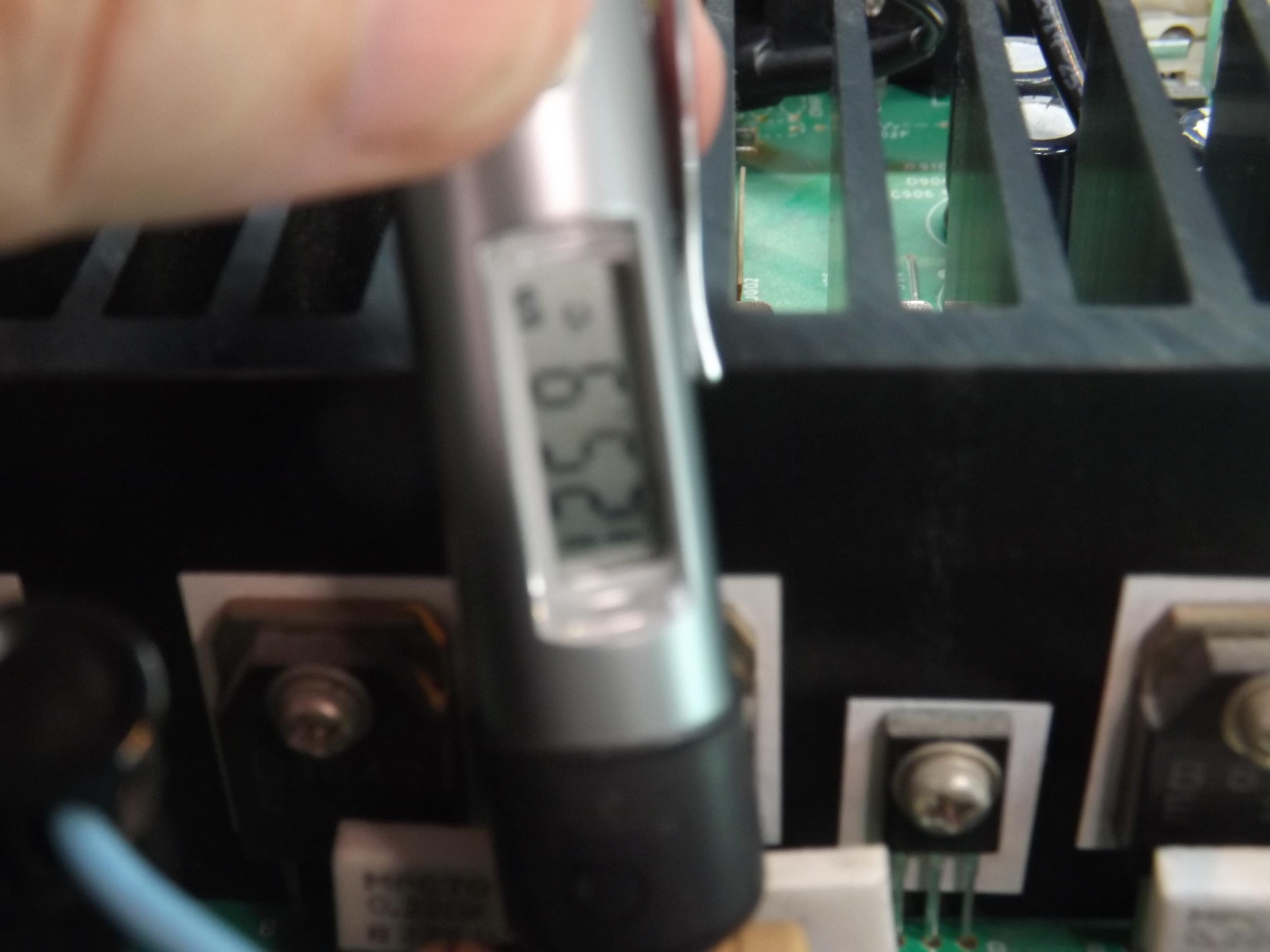

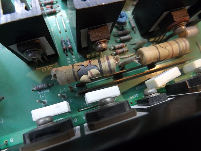

Thirdly, am I right that the power resistors R641-644 get very hot? The ones in e.g. the RA-940/960BX definitely do (126 degC), see enclosed pics. And they fry the pcb and all surrounding componets. So, in the RA-980BX Rotel removed them and reverted to the more straightforward 47 Ohms 0.5W between the two Q623/625 driver emitters. Works as a treat and stops global warming.
Remember to cover the 47 R’s in a insulating sleeve to avoid accidental shorts if mounted on the pcb track side.

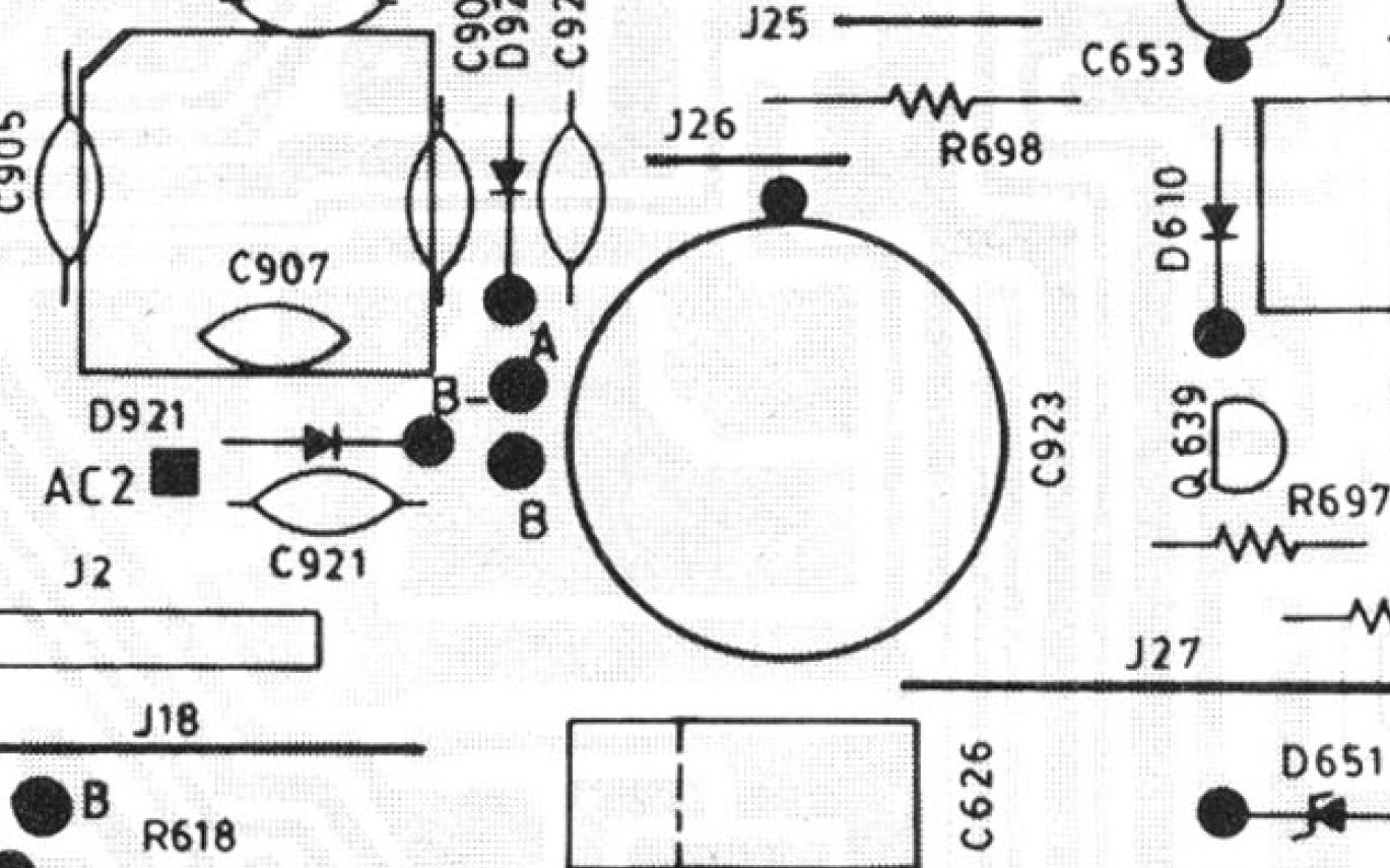

I just noticed that strange connection. But is it actually connected like that on the pcb, or is it just a mistake in the schematic?
Anyway, the RC filter caps should go to ground and so you may have to re-position the negative pin of C621 to that effect.

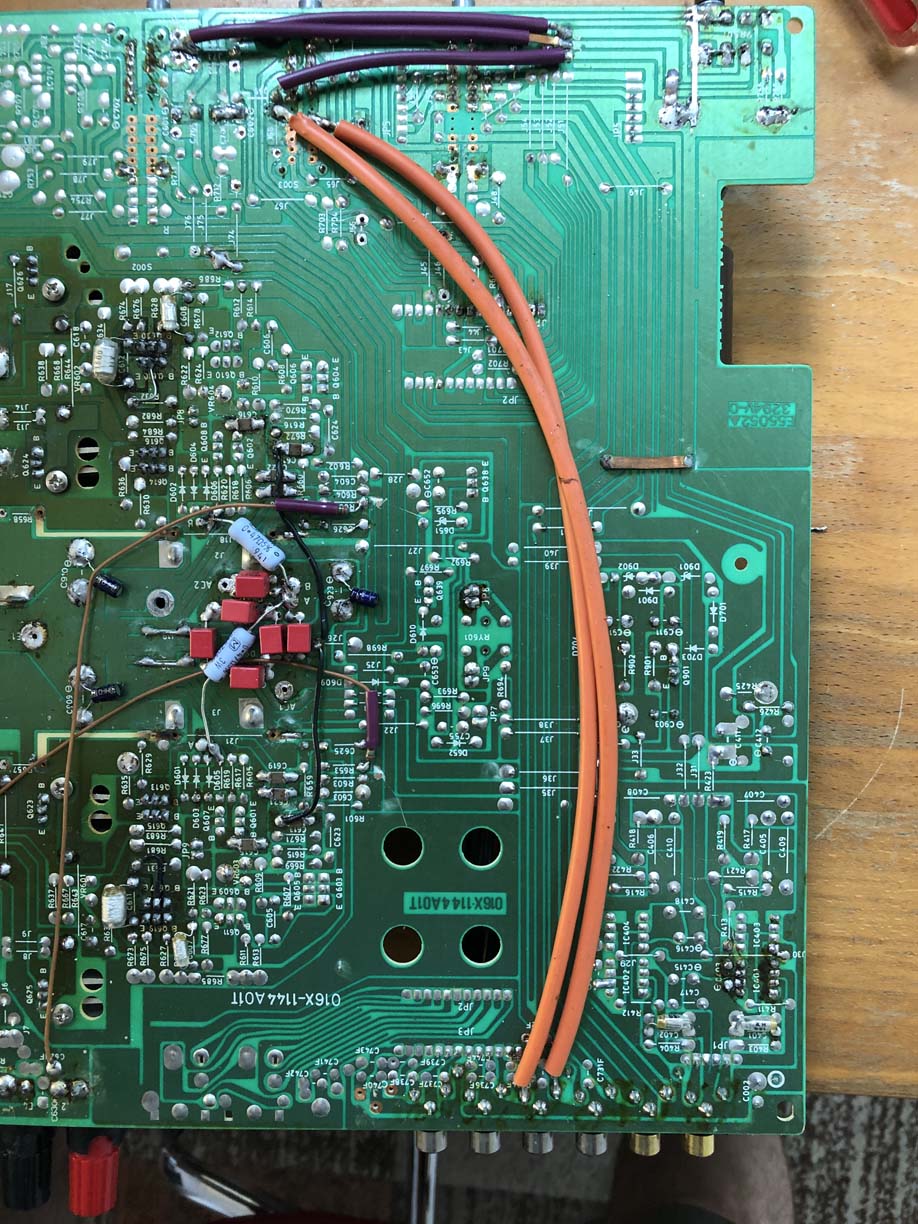

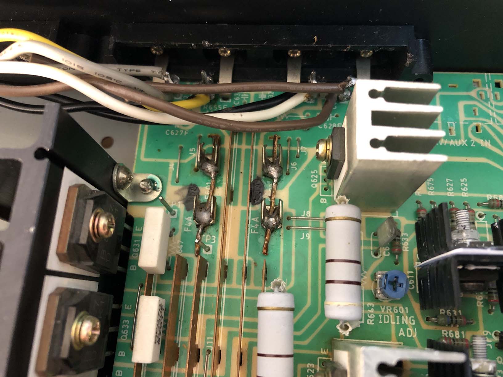

No need to cut the tracks to insert the 100R resistors... the B+ is fed via two wires (A and B) to pre-amp section. Just insert the resistors in series.
It would be nice to hear of any positive outcome of this mod.... the ripple should drop substantially to less than 10mV.
Yes, I can confirm this connection is true to the PCB. I'll try to move C621 to ground and solder electrolytics in parallel.

As Extreme_Boky noted, it's possible to put these resistor in series with feeding wire. A proper mounting on a PCB is almost impossible due to limited space.
Yes, they do! I replaced original 2W with 5W metallised although it didn't improve temps - they still ruining at about 115 degC
I guess they will then lay on the solder side of the pcb? Please do secure them down with a silicone or other glue if you can. For the 1uF's you could use red WIMA MKS2's - then you don't have to worry about which way they go in.
Have a look at e.g. the RA-980BX schematic, where they (re-)placed a 47R (R641) between the Q623/625 driver emitters instead of these 1k/5W dropping resistors.
It works just as fine and greatly reduces the heat inside the box.

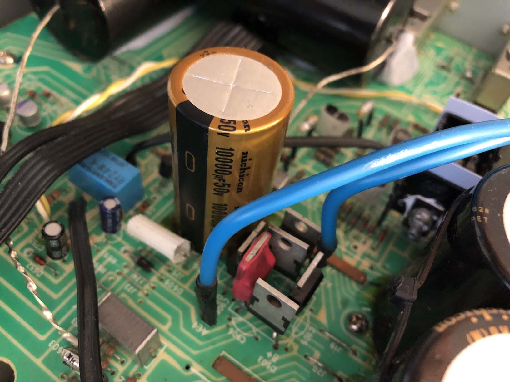

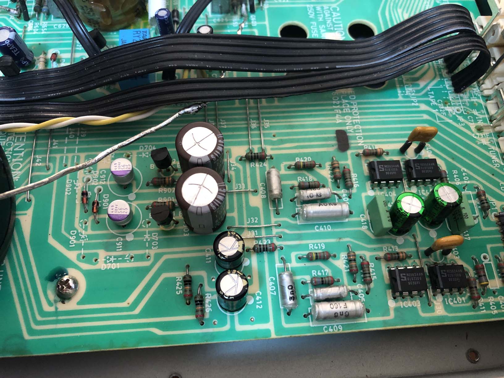

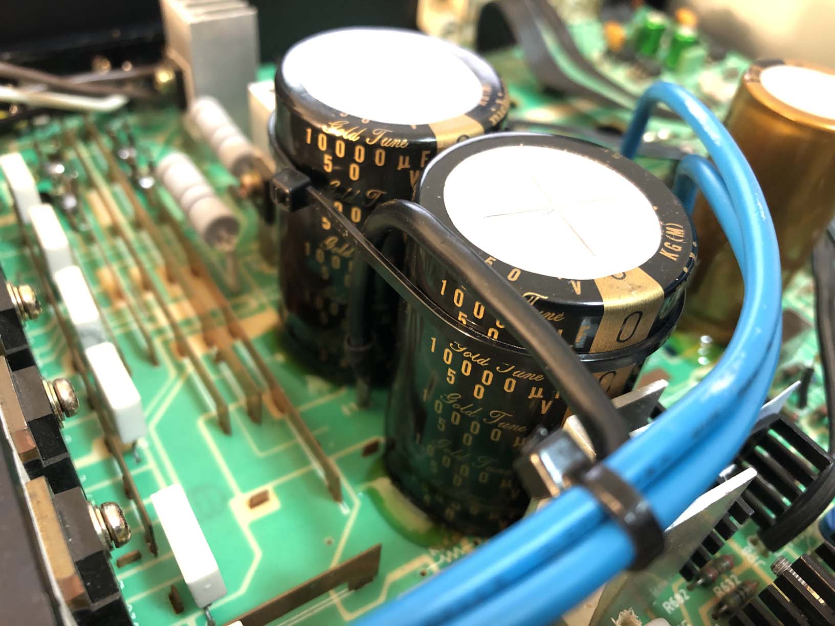

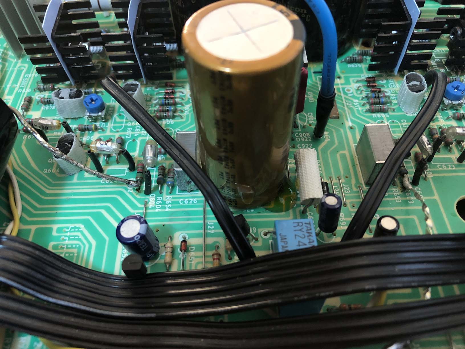

Mod no 1. C909, C910 and C923 changed to new ones
For those specific parts I chose Samwha HE series, two 10000uF (an upgrade from 8200uF) and 4700 uF accordingly. My decision was dictated by cost, availability and spec (ripple current, ESR, dimensions). Fun fact, famous Orange Amplification puts Samwha caps in their 1800 GBP bass tube amps. Also my friend who works in the automation industry swears for them. They seem to be decent caps, despite bad reputation.
Original Nichicons were manufactured in 1990 and about 15-20% off. It was the time for them to go.
When I first listened to the amp with new main filter caps it sounded terrible! Lost all the bass and was predominated by harsh high-mids. Things got better after couple hours though, but I felt not much of a difference before and after caps replacement.
Also THD was showing me I was right. Maybe if I pushed the amp louder and hit a lower note during measurement the difference would be more visible.
Mod no. 2. Black Gates 10uF/50V preamp coupling electrolytes to WIMA MKS 10uF/50V
I also replaced Elna RE2 470uF/25V from the IC regs to BCcomponents 136 KO 470uF/25V.
Oh boy! The amp started to sing, literally. Every aspect of the sound became much better, more real, transparent, clear, you name it. I suddenly felt great bass extension and punch, so much I turned off the tone circuit. Even though I keep tone knobs at noon, the baxandall circuit adds something at both ends of audio band.
I was extremely happy with the result but THD stayed unchanged (again, flawed setup could contribute)

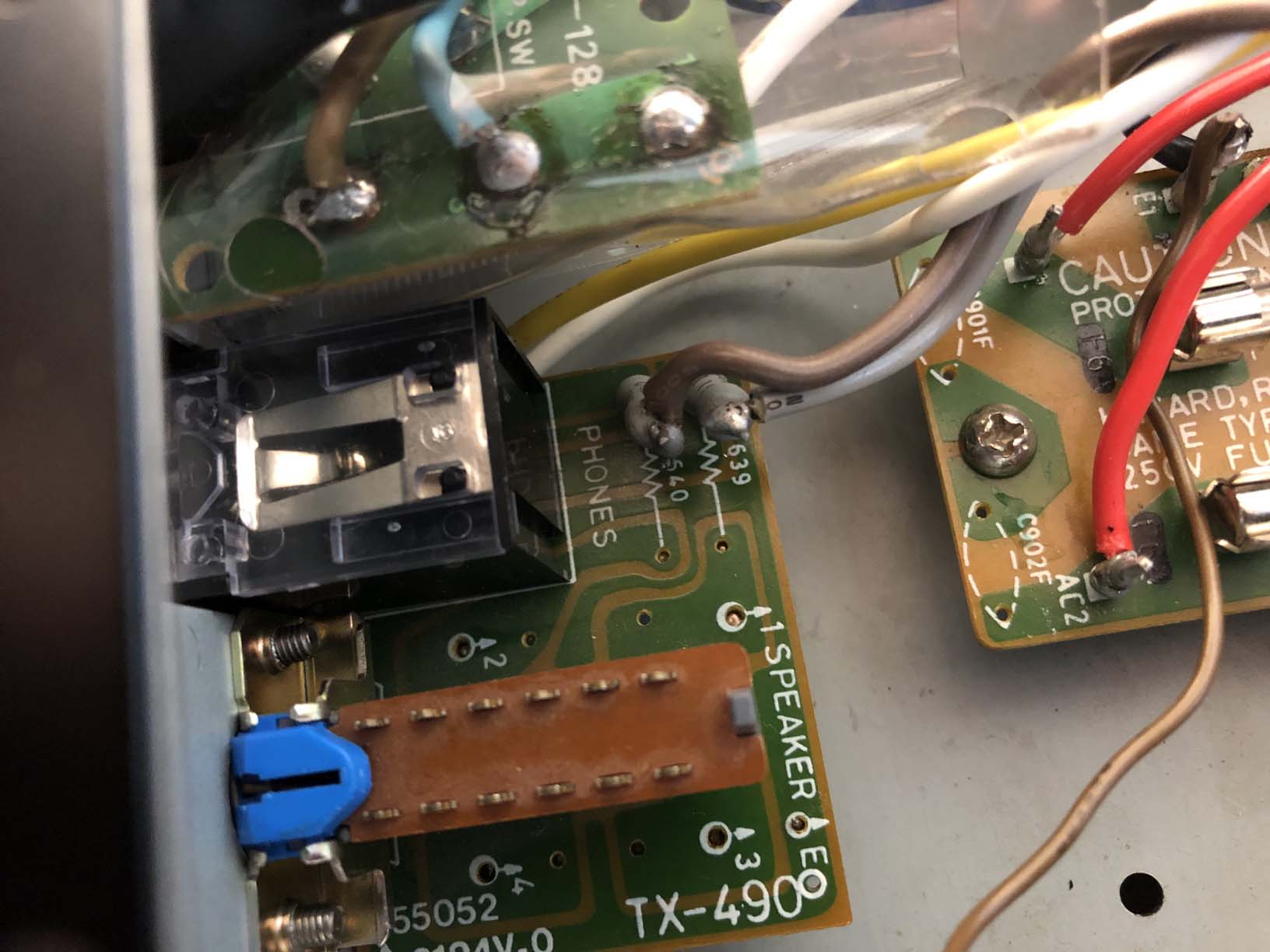

BTW. there are lots of unused holes for caps and resistors, at every terminal that goes to the rear panel, also for zobel network.

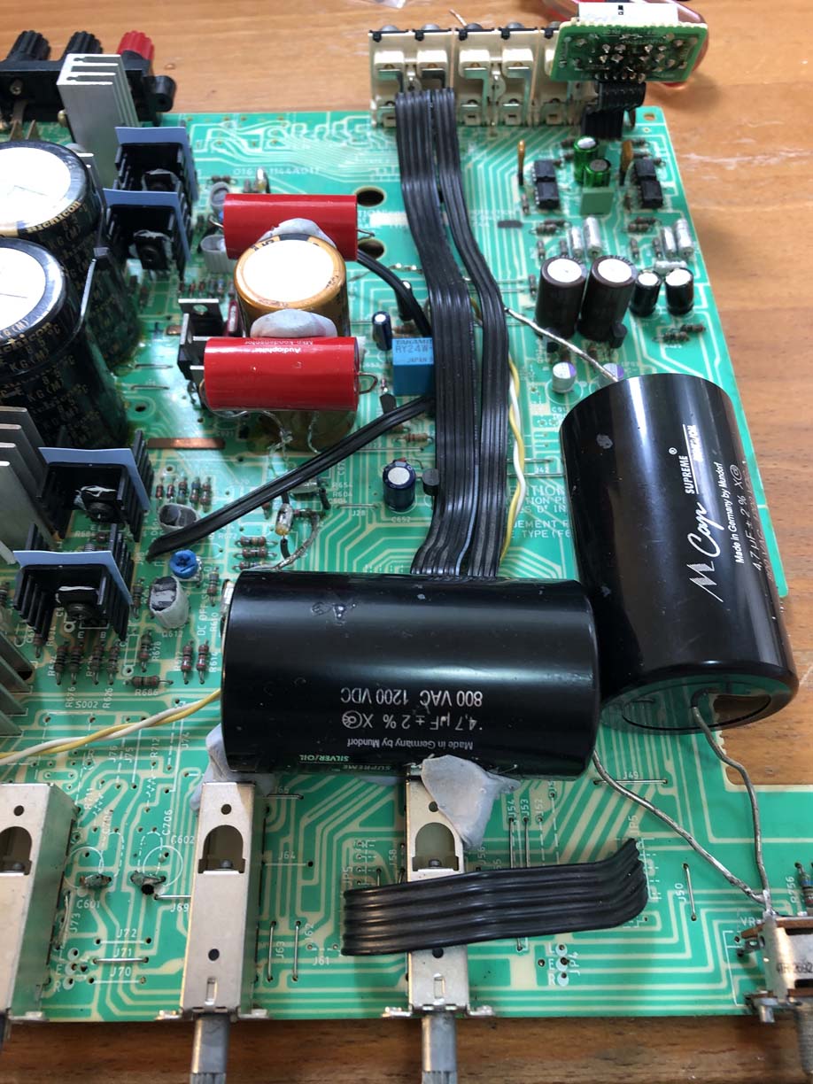

It sounds absolutely brilliant, but I modified the living thing out of it... again, just for fun.
I will try to list everything I did to it:
1. The mains transformer was wired for 240V, I live in a country that uses 240V mains. So, to increase the DC rails (from around 32V initially), I wired the 220V transformer primary tap to 240V mains. Now I have DC rails sitting at 36V DC. The output power at the onset of clipping @ 6 ohms is 84W (!!!). The amp keeps this power across the full audio spectrum, which is an outstanding result.

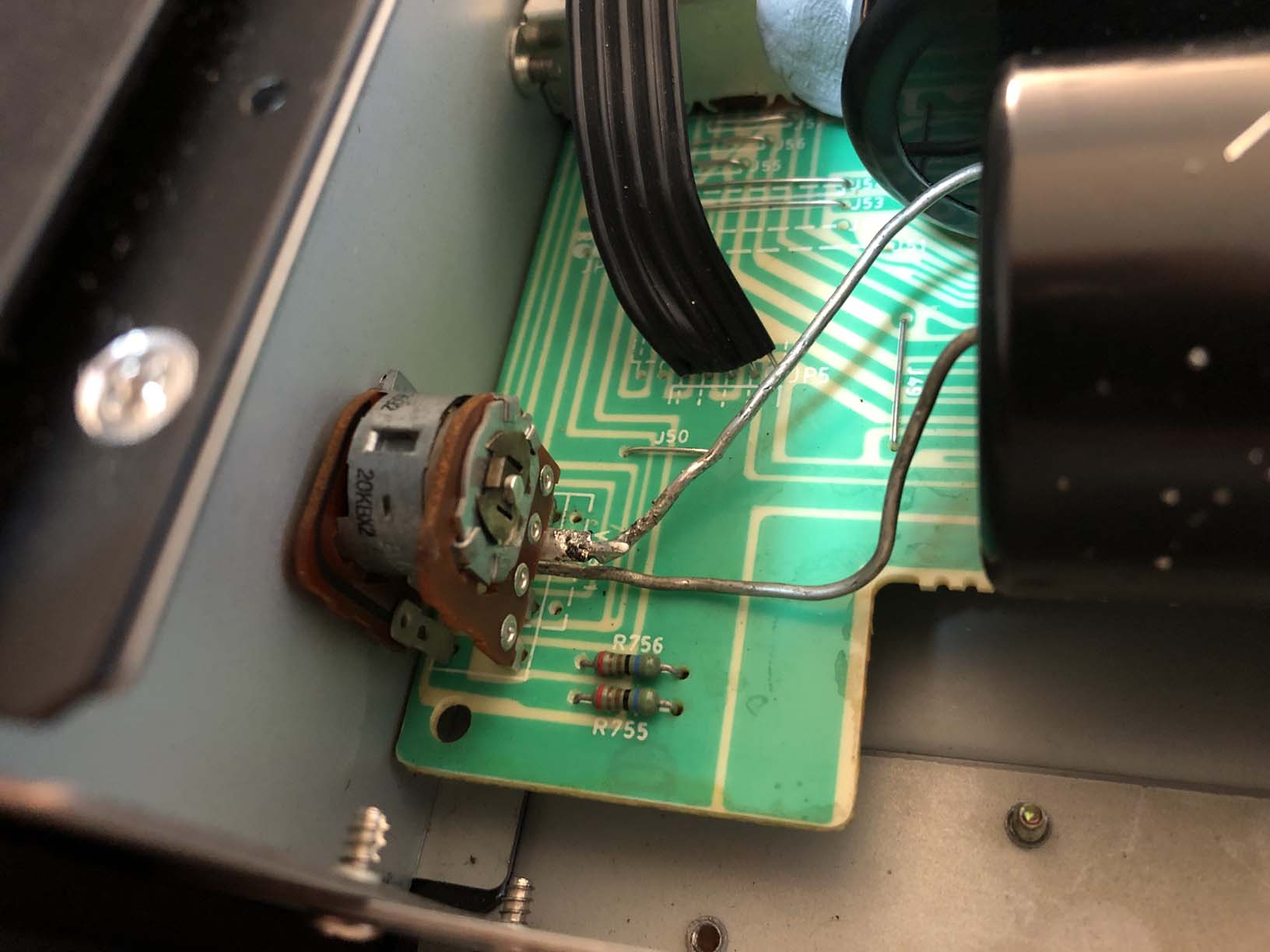

2. The TAPE IN input is routed via least amount of input switching, so I used this input to do one of my favourite mods - cut the tracks to remove inductance/impedance caused by the PCB, and wire everything point-to-point, using a combination of pure silver and pure copper ribbon cables. The unused, floating PCB tracks (all of them - those ones that came floating from the factory because there's no tone controls) are brought to a ground potential.
3. The sound coupling capacitors (I think they were BlackGates 10uF) are now Mundorf silver-in-oil. I know, an overkill, but I am not using them any more because I like AuriCaps XO better... so I had a spare pair of Mundorfs I pulled out from another amp
4. The bridge rectifier, and the two diodes that are used to create B+ for the pre-amp section, are now all discrete fast switching/soft recovery diodes, dampened by 0.01uF WIMA MKPs.
5. The remaining 0.1uF decoupling caps (used to be film types, a total of 8) are now SMD devices

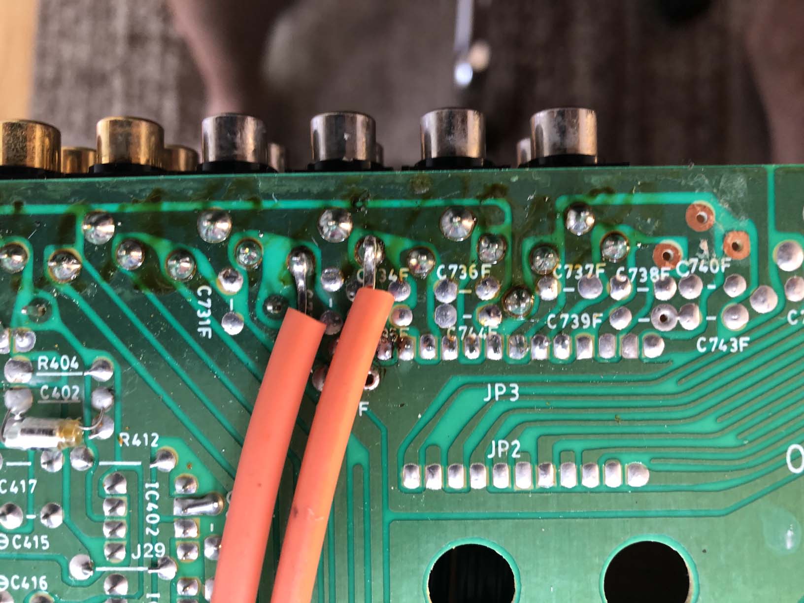

6. The pick-up point for the negative feedback is now right at the speaker binding posts (at the correct point, i.e. at the amplifier output)
7. The voltage regulators for MM/MC stage is decoupled by my favourite combo: Panasonic SEPF / Elna Silmic II. It sounds really good and is dead-quiet.
8. The current mirror / pre-VAS & VAS transistors have received little heatsinks. They were running so hot that the PCB underneath has almost burnt.
9. The volume pot wiper is connected straight to Mundorfs (no PCB tracks)
10. The other side of Mundorfs goes straight to the IN of the amplifier (again, no PCB tracks)
11. DC and B+ filtering caps are now Nichicons
12. The fuses in series with the speaker outputs are now gone...
13. The B+ voltage rail to the pre-amp section is now wired via Panasonic 0.47ohm 3W resistors, point-to-point.
14. Ground uniformity improvements are done across the whole PCB
15. The headphone wiring goes straight to the jack, the speaker "remote" switch is not in use any more, all pins brought to ground potential.
16. The bypass caps, across Nichicons, are BlackGate NX types, 0.1uF (20 bucks a pop on eBay, NOS...!!!)
...and one that could be of real importance to everyone who complained about "weak bass"...

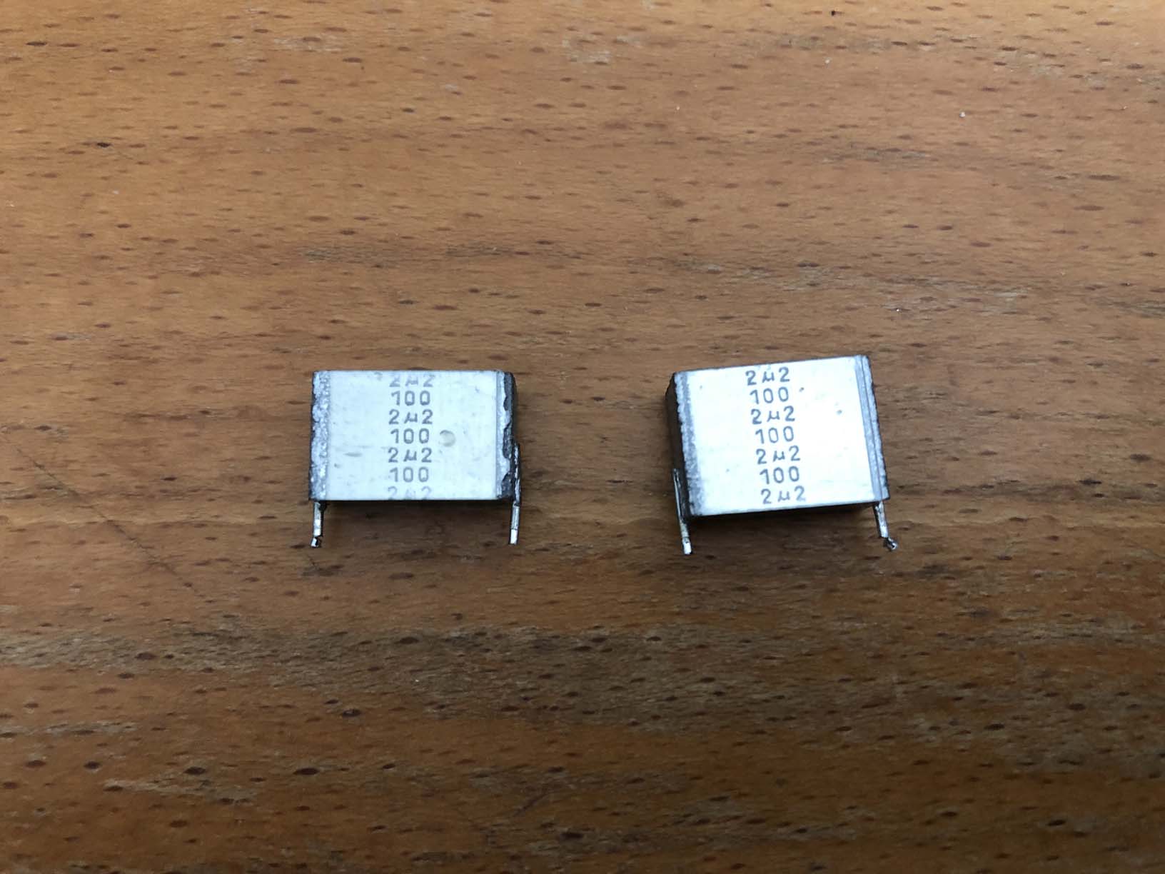

...17. The truly terrible sound-coupling feedback milar 2.2uF caps are now nice film types: Audiophyler Mundorfs. This brings life back, bass definition... simply beautiful. I actually soldered nice short silver ribbons to the PCB, and will play with capacitors' type and value to fine-tune the sound.... maybe... because the amp sounds already bloody marvellous with Audiophylers.
Sound..?? Drives the hell out of my Dynaudios with a very natural presentation, wide soundstage, beautifull highs. Very very nice.
... more photos🙂
Do you have any FFT plots before and after? How do you feel about this mod? Can you hear a difference? Why MKP instead of ceramics?
Ceramics? What type? What's your opinion on this?
I did this as well a couple of years ago, it was my first modification and I never looked back. The improvement is significant, at least in my system. A fuse in audio signal path is bad, especially if it's outside the feedback loop!
Wow, this is truly interesting. I felt the same difference when I bypassed output fuses. And then after switching from electrolytic coupling caps to polyester Wimas. Since this feedback cap is already a polyester, I'd never thought a polyprypelyne can improve things in such dramatic way.
The latest ripple figures are 5mV on pre-amp rails (a drop from 7mV... I "blame" the 0.47ohm / 3W resistors for this🙂), 70mV (no change) on main amplifier rails.
The fast switching/soft recovery diodes is a routine mod I do... I did mods in stages, this being one of them. The sound was more relaxed, better flowing, more space and better high extension. The WIMA's are not necessary, but I do like what they do to the sound, in combination with no PCB tracks' inductance/capacitance on TAPE IN, and silver ribbons used instead. Also, the Nichicons are quite revealing (bright?). No plots.
0.1uF / 100V MLC capacitors, P/N: 80-C1812C104J1G... there are not many NPO (COG) caps in such high value (0.1uF), but this is one of them!!!... a great sounding cap. The story here is... the original green polyester caps were replaced with WIMA 0.1uF / 250V MKP's but I did not like the sound... too soft and no extension. So, I went all the way to the other end and used MLC's - COG. Excellent result, very quiet background and great extension/speed. Might be too much... but this depends on the rest of the system and personal preferences.
The mylar 2.2uF / 100V is where you can tune the sound to your liking, "externally", without too much hassle... Install little wires and keep playing with different capacitor types until you find one that you like / that blends nicely with the rest of your system.
