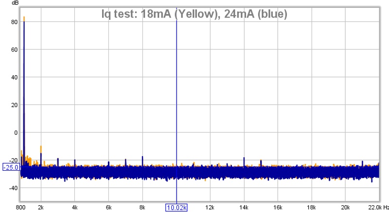

I have had a further look into the Vbe multiplier circuit.
Having found no effect of introducing a capacitor bypass around it, I looked at the quiescent current setting, as it has been proposed that the standard 4mV bias setting (giving an Iq of 18mA in the output transistor pair) is really too low.
And there could be some truth in that. The enclosed pic shows the distortion RTA of an upgraded Rotel. Even though the standard 4mV setting only gives distortion peaks a few dB over the respectable -105dB noise floor, increasing the Iq to 24mA actually reduces the dominant 2nd harmonic and thus the overall THD - albeit not by much - 0.0039 to 0.0033.
So, what if we increase the Iq even more to try to drive the output stage further into class A?
Well, there is no free lunch.
The list below shows the corresponding figures for:
bias mV setting - quiescent current - power dissipation - heatsink temperature and distortion:
4mV - 18mA - 1.4W - 30C - 0.0039%
5mV - 24mA - 1.7W - 32C - 0.0033%
6mV - 27mA - 2.1W - 35C - 0.0032%
7mV - 32mA - 2.4W - 38C - 0.0031%
8mV - 36mA - 2.8W - 42C - 0.0034%
Over 36mA the 5th to 9th harmonic distortion peaks start to rise sharply, indicating that something else than crossover distortion is afoot. And, the small internal Rotel heatsink of course gets increasingly warmer - maybe not alarmingly, but clearly there is no reason to run it hotter than needed.
So, as a first compromise I decided to set the (cold) bias to 6mV, only to find that after about one hour of operation it had slipped back to just over 5mV. I guess that this means that Curtis' original thermal stability design is basically sound, which is good news. And I can definitely live with the result - and the sound!!
