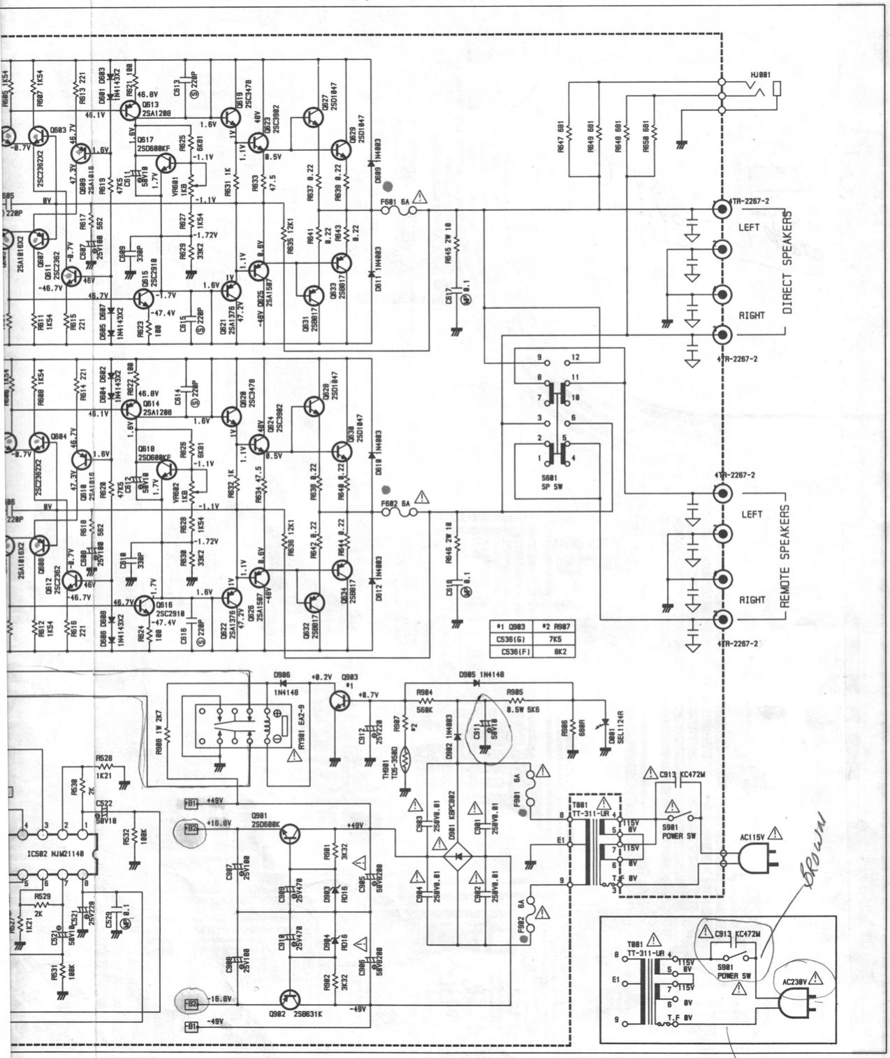

Hi Angelp,
i have a rotel ra-970bx. in complex music passage it is muddy and in midrange it lacks . i have the schematic. can you suggest the mods to improve the sound quality?
Hi Suresh
It is very difficult to diagnose and/or suggest improvements over the web, not knowing what the real problem could be, the level of electronic competence you are at and what test equipment you have at hand.
It is all too easy to do severe damage to the amp, the speakers (or indeed to yourself) by small, silly mod attempt mistakes. Been there, done all that (but please don't tell anyone I said so😉).
The first thing you could do, however, is to measure the DC level on the speaker terminals (should be much less than 60-80mV with min volume setting). If not - you'll need a repair before any mod. Then, I would suggest getting in touch with jpc2001 for pics and advice as he is currently doing exactly the same work as you look for on his RA-970. I have never modded this model.
Per
my amp doesnt have any problem and offset is well below 30mv. i have multimeter and oscilloscope and i am an electronic engineer. all i want to try and improve the sound . i was expecting some mod on compensation schemes. ra-970bx uses shunt compensation instead of miller . by removing shunt and placing miller will help improve the sound quality?

Hi Suresh,
Thank you for clarifying that, it seems that we are on the same level. I hope you appreciate the need for caution on advising on these matters.
But as I said, I have never modded a 970 and just looking at the schematics some investigation of the real amp is needed. It seems that there are shorts between the Q619/621 driver bases to the rails - that simply can't be so, nothing would work.
Anyway, take it step by step - for a quick first mod I would suggest putting in 100 E / 100uF 63V rail filters as jpc did and then measure/listen. Then consider the ground star issues and the reservoir caps. Here again the schematic says 8,200uF / 50V - if this is actually true - this is much too close for comfort with 49V rails and I would replace with 63V rated 10,000uF's.
This should firm things up and then we can look towards changes in the VAS configuration.
Happy modding!
Per
