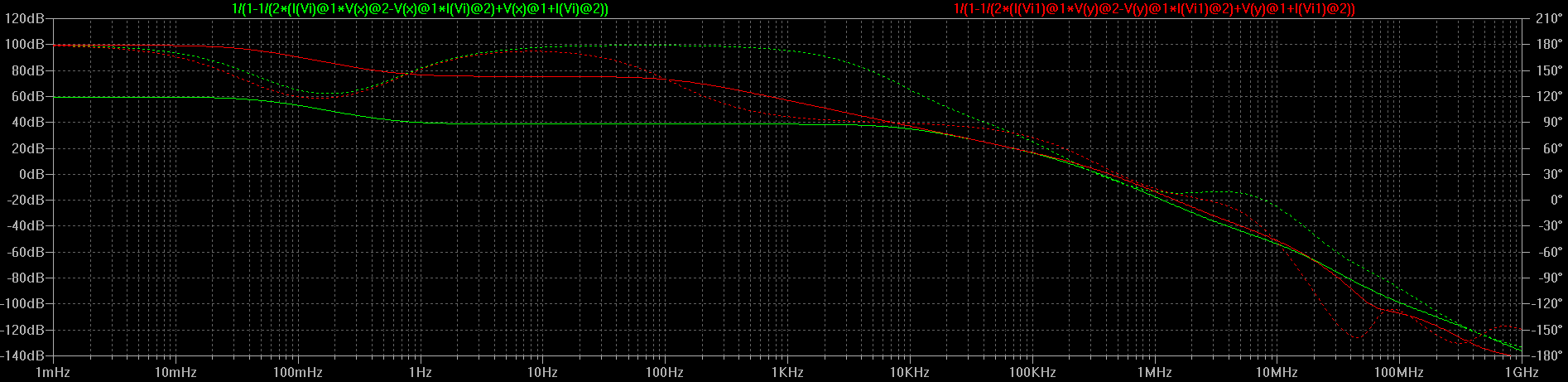

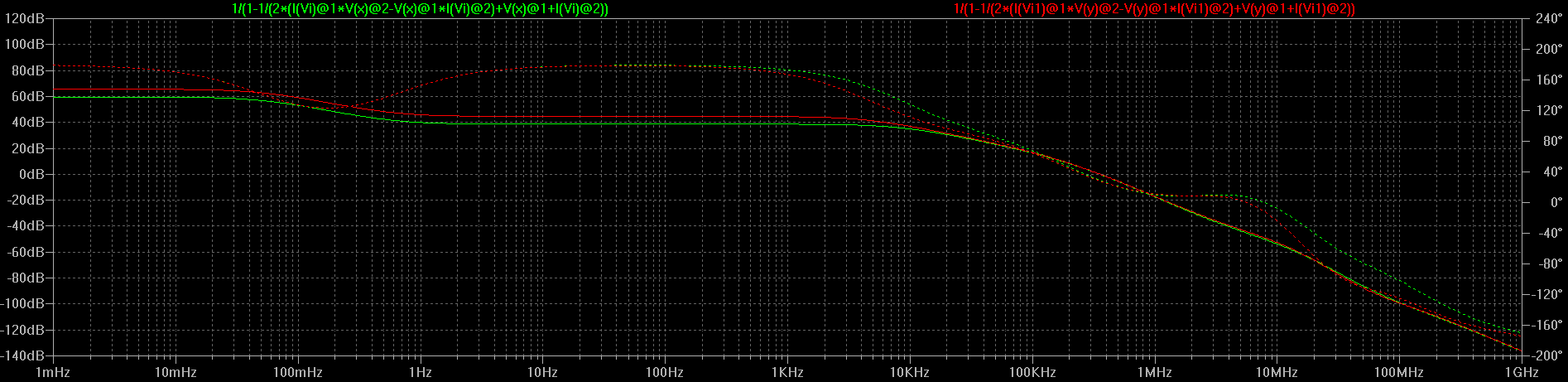

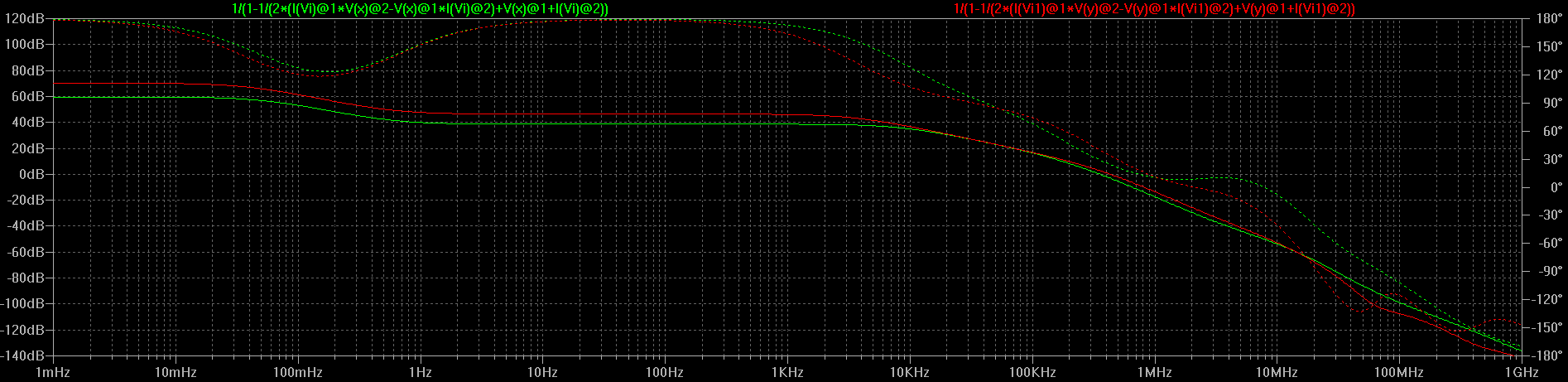

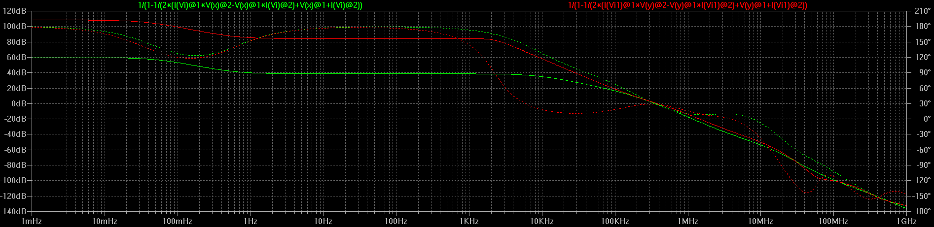

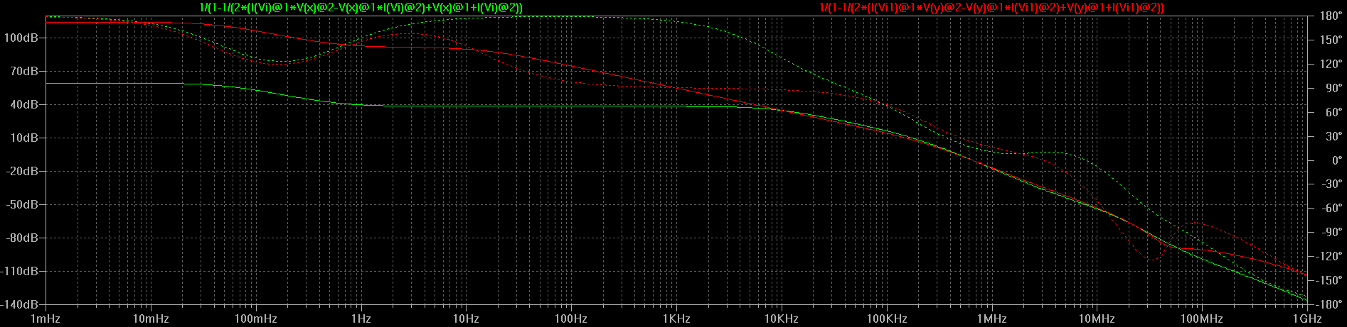

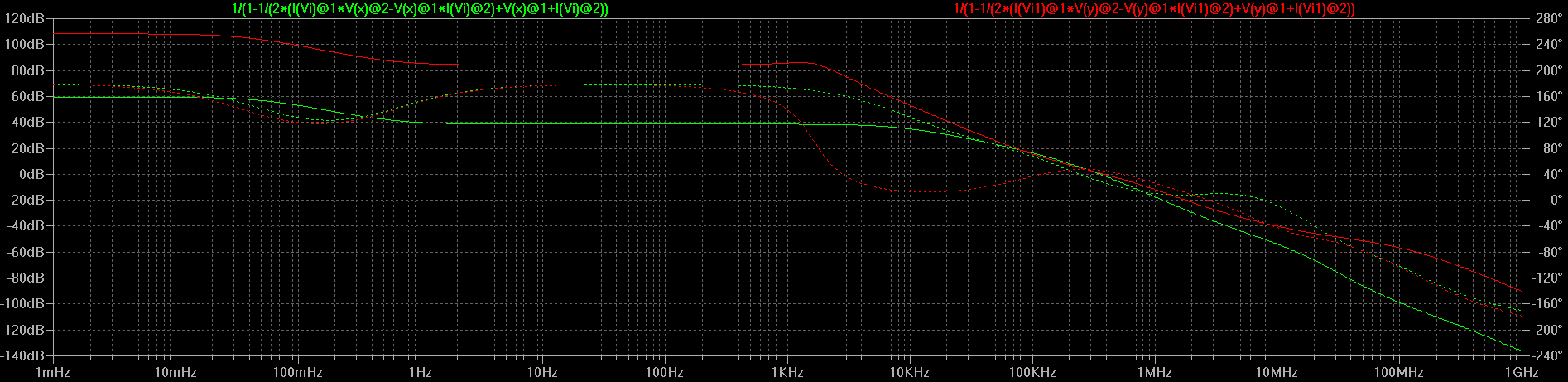

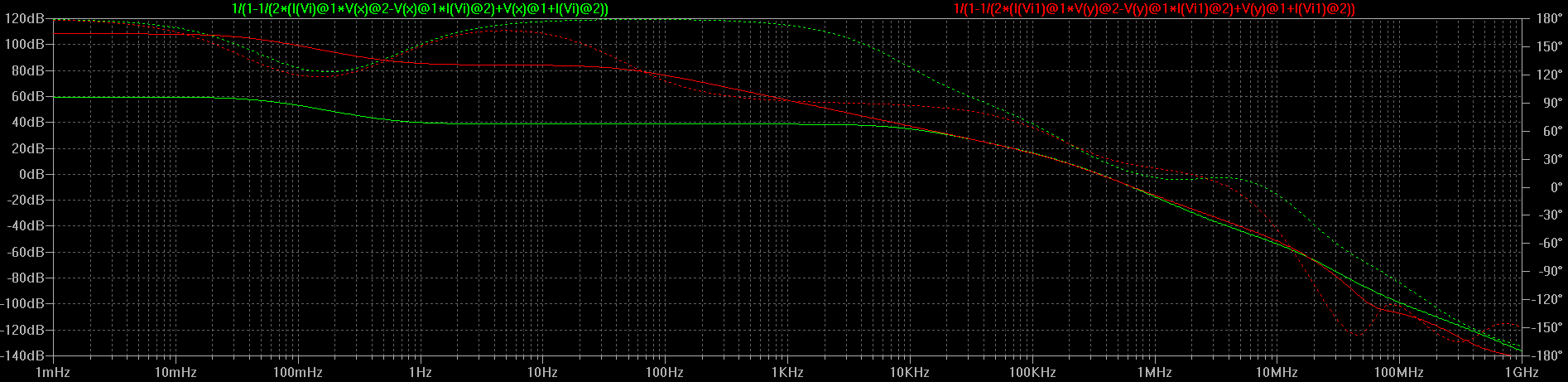

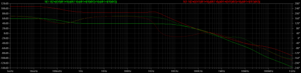

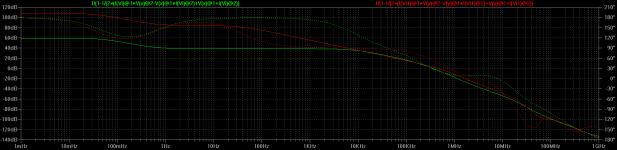

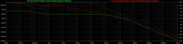

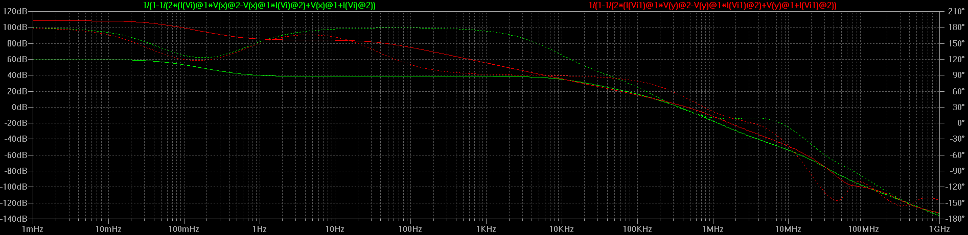

Ok, here goes. TL/DR summary at the end. I attach below the asc file for the last mod stage, TMC, so you can easily modify it by removing stuff to get any of the previous ones. Note that to get a well-behaved FFT you need to make the input and feedback caps very large (hence their values), otherwise you get a "slanted" noise floor that may hide some of the harmonics. SR and overshoot were measured by changing the voltage source to a step and measuring on the resulting response. The 1.2 amplitude value was chosen to simulate ~30W/8ohm output (don't forget that in LTSpice the amplitude corresponds to Vpeak, so you have to do the numbers to convert from RMS).
Since we're dealing with many variables for the IPS, VAS and compensation schemes, these are just some of the many combinations that you can have, feel free to try your own modifying the attached files. Some of the choices I've made to keep the number of options manageable:
- As explained in post #188, I've left Rin = 47k and increased the feedback resistors to 47k/2k7 for DC balance.
- The 150p cap next to the lower driver is always in (except in the simulation of Per's mod). Removing it doesn't have a big impact on loop gain shape or THD.
- The CM degeneration resistors are 43R to get a voltage drop of 30mV. Self recommends 30-60mV in the context of discrete CMs; since I'm using dual matched pairs (2SC2291) I assume that it's safe to go with the lower value here.
- Rdeg for the differential pair are 330R which gives a typical 10:1 degeneration ratio as recommended by Cordell and others.
- I stick throughout with the original LTP tail current of ~1.4mA.
- In the stock non-UK version of the amplifier (the one I have), as well as the shunt VAS compensation there's a Cdom = 10p cap. In the early mod stages this is the one I adjust to keep a roll-off shape and UGF as close as possible to the original (post #193 above explains why I think this is a good idea).
Here's a summary of the results and below plots of the loop gain of each stage vs. stock (please excuse the funny stage numbering):
- Stock:
PM = 29deg @ 355kHz, THD @ 1kHz = 0.00406%, SR = 9.5V/us, Overshoot = 4%
- Stage 1a: IPS CM load, 330R degeneration, Cdom = 15p, stock VAS load
PM = 34deg @ 428kHz, THD @ 1kHz = 0.00865%, SR = 9.5V/us, Overshoot = 7.4%
Twice the THD as stock, even though OLG @ 1kHz has increased by ~7dB? Hmm... After some head-scratching, I think what's going on is that the CM doesn't like the small voltage drop across it with the simple VAS: Vce for the left hand CM transistor is ~1V and it may like a higher voltage to work properly. Note that in fact current balance in the differential pair isn't any better than stock (offset is actually worse, ~25mV vs ~11mV). I could have played with Re in the VAS to increase the voltage drop but I didn't want to introduce another variable.
- Stage 1b: IPS Rload = 2k4, Cdom = 22p, EF-VAS, stock VAS load
PM = 28deg @ 355kHz, THD @ 1kHz = 0.00198%, SR = 9.3V/us, Overshoot = 3.4%
Note that to keep balance the Rload has to be increased to 2k4 to account for the extra Vbe drop. EF-VAS shows its benefits: half the stock THD.
- Stage 2: IPS CM load, 330R degeneration, Cdom = 15p, EF-VAS, stock VAS load
PM = 34deg @ 428kHz, THD @ 1kHz = 0.00096%, SR = 9.5V/us, Overshoot = 7.4%
Bingo: now adding CM load and degeneration to the EF-VAS gets us to 1/4th of the stock THD. Vce for the left hand CM transistor is now up by one Vbe to ~1.6V, as expected, differential pair current balance is significantly better (714/721uA vs. 741/694uA) and offset down from 11mV to -3.3mV, so it seems that the extra voltage is just what the CM needed to work optimally.
For all remaining stages, this combination of IPS+CM+degeneration and EF-VAS stays, stock VAS load is removed and only compensation varies:
- Stage 3a: Miller-only comp., Cdom = 27p
PM = 46.7deg @ 448kHz, THD @ 1kHz = 0.00095%, SR = 19.8V/us, Overshoot = 8.9%
No significant change in THD, which is a bit strange since the load on the VAS is much lighter now. Maybe that's something that doesn't simulate well. We have twice the SR and although the PM is higher we also have more overshoot.
- Stage 3b: lead-lag comp., VAS load = 330p to ground and 220R + 560p to ground (as in Rotel RB-1050), Cdom = 22p
PM = 35.1deg @ 366kHz, THD @ 1kHz = 0.00096%, SR = 5.2V/us, Overshoot = 8.1%
I've taken the component values straight from the RB-1050 schematic and again adjusted Cdom, so it's more of a "hybrid" Miller + shunt + lead-lag compensation. THD is as good as Miller only, but this time half the SR as stock. Obviously we're throwing out of the window the SR advantage of the CM by making the poor VAS drag its feet.
- Stage 3c: TPC, C1 = 330p, C2 = 33p, R = 2k2
PM = 28.5deg @ 378kHz, THD @ 1kHz = 0.00014%, SR = 19.6V/us, Overshoot = 27.9%
I went with C1 >> C2 because that's how Self does it and his reasons (lighter VAS load) are persuasive. THD down to 1/40th of stock, impressive, but the marginal PM and especially that worrying phase dip before reaching it could be the cause of the huge overshoot. Looks like stability could be *very* conditional here...
- Stage 3d: TMC, C1 = 47p, C2 = 470p, R = 2k2
PM = 45.2deg @ 390kHz, THD @ 1kHz = 0.00016%, SR = 18.7V/us, Overshoot = 1.2%
In this case I went with C1 << C2 after Cordell (for TMC Self uses C1 = C2), although his ratio is ~4:1 rather than the 10:1 I use here, but that's how I could match the stock roll-off best. Looks like we have a winner: equally impressive THD and similar SR as TPC but a much healthier PM and barely any overshoot. Note that this is despite having that same phase dip before UGF as TPC as you can see in the plot, so either my previous comment is incorrect or there's something else going on that makes the dip not matter as much (or not at all) with this arrangement. Note also how the loop gain departs from stock after the UGF. It looks like we're introducing zeros that may in fact be beneficial to compensate some of the HF poles, but it's up there where I'm cautious about trusting the simulation too much, so handle with care. Interesting also that Cordell claims that, unlike TPC, TMC doesn't introduce any peaking in the loop gain response: I do get it in simulation and in fact with TPC I don't get any, though I did with other cap values that I tried.
- Per's latest: CM, no degen, EF-VAS, Cdom = 100p, VAS load = 33p, 150p cap removed (I've left the tail biasing as stock for consistency with the other sims)
PM = 37.9deg @ 334kHz, THD @ 1kHz = 0.00048%, SR = 12.8V/us, Overshoot = 2.5%
Another winner here in all respects: 1/10th of stock THD (he got better THD+N results but don't forget that we're simulating different transistors here and he dealt with supply ripple as well), better SR, very little overshoot and, unlike all the others, tried and tested!
TL/DR summary: the usual disclaimers of simulation apply, more so in this case where we're using different transistors and a perfectly matched differential pair. The combination of CM load, degeneration and EF-VAS looks like a no-brainer: THD down to 1/4th even with the stock VAS loading, which if you replace with simple Miller comp (stage 3a) you get twice the SR and probably a further THD reduction that the simulation doesn't show for some reason. Lead-lag (stage 3b) looks like a step back, TPC (stage 3c) could be trouble stability-wise and TMC (stage 3d) looks too good to be true: 1/40th (!) the stock THD and excellent stability on paper, though things may be different in reality. Finally, if you want to play it safe rather than try your own thing, do what Per did (see post #119 for his latest version) and enjoy the "Blameless Rotel"! 😉

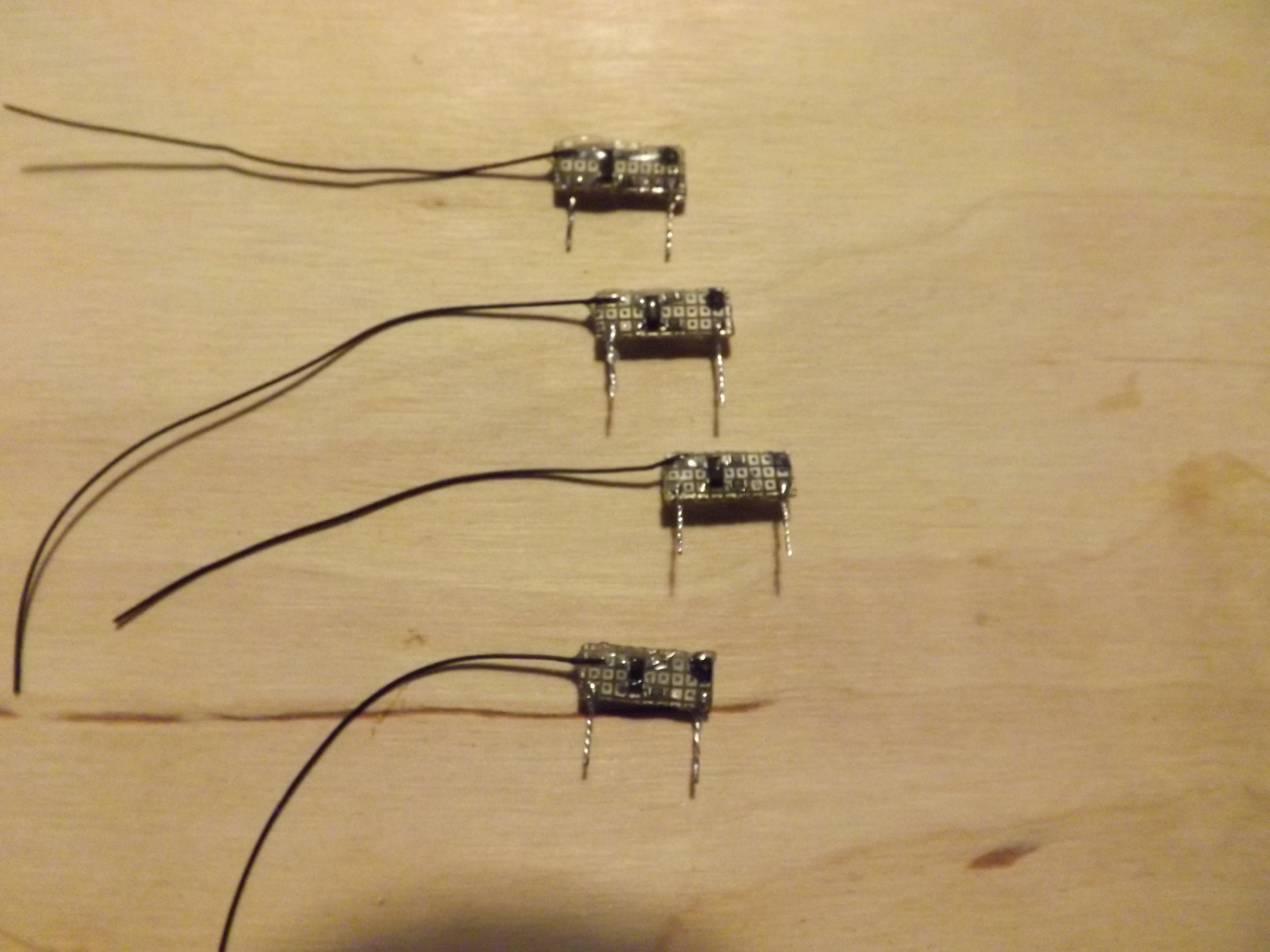

I got the current mirror sorted, moving on to the EF-VAS, are there any suggestions for a prime choice SMD VAS transistor?

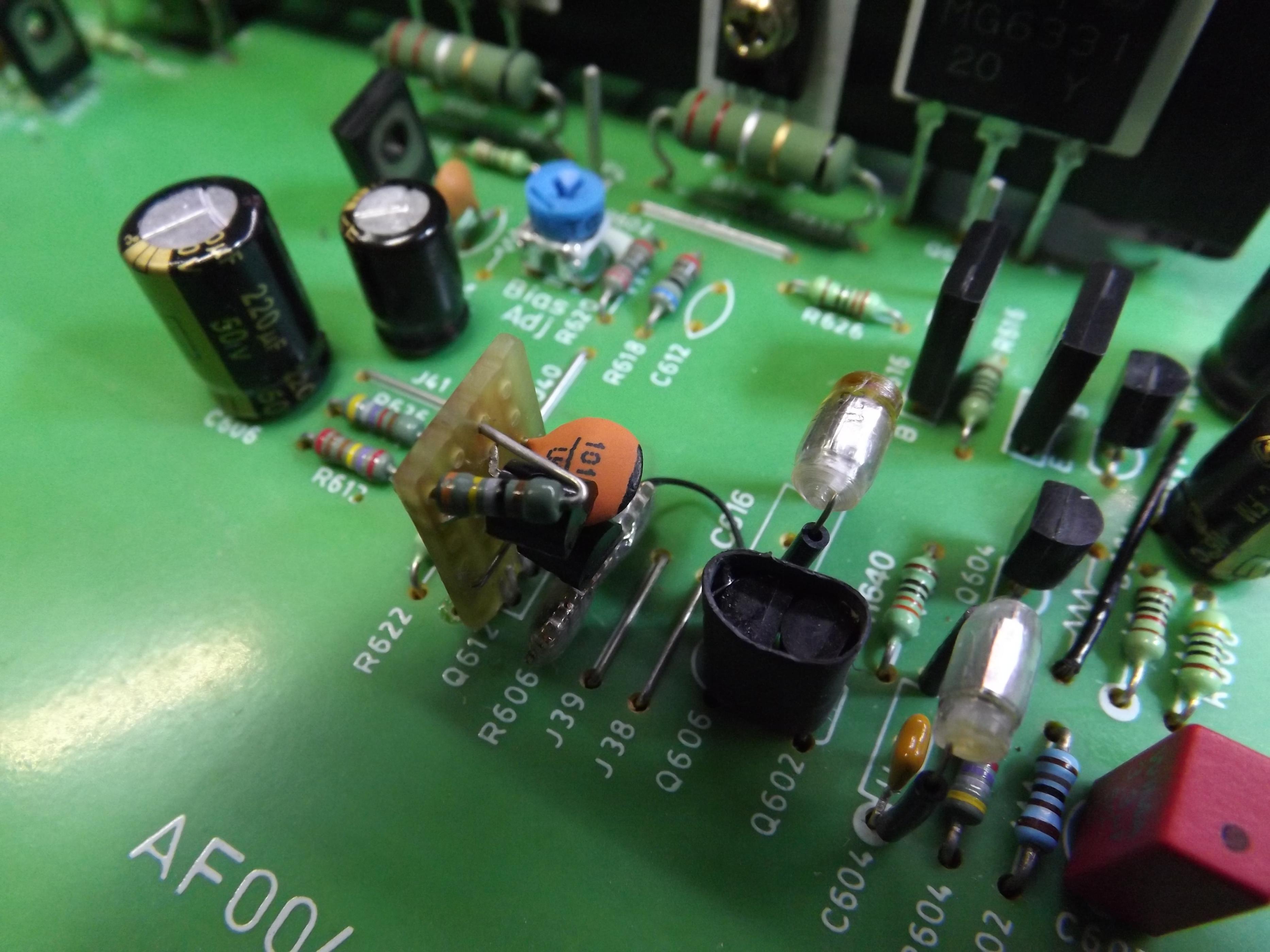

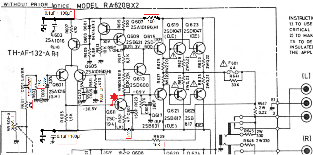

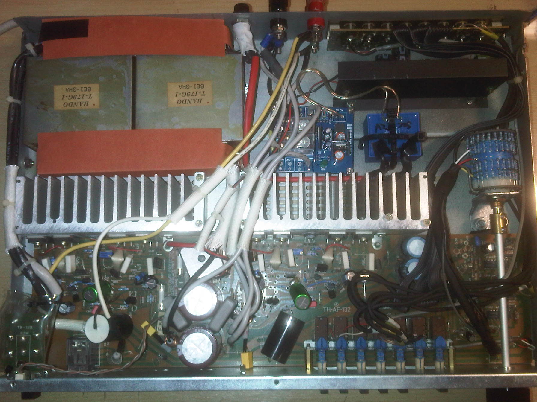

Hi everyone,
As I've currently taken up modding of the RA820BX2 again. The picture I've attatched shows the current state. A few more holes found their way into the amp for this, but this time it was the pcb's turn. Not shown are the Stage 1 mods (replacement of diodes D301-304 as per Per [whom I can't thank enough, btw
]) and the speaker protection circuit (that also protects the headphone-jack).
The red star is the position of the 10pF cap wich is missing from the BX2 (C611 here was a curious case of not beeing noted on the pcb but shortened itself to ground in the schematics - I ommitted it from the picture). Would the addition of this cap help stability?
Once Stage 2 (cascoding of Q603, here) is complete and I've got the zobel and inductor in, I'll post some pictures of the insides of the RA820BX2 - with all the "goodies" (stepped attenuator, speaker protection and its power supply, ventilation holes and the actual circuit-mods).
This might just become the "world's most ghetto" RA820BX2...ohh well...at least it's got the prettiest volume knob I could find 🙄.
I wonder if the amp thereby gets more "street-credibility" from the voodoo-audiophiles or not, because I didn't use non-magnetic "audio-grade"-parts throughout
In any case, I have learnt so much by modding, it was worth it. Thank you all and please excuse my spamming of Per's great thead with my stupid questions. But then again, this thread is so awesome, it deserves to be on page 1 😎

Hi again 1210,
Your "red star" cap PCB place is the for the Miller capacitor.
Rotel can't quite seem to decide whether it is necessary or not in their amp designs. I did try to put the 10pF in (before the mods) and found no change in stability - probably due to the already heavy Rotel compensation lag load on the VAS stage by C907, C909 and R623.
Once you get to modifying to the EF/VAS, the 100pF NPO Miller cap goes into that PCB place and the above three components go out. If you want further HF stability it would be better to add a R-C series between the bases of the Q601/5 input pair. The 330E/220pF values as used in RA-931 work well.
Per

Mods so far:
- well matched input transistor pair
- VAS stage RC filter
- cascoded the input current source
- replaced back-to-back diodes at input current source as described in mod stage 1
- replaced single-turn bias-trimpots with multiturns
- new main supply caps (10mF), feedback caps (100µF bi-polar), input caps (5.6µF/150pF)
- 35A rectifier
- re-routed, non-starpoint grounding
- speaker protection relais + seperate supply
- stepped attenuator as volume control
- proper >250V AC switch capacitor
- balanced input+feedback resistors (470/15k)
- drilled ventilation holes above heatsink in chassis
- new rubber feet, twice the height of the originals
- offset from >20mV to 9.7mV (as predicted by cabirio)
- no on/off-thumps
- no channel imbalances whatsoever
- THD+N down from "why the f*** does this hum" to music
Still to do:
- 100pF Miller cap, replacing C907, C909 and R623
- green leds for power and speaker protection
- some paint
- zobel + inductor at output
- [phono-stage and phono power supply recap]
- [figure out how to replace the single collector resistor on the input pair with a current mirror]
- [replace noisy bando transformers with toroid and add fuse on primary...as is, there's just not enough space for a fuse
Is there any reason why it isn't recommended to only lower C609 from 390pF to 33pF as Per did in his mods but to remove it completely instead?
Is a a low-esr-type or a low-loss cap better as the 100µF cap in mod stage 1?

The RA-820BX2 version is definitely more tricky to mod than the AX due to the compact PCB layout. I started a bit on my BX2, but put the project aside as I still have my beautiful modded RA-820AX playing. It does not cease to impress - whatever music or speakers you throw at it and I am truly amazed and chuffed with the result.
Now to your to-do list and questions:
Per
- You may get away with not putting the output inductor coils in - particularly if you are only powering your single speaker unit monsters. I actually skipped that step as it would also have meant a relocation of the Zobels - and there were already nice PCB holes and places for them in the AX. In the BX2 it would probably require mounting a separate PCB in the open space behind the heat sink?
- I make the current mirrors on a SMT breadboard using a BCM61B and two 0.1% 100E 0603 resistors. All in a small format that allows the PCB pins to drop in place of the collector resistor and a thin wire to be wrapped or soldered to the (raised) collector leg on the other input transistor. I'll try to get a pic of the latest lot I made.
- Also, after some consideration I finally decided to skip the mains fuse once I was satisfied that everything was safe and in order on the mains input side.
- Yes, my VAS mod included replacing Q609 with a 33pF NPO
- I prefer to use Panasonic FM (aka Fantastic Magic) or Rubycon ZLG's for this – they have much lower esr than ordinary types at only slightly higher cost. Works as a “black hole” for ac noise – ok, maybe not quite that, but at least as a “very, very dark grey hole”😀

Your current-mirrors look like they might like my amplifier...you've got your first customer pre-order/reservation

I'm still a bit confused concerning the Miller compensation cap(s) mods. You said to leave VAS load C609 (C607 or your AX) 390pF out completely but in your mods you changed it for a 33pF one. Should I put the 33pF to ground in or leave them out?
In the meantime I aquired the 100pF (as well as the 33pF in question) 100V C0G/NP0 (same thing, unless I'm very much mistaken) capacitors and compact 2,5W (wirewound) 10R resistors for the zobel and inductor.
Greetings from the ape-with-soldering-iron
Yes, replacing the 390pF C609/7 with a much smaller 33pF cap will reduce >10kHz distortion yet still obtain a dependable HF stability. According to Self this effect is purely empirical - but it is indeed confirmed by my own measurements on the 820AX.

The miller-update found its way into the amp. As did Zobels and inductors. And green LEDs. I've attatched a potato-quality-picture of my hackjob. And yes, the underside of the pcb is "just as pretty" 😛
First listening impressions: amp sounds drier/punchier/more controlled in the bass. Drums are a tad more "in your face". Or it's all imagination
I was too busy modding and I'm still unconvinced that humas can hear THD-changes <0.01%. They shure can't do that without a direct comparison, wich I didn't have.
Although I've modded quite a lot on this amp, the treble extension (input RF-quenching-cap was too big, killing treble
), the stepped attenuator and the killing of the hummingbirds were definitly the most noticeable. Now the amp functions as an amplifier instead of a 50Hz-oscillator and the volume can be adjusted evenly for both channels. Very, very noticeable changes.
During this thread and my modding I learnt a lot about amplifiers. Thank you, everyone and especially Per
, without whom this amp would still sit in a corner, unloved.
Now, the (last?) thing to do is to wait for the CM-pcbs to be available and meanwhile get a measurement-setup going to provide pretty graphs and numbers. Everyone loves those 😀
To quote a funny englishman:
"Great success!" - Borat

I enclose a pic (hopefully) showing that the mod now only involves removing a few components and replacing them with the drop in mod circuits. These are still hand made on protoboard, but I hope to get the time to have a batch of proper PCB's made up.
Per
