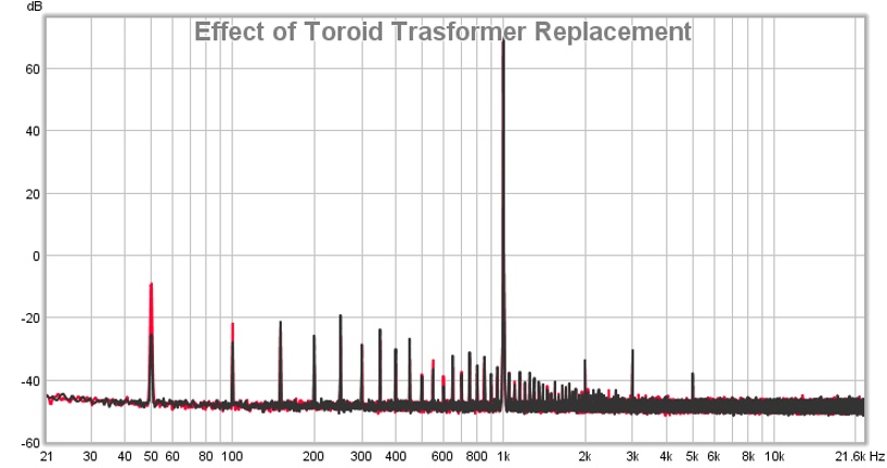

Improve a Rotel amp THD by 20dB!

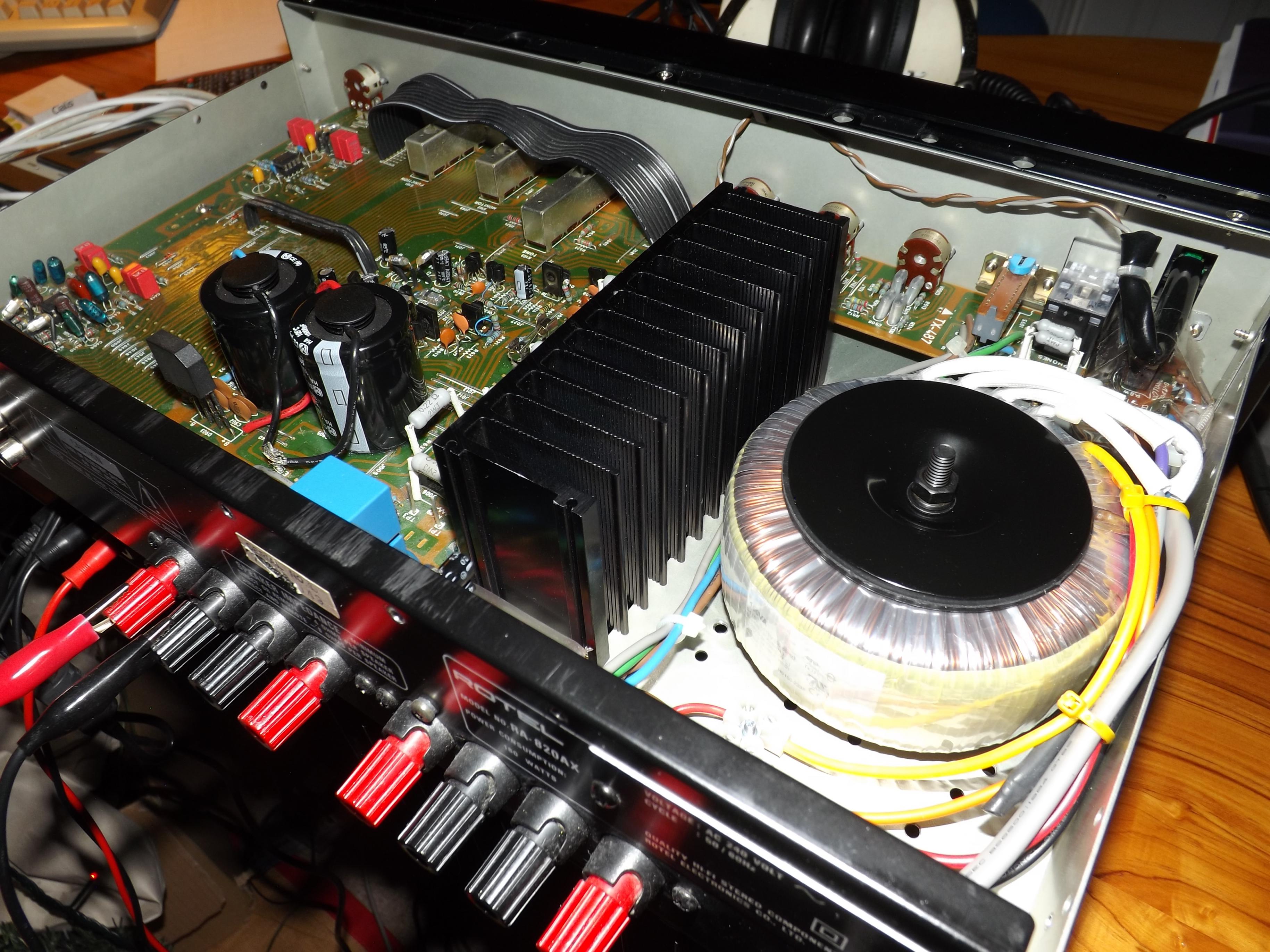

Toroid transformer finally put in and wiring secured in the RA-820AX.
Results are great:
DC stability is clearly better, no-load supplies are now +/-39V (up from +/-37v), main cap ripple less than 25mVac and below 5mV past the input stage filters. Absolutely no audible mechanical hum.
Bias stays solidly as set at 4 mV, and both heatsink and transformer temperatures stay cool at about 30oC. The hottest parts anywhere in the amp are now the speaker protection relays!
And best of all, the stubborn 50Hz peak on the spectrum which has frustrated me for so long - is now down by a whopping 18dB !!! (Red trace is "before", black "after")
Not sure whether it is a true representation of the tech difference between E-cores and Toroidals, or if the old Rotel tranny was actually already on the blink.
Anyway, I also tidied things up a bit and removed the experimental two-stage Miller feedback airwires to go back to a standard single 100pF, so THD went slightly back up from 0.0012% to 0.0015%.
You know, I can live with that - as I think that I could now officially claim to have The best Rotel RA-820AX anywhere on the planet! Yeah!

I find it quite shocking how the switch to toroidal netted an 18dB reduction in 50Hz humm.
It is curious, but the transformer, or mounting, is defective. It the transformer case loses it's ground, this can happen.
Maybe that also brings the turn-on thump down.
It would normally reduce / eliminate the sharp "crack" of turn-off. You could also add a metal oxide varistor (MOV) directly across the primary, after the fuse and power switch. This will also help with turnoff noises, thumps and the like. It also provides line surge protection.

Well, I believe that credit is due where credit is due.
(OK, could someone please put that quote down to a deep, deep insight?)
The very reasonably priced toroidal transformer which I sourced through Maplin was apparently made by Vigortronics Ltd. I bow my head as I had actually never heard of that company before, even though they are just beyond Oxford in the UK.
Anyway, the tranny is really well built - double isolated primary leads and proper gauge secondary wires, etc. And the measurements seem to confirm the internal quality. Another thing that added to the total product was that the included neoprene anti-slid mounting washers were at least twice the normal thickness, giving added mechanical vibration insulation.
I have absolutely no personal affiliation or interest to declare, I just thought that a product that gives great quality for a very reasonable price tag deserves a mention and a due credit.

Re: the reduction of 50 Hz hum with the new xfmr in, I can only assume that stray fields which previously got into the circuit somewhere are much lower now (it can't come from the rectifier). Obviously a toroidal would suggest magnetic, but if the xfmr has a shield winding it may also be electric.
It may just have been ground loop noise from the measurement setup anyway (ground loops like picking up magnetic fields after all, not to mention the issue of capacitive coupling to the mains in the xmfr, the effect of which may vary depending on mains plug polarity and which tends to be combated using shield windings on circuit ground). Here's how I'd test for this:

If the new xfmr is quiet, that's good. Large toroidals (especially 500 VA up) enjoy a reputation for liking to hum when there is significant DC / imbalance on the mains.
I'll second that.
Re: the reduction of 50 Hz hum with the new xfmr in, I can only assume that stray fields which previously got into the circuit somewhere are much lower now...
...Large toroidals (especially 500 VA up) enjoy a reputation for liking to hum when there is significant DC / imbalance on the mains.
Any toroidal will hum if there is a net DC field present in it's core as the core can easily get saturated. There does not have to be DS present in the mains, it's enough thet the currents drawn through the windings do not add to net zero between the positive and negative half-cycles of the mains. THis situation does happen dynamically as the current drawn varies with the output signal of the amp, which is why testing with dummy loads often tends to reveal a 'singing' transformer (and sometimes other parts but we are not talking about them now). However, the net DC in the audio signal should be zero so the core equalizes (demagnetizes) across multiple cycles of the mains.
I would wager the reduction of the 50Hz and harmonics is due to electrostatic shielding but also due to the reduction of the stray field generated in the peaks of the mains sine due to the old smaller core going near saturation during peak currents that charge the filter caps through the rectifier. A larger transformer is capable of higher peak currents to begin with.
Also, if it is wound with rectification on the secondary side in mind, rather than, say, driving an incandescent halogen lamp which is a pure resistor, it will be would for a lower flux density in the core, which equals to more turns per volt. This produces more headroom for peak rectification currents, and to an extent, DC imbalance - but the transformer ends up being larger, i.e. more expensive. This is incidentally why some people use vastly over-specified transformers WRT VA rating - to get the required maximum peak current by brute force, mostly to feed a lot of filter caps. However, optimizing for lower Bmax in the core gives a MUCH better behaved power supply (less stray fields, softer peaks on currents, less diode ringing etc) and can end up in a cheaper transformer if you can live with somewhat worse regulation (in many cases such a transformer has to supply a class A amplifier so this is not really an issue).
Thank you ilimzn, that could maybe explain the improvements by the toroidal.
However, I still have a hunch that the old Rotel e-core tranny may have been damaged. It has been too long since I studied the failure mechanisms of transformers, but I seem to recall that degradation and oxidation can be gradual for both the windings, internal solder joints and the thermal switch, leading to the formation of semiconducting or other weak spots and then to eventual failure when stressed?
Anyway, the ac mains quality in the UK is not very impressive or indeed EU standard 230V harmonized. This morning I measured 244Vac, -5.2Vdc (!) and lots of spiky noise.
On the positive side, I guess that makes the final RA-820AX rail supply noise immunity achievements even more impressive?
