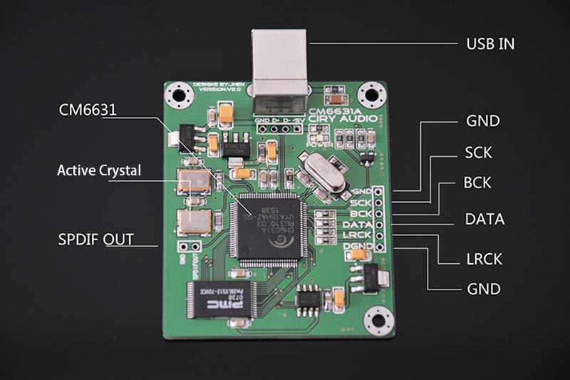

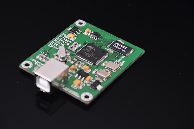

Which USB 2 I2S do you use? I see the elderly DP106 (aka CM106 with I2S) used on the L1387 is Isocronous. I'd prefer an async chip.

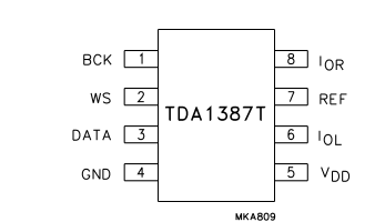

Looking at this to convert USB to I2S.
The TDA1387 has BCK, WS and DATA
WS = SCK?
No, WS = LRCK.
Not sure what SCK is.
If I don't care about jitter, then CM108. When I do, then CM6631A.
I think SCK means 'system clock' or another name for it would be 'master clock'. This is normally something like 256fs and its needed by some DACs that do high-order oversampling (S-D ones, in general). TDA1387 has no need of such a high clock frequency.
