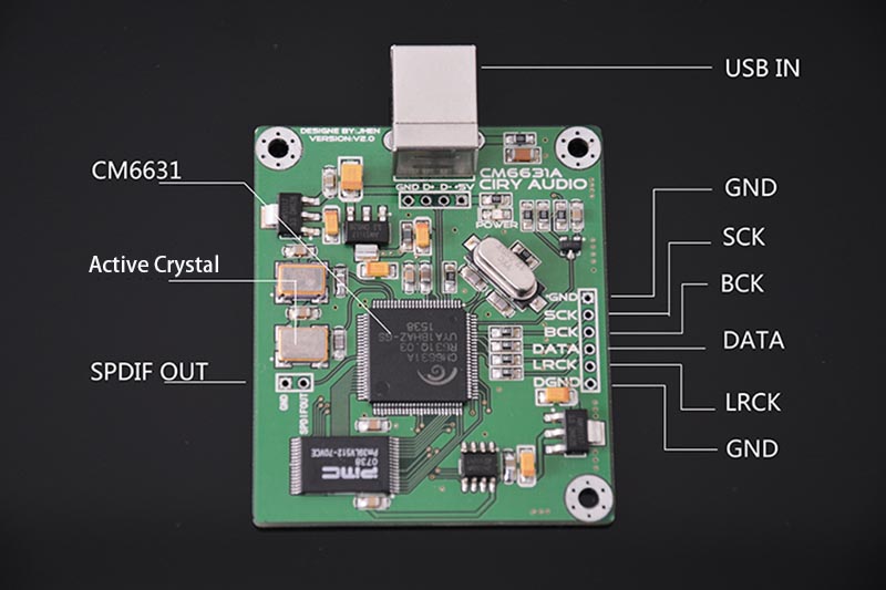

I thought the only way to properly have minimal jitter is with an individual crystal. This doesn't have that.
Aliexpress.com : Buy XMOS +CPLD USB digital interface Module I2S Output SPDIF Output DSD256 DAC Decoder Board With USB Seat from Reliable Digital-to-Analog Converter suppliers on Hi IC Store
snoop .... why do you keep showing this Cm6631a Interface Module in your posts?!!Looking at this to convert USB to I2S.
The TDA1387 has BCK, WS and DATA
WS = SCK?
If you're promoting it, or otherwise interested in it, use a DEDICATED THREAD!!!!!!!!!!
Because I am (or was) intending to make a PCB to fit over the top of it. The aliexpress seller is recommending the XMOS though.
