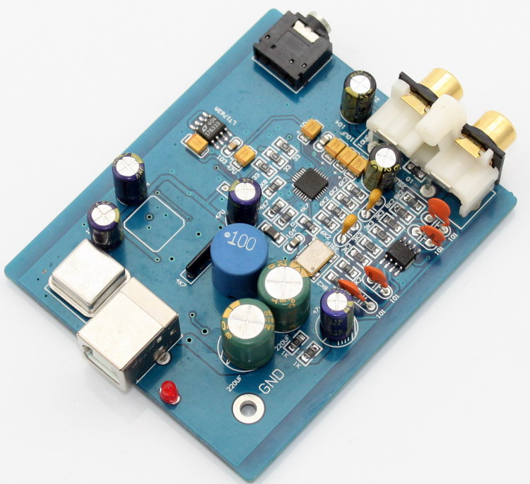

This one from aliexpress is a little bigger. First things first,
1. The PCB design is a joke. Whoever made it was in a rush or didn't know what they were doing.
2. the components aren't the best, especially the capacitors which are not ceramic and many hole-through components have been chosen merely to save on a few cents.
3. the audio is being fed into an op-amp to feed the headphone socket and there's some resistance to then feed the phonos. This will colour the sound.
Sound quality wise it's not bad at all. It walks over the TDA5102 with a more acute upper-end and sound-stage. It doesn't however beat the ES9023 (which requires a mandatory op-amp). Perhaps if the PCB had been designed properly and if the op-amp had been used only for the phono then the 9018, as a technically better chip, would take top spot.

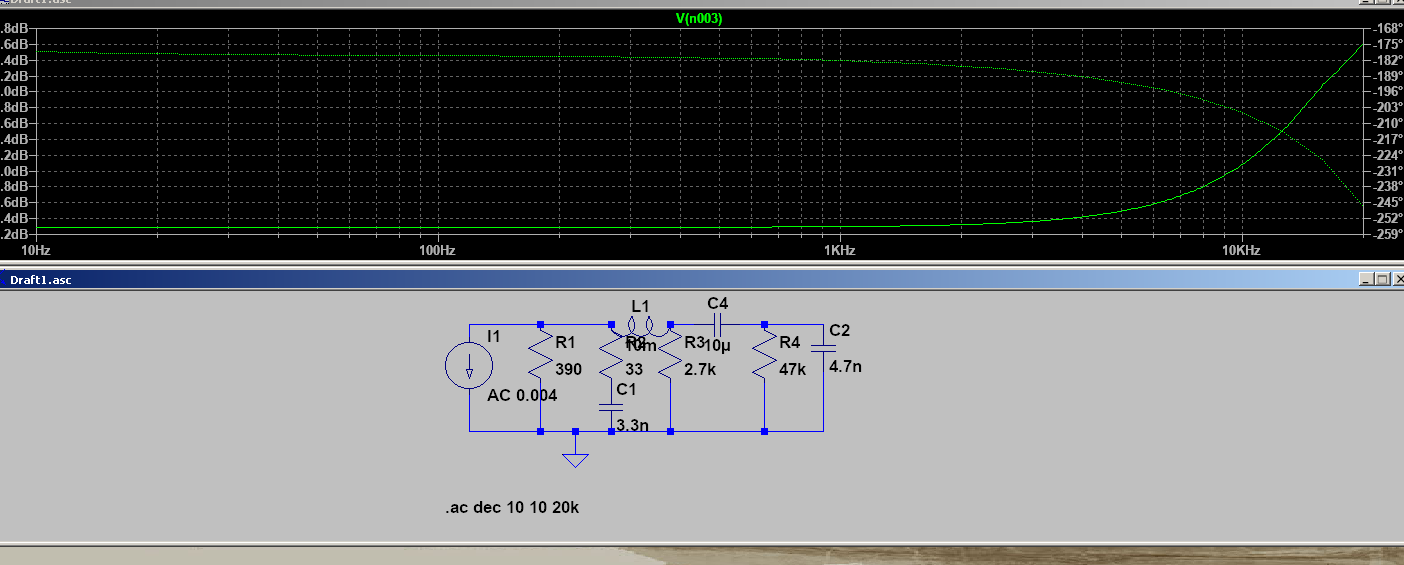

Hi @abraxalito, I have saved the schematic from that blog but it seems incomplete, there are 3 transistors used in the component list and in the schematic I can see only one; I would like to try the Anti-imaging and NOS droop filter, could you tell me what value is R44 and R45, is it in kohm or in ohm? also, what are I20 and I21 representing on the right side?
I imagine these values are for 4 paralelled TDA1387s, do I have to change some value in case of using 8 paralelled TDA's? I was thinking that R46 needs to be changed in this case
you have also posted another NOS drop filter in another thread, this one was together with some low frequency compensation, which one do you thing is more accurate or appropiate for the real NOS drop? thanks
I'm interested in trying out the simpler (second) schematic to give the board another chance. Did you build it for the L1387?
Also I read (may be incorrect) to remove the 2n2 (blue) caps. Why?
If my memory's correct, the second schematic was my attempt at reverse engineering a 'Hat' DAC designed for a RPi. It looked rather like this one (a Chinese clone of the original I think) : ???Raspberry pi2 pi3 B+???DAC TDA1387 8????I2S??-???
As its not my design, I just tweaked it a bit in LTSpice, I didn't try building it.
The 2n2 cap deletion was in another context, the 8*TDA1387 Taobao DAC with opamp output stage. 2n2 being the low pass filter caps around the opamp.

Looks pretty good to me.
What's with the bass correction?
which type choke do you recommend? these ok? Ferrite Cored RF Coil, Leaded RFC Inductor Choke, Inductance Range 100uH to 10mH | eBay
What's the 'it' ('Did you tweak it...') in post#64?
'Bass correction' in the 2nd filter isn't an aim, its just an artifact of how that filter works. Incidentally there's a mistake in the current source, it should be 4mA, not 8mA (for 8 chips).
You should try running the simulation with the 10mH choke you linked to, to see if its acceptable. The key parameter is the DCR (115ohm according to the data).

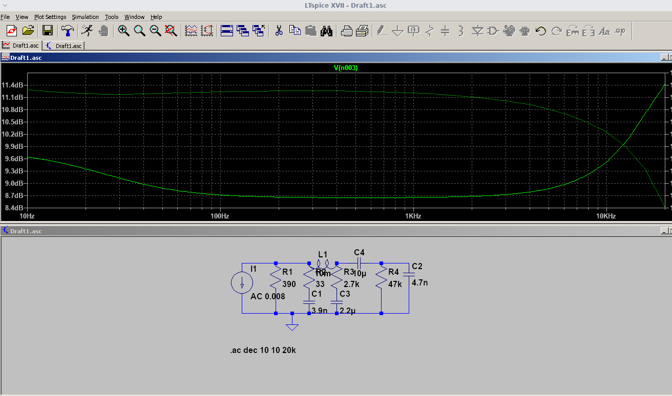

Re: bass correction, I disabled one of the capacitors and it removed the bass extension without affecting the treble, so to me it looks like it's specifically for that purpose. Are you aware of these chips having a bass deficiency? I recall you saying something about the 20ohm I/V resistor having an effect on bass perhaps its to counteract that?
The chips' bass can be improved a lot though I'm not sure anyone would notice a deficiency until they heard the improvement. Passive I/V is one way to get weak-ish bass, but boosting the LF amplitude isn't going to fix that as its about quality, not quantity.
D-S DACs with opamp OPSs are bass-deficient when compared to a TDA1387 with active I/V fed from a low impedance (say well under 1ohm) rail.

Still playing, don't notice the high end correction so much but the bass boost is obvious.
Can I get rid of the onboard decoupling capacitor when using this filter?

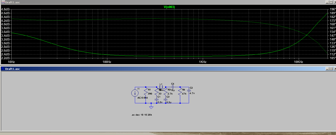

After playing I'm not satisfied with the top end boost, it's very much still missing. I haven't been able to work out which value in LTSpice to modify to increase the effect.
I reckon when it's corrected the DAC may become a contender for first place. 🙂

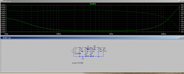

Hi abraxalito,Here's the revised *4 DAC schematic as there are component errors in that I put up in post #20. C11 & C12 should be 2.2uF, not 1uF.
Back to the earlier question about oscillations - a filter only rings when its excited and to excite it it needs energy in the input signal close to its resonant frequency. There's not much in audio above 16kHz or so so I reckon the emphasis on ringing is overblown. Your final point se is a good one - there's the upstream AAF to be accounted for at the very least, plus ringing from any EQs that have been employed.
I have put a scope on the output of one of my prototype DACs when playing a sinewave @ 15kHz or so. The usual NOS 'stairsteps' aren't anywhere to be seen but there is a visible modulation of the 15kHz by its first image frequency. I think I posted up a picture before in another thread where this was being discussed.
