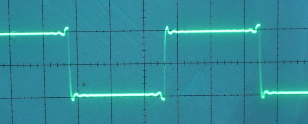

Here's a pretty bad example showing results from an oversampling PCM1794:

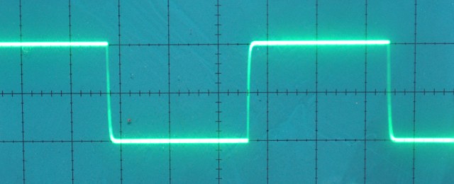

In contrast, a NOS DAC can produce a perfectly shaped square wave without the aberrations. Measurements from the same DIYA member of a NOS TDA1541:
My question is, what happens when we correct the NOS treble droop (inherent at 44.1kHz sampling rates) using the electronic LC filter you have designed? Do we get those same little oscillations? It looks like the TOTALDAC engineers tried an approach similar to yours and went from this:

The squarewave response you've shown for PCM1794 is typical for a linear phase reconstruction filter.
Yeah it can produce a 'perfect' square wave but only on the bench when fed with a sequence of samples which can't arise from a real recording. So these perfect looking scope shots are only of academic interest, any recording you buy will have already gone through an anti-aliasing filter at the ADC. That AAF will contribute at least post-ringing and most likely pre-ringing too as ADCs nowadays normally contain linear phase digital filters.

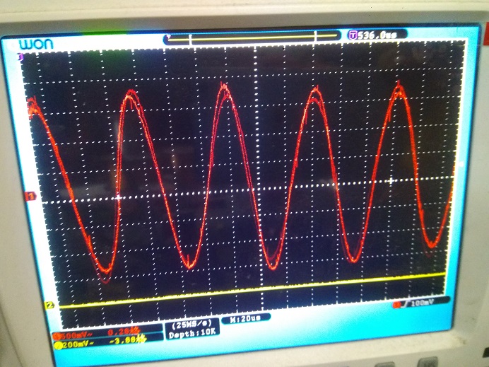

Back to the earlier question about oscillations - a filter only rings when its excited and to excite it it needs energy in the input signal close to its resonant frequency. There's not much in audio above 16kHz or so so I reckon the emphasis on ringing is overblown. Your final point se is a good one - there's the upstream AAF to be accounted for at the very least, plus ringing from any EQs that have been employed.
I have put a scope on the output of one of my prototype DACs when playing a sinewave @ 15kHz or so. The usual NOS 'stairsteps' aren't anywhere to be seen but there is a visible modulation of the 15kHz by its first image frequency. I think I posted up a picture before in another thread where this was being discussed.
Did some searching. Is this your pic you were referring to? 16kHz. Why are there no stairsteps?
The short answer is - the stairsteps got left behind in the filter. That's its purpose, getting rid of high frequency components - that is elements of the waveform above the Nyquist frequency (22.05kHz). The modulation visible is because here the above-Nyquist frequency (it'll be about 28kHz) is imperfectly filtered. Meaning only attenuated, not totally eliminated.

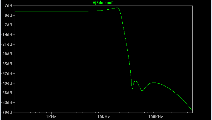

Here's the frequency response plot of the filter used. 28kHz gets about 26dB attenuation so the image frequency is about 1/20th of the fundamental.

Sorry, I cannot understand your question. The filter is having no effect on the lower frequencies, its a low pass.Also regarding your circuit am I correct in saying it is subduing the lower frequency rather than amplifying the frequencies post roll-off?
@se - I'm trying a different method of posting the filter's response.
