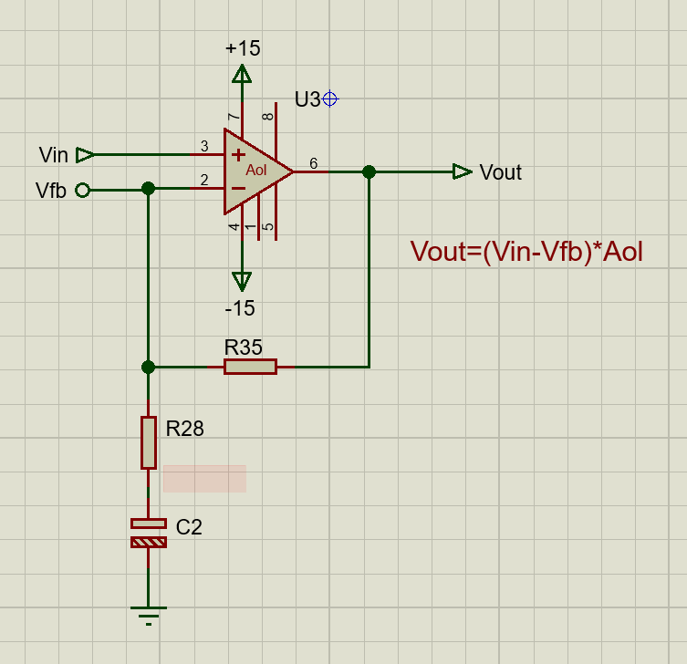

KCHANG said:
I thought that this issue must have been considered, and there must have been a consensus reached, as people have been building solid state amps for half a century by now.
Yes. It has been considered, and we have presented the consensus view:
1. you don't want any distortion here, as the loop will not correct it
2. with a big enough cap you will get vanishingly small distortion (alternatively you can use a smaller cap but then you have to use a linear cap and accept some LF rolloff)

That is correct if you assume that the feedback signal is an accurate sample of the output signal. Then anything within the loop is cancelled.
But if the feedback network itself distorts, if it does not present an accurate sample of Vout to the summing point, obviously the correction is also not correct and distortion will be created.

The DC-blocking feedback capacitor is in the signal path, but it's distortion is not reduced by feedback
Why? (the closed loop is one system, no matter the distortion inside the system it will self stabilize, the non-linearity can be anywhere in the path it doesn't matter below the reaction time, maybe at 50khz it can fail to correct, but with a proper bd of like 500khz the imperfection in the feedback resistor as well as the DC blocking caps will be part of the self correction)
Why does a capacitor 'quality' matters? The caps are doing their purpose to stop the DC signal and let a high bandwidth AC signal going through. What is the use of using a muse, blackgate, film cap? it makes no sense.
if the cap has a higher dissipation factor, which is still negligible, well the feedback is already divided... so it wont cause any issues, so a cheap normal cap should make no difference, same with wires...
That capacitor is a component in the voltage divider that determines the signal fed back to the error amplifier stage. It is not "in the loop" itself. Same for the feedback resistors. A 1% error in a feedback component will cause a 1% error in the output, no correction. The fact that the ratio of the resistors sets the nfb gain should be a clue that these parts are not "in the loop" and subject to correction. Just the contrary, they determine the performance of the amplifier.
Derive the formula for a nfb amplifier, including the imperfect amplifier, and then let the "open loop" amplifier gain be arbitrarily large enough to be a negligible factor in the formula. The overall amplifier characteristics are then determined solely by the components in the feedback divider (to that degree of approximation), and if those components are imperfect, then so is the amplifier performance.
This is why thermal distortion in the nfb resistors can cause problems, unless dealt with by using all identical resistors of the same value to make the desired gain. For example, 1k to ground, and nine 1k in series (for a composite 9k resistor), for a nfb gain of ten in the usual non-inverting topology.

Actually you clear up a few points correctly for me. The input signal is generally injected into the non-inverting input. Any extraneous signals across the capacitor are injected into the inverting input. Both signals are amplified by the same gain. However, the level of the extraneous signals is much much lower than the input signal. It's a double whammy. The feedback signal is already low, and any distortion generated by the capacitor is going to be a fraction of the feedback signal.
Yes and no. You must realize that that minuscule extraneous signal is amplified by the full open loop gain of the amplifier! So even if the error is just 10uV, and the open loop gain is say 60dB, it causes a 10mV error at the output. If the output signal is 10V, that's 0.1% distortion right there, and nothing you do to the amp will improve that.
