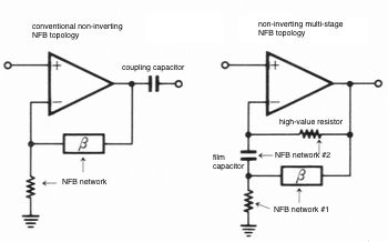

Although multi-stage feedback topologies are typically associated with inverting applications, the following non-inverting variation can be useful for attenuating DC without the use of high capacitance values (IOW electrolytics) or DC servos.
In the right figure, the addition of NFB network #2 with its high resistance value (hundreds of kohms, or megaohms) allows the capacitance value to be reduced to a range where film capacitors will be practical.
Apologies for the small text size - hope that blowing up the drawing will make it readable!
hth, jonathan

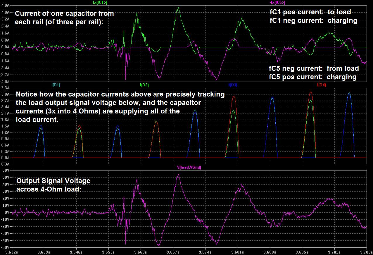

Hello,
HTML:
The supply rails are not the signal path, a constant current source is not the signal path (but a current mirror might be)
For a current to circulate in an electronic circuit, it should find a closed path.
How circulates a current in an audio output stage ??
Throught the power transistors, the loudspeaker and ... ?
And, the reservoir capacitors, which also are part of the power supply .
And, the output power transistors don't work in A class, with a current source, but in AB class !
The drawing comes from here: Power Supply Resevoir Size
Discussion N° 372.
It's a long discussion !

I'm not disputing that, I'm disputing that the rails are on the signal path. A signal is _information_, not electrons. And in a voltage amplifier the information is in the voltage and not the current.
I have a simulated amp at the moment - I can inject 1V on the rails and it will influence the output to the tune of less than a microvolt - 120dB rejection, the rails are not on the signal path. Any component capacitively coupling to the input node would have more influence on the output, without even being connected. The air around the input node has more right to be considered signal path than the supply rails!
