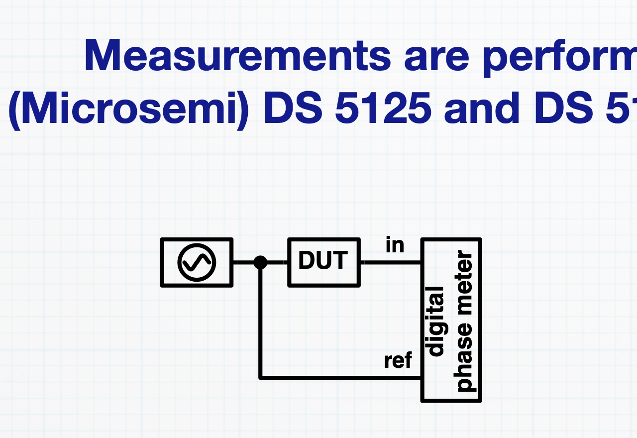

And btw - the link to the Italian professor about jitter uses the definition that jitter is > 10 Hz.
He also describes, as I also suggested previously, how a proper measurement setup is to be done ->

An other method would be to measure a pure & clean fs/4 sine (or other freq.) as others do or measure. Most even with AP555b even do not like to zoom in (Page Redirection), in other words how bad the side artifacts/Jitter spurious & PN bell would be. All a question how to setup the Acquisition & FFT& display of.

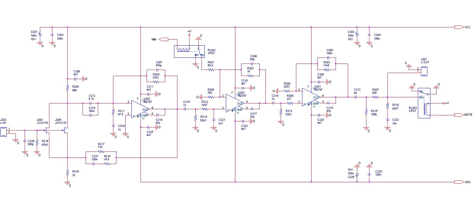

Then I found the circuit in the attached picture.
I have no words.
