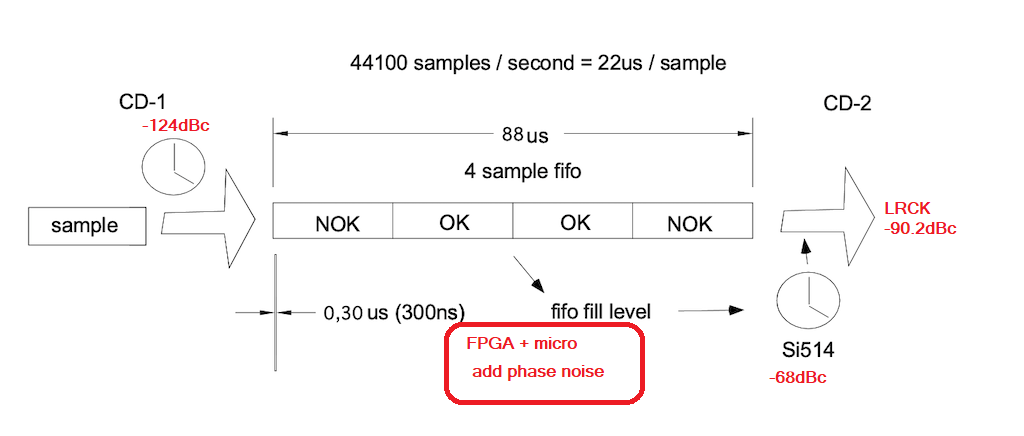

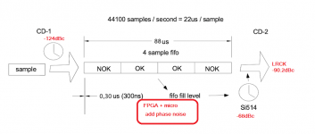

The plot is clear: RPI LRCK -124.8 dBc at 10 Hz from the carrier; DAM1021 LRCK -90.2 dBc at 10 Hz from the carrier.

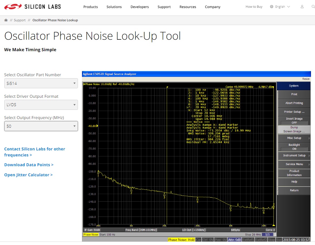

I attach the phase noise plot of the Si514 extracted from the Silicon Labs website.
The phase noise at 50 MHz (DAM master clock frequency is 49.152 MHz) is -99dBc at 100Hz from the carrier.
We are close to the 1/f3 region (Leeson equation) so add 30dB/decade and you get -69dBc at 10Hz from the carrier (vey poor oscillator).
Now subtract the theoretical 6dB for each division by 2 until 3.072 MHz, so 24dB.
Although in the real world it's a little different from the theory let assume the phase noise at 3.072 MHz is -69dBc - (-24dBc) = -93dBc at 10 Hz from the carrier (again poor oscillator, since our 6.144 MHz oscillator - double frequency - is -145dBc at 10 Hz from the carrier).
This is the theoretical better phase noise you can reach from the DAM1021 LRCK if the input time domain was well isolated from the FIFO time domain.
I have measured -90.2 dBc at 10Hz from the carrier, so around 3dB worse than the calculated value.
Would you dispute around 3dB?
Well, 3dB are the added phase noise by the FPGA and the micro and the beatings with the incoming jitter.

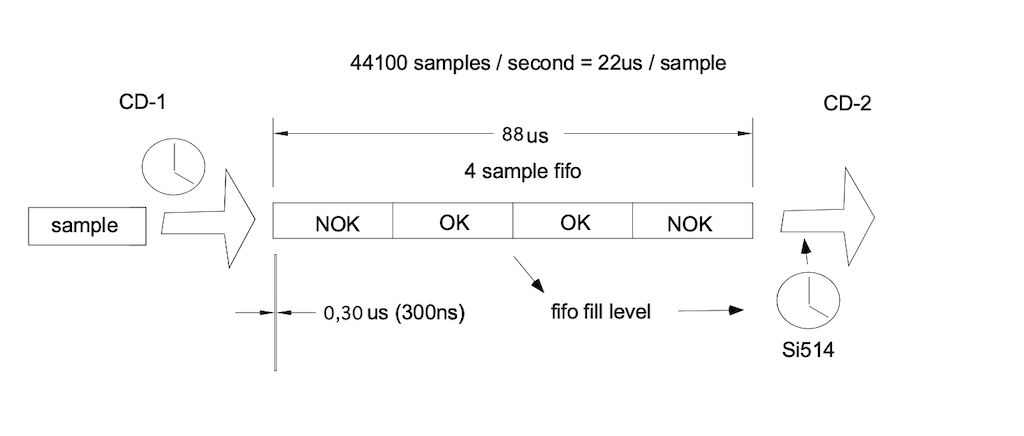

The "fifo fill level" in my picture is only software - its not in the "signal path" of the oscillator. This software orders frequency changes of the Si as a consequence of the fill level in the fifo. Do you think noise is added by an If statement in SW?
Your noise calculations look fine. So -90,2 dBc/Hz at 10Hz for LRCK driving the ladder - and this is including the addition from the fpga etc. At the ladder.
So how much of this -90,2 dBc/Hz at the ladder is coming from the incoming clock with -124dBc/Hz that you say contaminate the LRCK ?

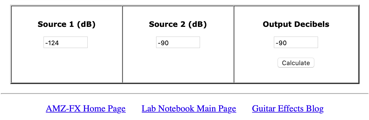

But its still quite irrelevant - we have -90dB at the ladder - some of it is said to come from the primary side of the fifo - how much?
-130 dB + (-93dB) is -93 dB....

If the FPGA logic is to track the source clock (instead of tracking a newly generated clock from a independant crystal) then by design whatever happens at the source clock side would somehow find it’s way through, no?
The DPLL logic of trying to follow the source clock by adjusting the Si, in itself these adjustments would be hunting up and down trying to keep track. This in itself would generate additional PN/jitter/timing errors, no?
I think I am starting to understand what Andrea is saying...
The FPGA is adjusting the SI to track/follow the source clock. This means, the source clock isn’t isolated coz FPGA is following the source. The DPLL mechanism hunts up-down while tracking the source clock, therefore potentially adding additional timing errors (jitter/PN or whatever it is called). Is my understanding correct?
Andrea’s new digital front end has a buffer big enough to avoid underrun/overrun; and generates a fresh clock with good crystals; the data (music samples) is reclocked with this fresh clock to the R2R switches/ladder. Is my understanding correct?
