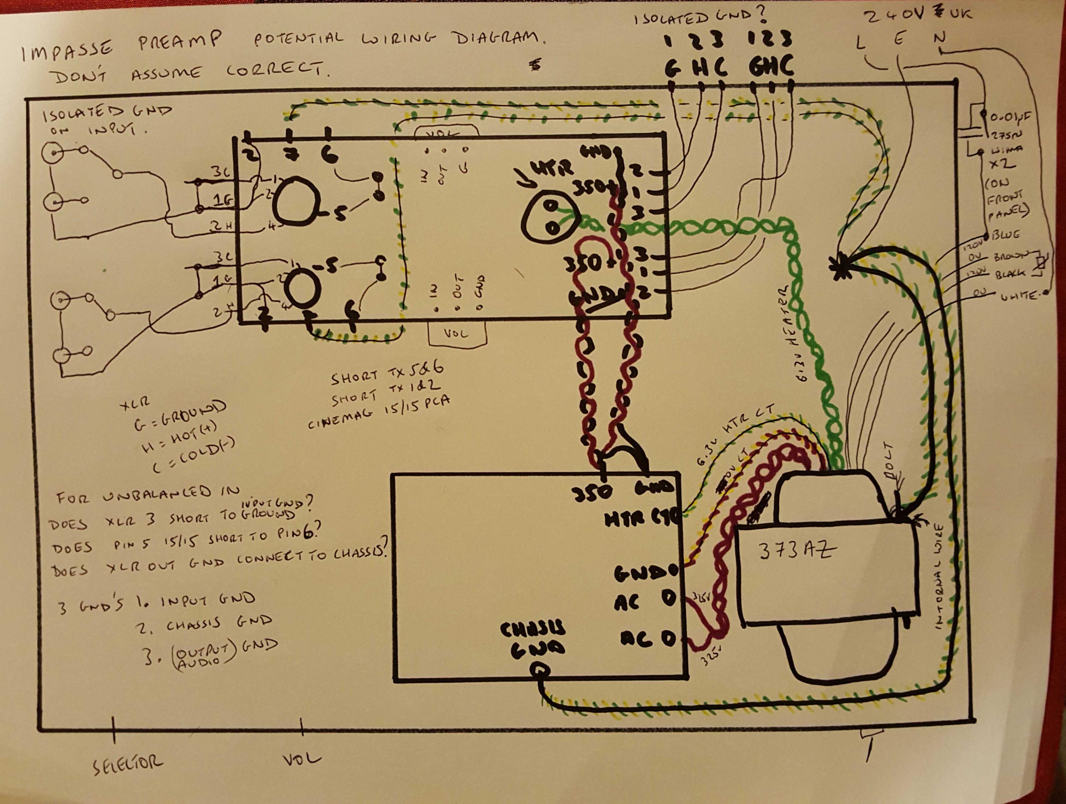

Im revisiting grounding.
At the moment i have the input transformer (cinemag cmli15-15) wired so the primary faraday shield (pin2) is connected to input ground (pin 1). This is not connected to the chassis so the input signal is isolated form the board by the transformer and presumably takes its ground reference from the source.
The can (pin7) is connected to chassis star ground. Rather a long wire in my opinion.
The secondary faraday shield (pin6) is connected to audio ground on the pcb.
The lead for audio ground from the psu to star ground is rather long. Should i move this closer and have longer wires for the other connections to star ground? That would also shorten the tx can wire (pin7) significantly.
Im seeing lots of diagrams connecting faraday shields to audio ground. On a power tx you connect with a very short cable to the chassis locally. Why wouldnt you connect the faraday shields of your input tx to the chassis? This tx has 2 of them.
Output xlr pin 1 is now connected to the chassis.
The impasse is running unbalanced in and then to the F4 single ended off the negative (xlr pin3) output.
And finally (probably most importantly), Im not convinced my chassis has particularly good earthing. The earth bond from safety ground is securely fastened to the base plate (paint scraped off etc) and that part is fine. Is there an easy way to ensure that the different panels are in fact suitably connected electrically as it seems just screwing the thing together as per instruction doesn't seem to be good enough. It doesnt seem right to have to scrap paint off at all the seams or screw holes? The face plate and control knobs/switches all show continuity to safety earth though. Just want to make sure that the rest is properly connected also and not 'hanging on by a thread'.
This ones a painted steel chassis from HIFI 2000. I think ill be getting full aluminium ones from now on as this wasnt an issue on my f4 build.

I've done some tracing on the boards that Jacinnj designed. Maybe that will help.
Jacinnj left several grounds optional with traces that can be connected, but are not connected unless you decide. I have the components on the board, but haven't fired it up yet, so I don't know which grounds are useful for noise. Perhaps Jacinnj or other Impasse builders can comment on where they connected grounds.
I am using Cinemag CMLI-15/15PCA trafos that were supplied with the board. Here are the pin-outs for the Cinemags.
Cinemag pin 1 to XLR pin 3
C pin 2 to XLR pin 1 (optional ?chassis? ground connection)
C pin 3 NC (no connection)
C pin 4 to XLR pin 2
C pin 5 to AGND, bottom of C1, P1 (audio ground of the pcb)
C pin 6 NC (option to AGND)
C pin 7 NC (option ?chassis? ground connection)
C pin 8 In+, top of R1, P1
SY's schematic and the Cinemag datasheet shows pin 6 connected to AGND.
Sy doesn't show any other ground connections to the trafo, but the typical application in the Cinemag datasheet shows both pins 2 and 7 to ground. Is that power system ground? input signal pin 1? chassis ground?
I would be curious to know what ground connections were made on quiet Impasse builds by other builders.

One question comes up. Have you run a ground to the output + (plate side) of the XLR? This was recommended by SY in the article for single ended output.
As for connecting the output XLR pin 1 to chassis ground, I wonder if this couldn't be a noise source. I wonder if you don't need some sort of isolation from the chassis, or completely floating the audio ground? I don't know the answer, just worrying about power supply noise getting in this way.
As for case ground integrity, I usually just go on resistance between screws connecting plates and, where possible, scraped off paint to panels. I've always found screwed together cases to have good continuity, in part because I don't paint inside screw holes.
I actually like steel enclosures. In some ways they are better at shielding than aluminum. And soft steel is trivial to bend if you are making your own. Of course, ally is prettier.
Jac
Thinking about it a bit more and I would explore your pin 1 output to ground, if I were you. Per SY's original schematic, he has a ground breaker circuit between the power supply ground and the chassis ground. Audio ground and power supply ground are connected but isolated from the chassis by the ground breaker and from the input by the Cinemags.
Jacinnj's boards follow this scheme. There is a star ground on the power supply board and on the signal board.

Hi Jac,
I had only connected the output PIN 1 xlr to chassis a couple of days ago. all this time with the noise troubles the output had been left as you suggested. This is something i am trying having reread the diyaudio grounding article.
I also have the plate output shorted via the xlr connecter on the interconnect as the article suggests.
This is the scheme i originally used to wire the thing up with.
The main difference now is that i have a better line filter. The safety earth is now on its own bolt. I have a dual pole mains switch without the cap. Doesnt seem to be sparking. The power tx now has its shield connected to the chassis right next to it.
That means i can move the star ground right close to the 2 boards and have much shorter wires. Just what to do with the faraday shields on the cinemags. I have the same one as you btw.

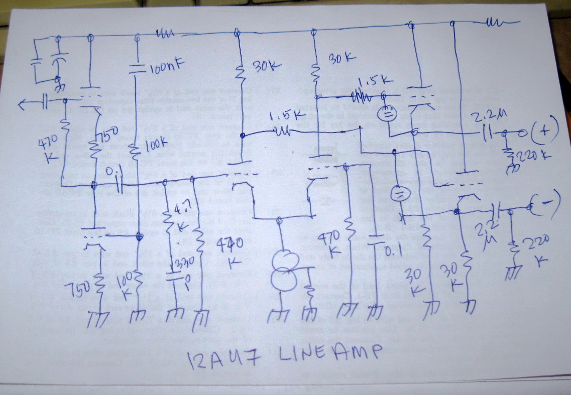

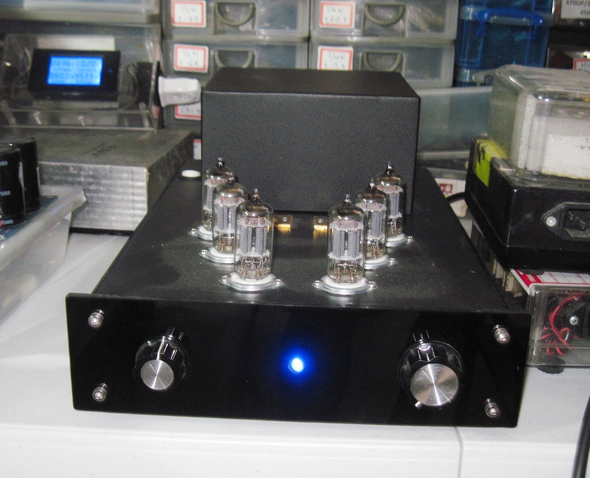

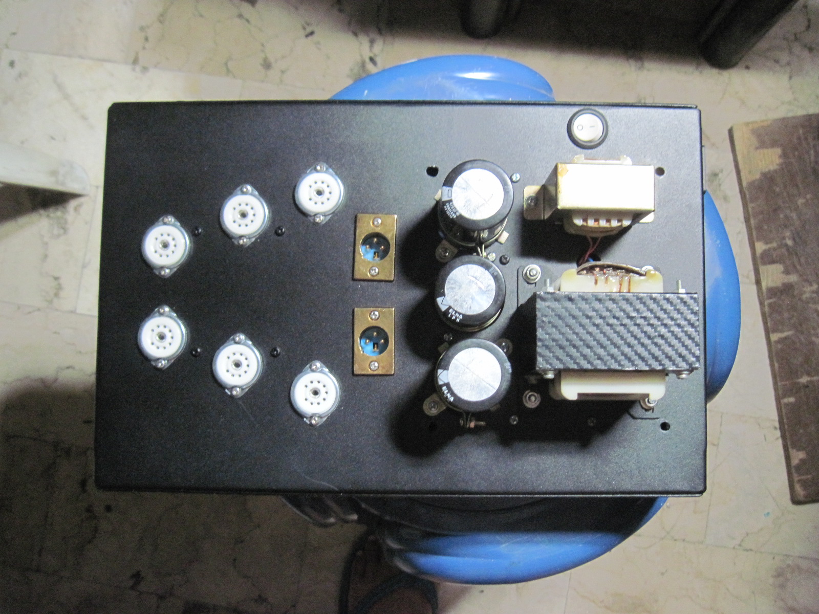

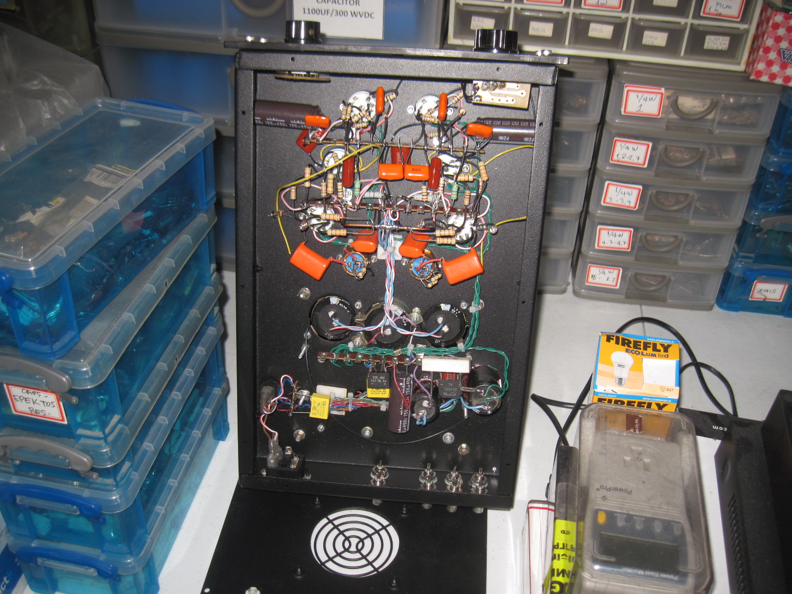

i am sure SY will not mind, i discussed this with him....
my 5814 long tail pair version of the Impasse..
Very cool!
Very cool!
thanks, this is my schematics...B+ is 250 volts
- ImPasse Preamplifier
