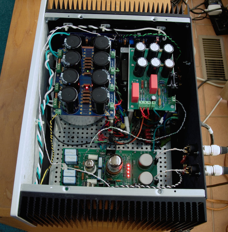

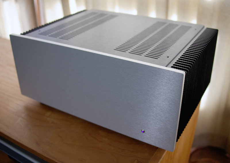

Impass + F4 Complete
I seem to be a sucker for a SY project. I like the way he explains his design process and choices in a way that I understand and buy into. A little bit like Papa Pass.
I managed to shoehorn an Impasse and an F4 into the same 4U enclosure. When I first saw the size of the 4U box, I thought it was huge. Then I started looking at how to arrange the pieces and, it may not be the tightest build I've ever done, but its pretty tight. I had to build a couple of "lofts" to float the power supply boards above their respective transformers.
My build is different than the original Impasse design in that I didn't need the pre-amp functions. In this case, the Impasse is operating as a voltage gain stage for the F4. Balanced input and single ended output. For anyone else using Cinemags and no volume control, 10k input impedance resistor with no zobel gave me perfect square waves at 10 kHz.
The thing is heavy. Easily 45 or 50 pounds.
Of course, the F4 gives off heat. I was surprised how much heat was given off by the Impasse. Not only the tubes and CCS transistors, but R11 and R12 run surprisingly hot. I don't quite understand why because they have the correct 120 VDC across them.
I had been worried about noise from having a 350 V transformer inside the box, but hum noise is non-existent. The only noise is a very faint white noise that is probably from one of the tubes. Naturally, lots of wire twisting was involved, but I'm happy with the result.
Its too early to compare sound quality with other amps, but I hope it works as well as advertised.

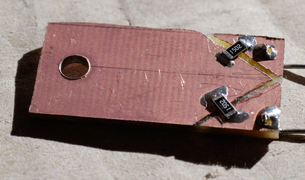

Power Resistors
Power resistors seem to always cause problems. The typical power resistor (metal oxide, thick film, etc) have measurable degradation in noise, poor temp coef., and poor tolerances. In the Impasse, R11 and R12 have to deal with about 1 watt and are part of the signal path, so they are worth the effort to try and improve.
Following the lead of Samuel Groner, DIYaudio member EUVL, and others, I have been experimenting with series/parallel quad resistors combinations. In this case, 4 Susumu HRG series SMD 1 Watt resistors arranged with 2 resistors in series on each side of a circuit board and the two sides in parallel. The result is a 4 Watt combined resistor.
In the picture, you can see my homemade quad resistor. I kept the resistors close to the motherboard, but used a 2 sided, copper clad circuit board 15 x 30 mm for heat transfer from the SMD resistors. It works nicely.
I had originally used Dale CPF power resistors. When I replaced the Dale's with the quads, the sound improved again. Clarity is improved. Background is quieter. The high frequency haze is gone and so was the attack overhang. Now, it is an amp that I really enjoy listening to. I think it's time to make a couple more quads to replace R4 and start comparing it to my other amps. ;-)

In the future, give a thought to the quad resistors. I was surprised how different they sound.
I managed to shoehorn an Impasse and an F4 into the same 4U enclosure. thing is heavy. Easily 45 or 50 pounds.
Jac
I'm surprised no one else has commented on your guts in deciding to cram both of these in one chassis, or on the build quality you've demonstrated. Great stuff!
