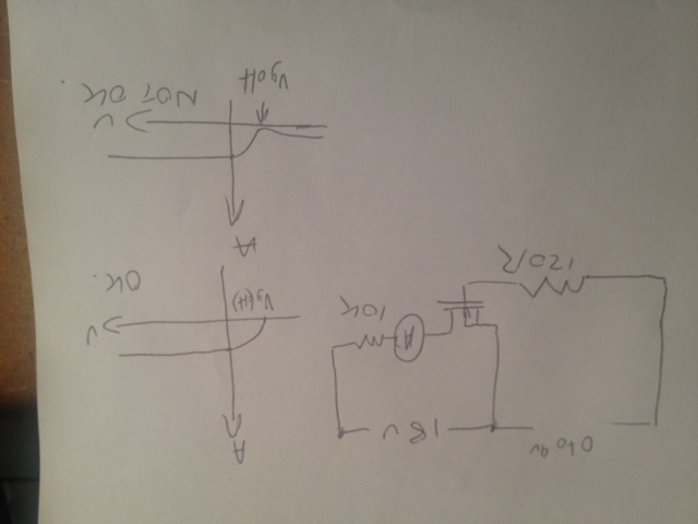

Mr. Dave,
Were you able to solve your fizzing noise issue? If not, I have one more area to suggest you might check.
About a year ago, I was building SY's Eq. OPP phono preamp which uses the same CCS design as the Impasse. At the time, I had a similar noise problem that ended up being an unusual problem with the DN2540 mosfets.
At present, I am building the Impasse and just got my batch of DN2540's for that project. In matching, I found the same problem on 2 or the first 12 parts I tested.
Jac

Exactly! My values were a little different, but it should work. I used a 9V battery with a pot to vary the negative voltage on the gate to source. I guess that worked like the gate resistor. I don't know enough to know if you can eliminate it, but it shouldn't matter.
Jac
