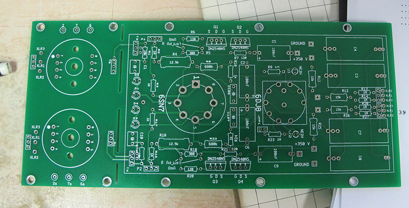

As usual, I'm late to the party. I have just been catching up on this design and, as usual, I find myself attracted to Stuart's clean and logical approach. I know this is a several years old, but do there happen to be any boards available?
Nope, I'm not holding my breath. Blue is my natural color.
Jac
$15. I also have Cinemag transformers and power supply PCB's

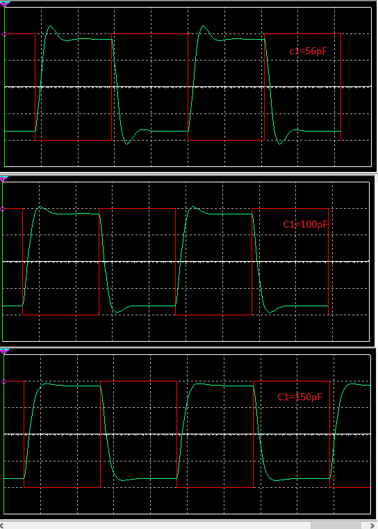

Luvdunhill, finally got to playing with loading of the Cinemag. With a 25k pot across the secondary, a Zobel of 330pF in series with 10k reduces the ringing to 5% and less than a cycle, well-damped (i.e., barely overshooting).

SY - How sensitive to capacitor value did you find the Zobel? I ask because I have some nice PS 430 pF in the drawer that I would try along side the 10k resistor, if it wasn't critical.
Thanks.
Jac

Tune the input impedance with a variable capacitor and potentiometer on the trafo secondary. Square wave and scope.
Jack,
This is my first time working with input trafo's and part of my interest in trying this project. I have a couple of questions on how to set up this test.
- Test the trafo and Zobel only, or should it be "in circuit" and if so, powered or not?
- I've read 10k Hz square wave, but what amplitude should I use? or several amplitudes?
- My function generator has an output impedance of 50R, but my source output impedance varies from 250R to 380R. Having never played with output impedance before, do I just add 200R in series with the output of the function generator?
Thanks in advance.
Jac
Hi Jac,
My mistake, this is an input zobel you're working with? If so, you can use the polystyrene. Best to follow Jack's lead and adjust with a variable capacitor first, then measure the value and get a fixed capacitor nearest to that.
-Chris
Thank you both Chris and Jack. You have helped me better understand and I will do the experiment.
