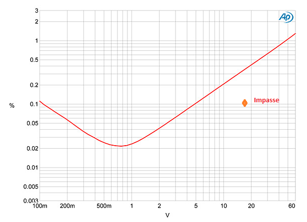

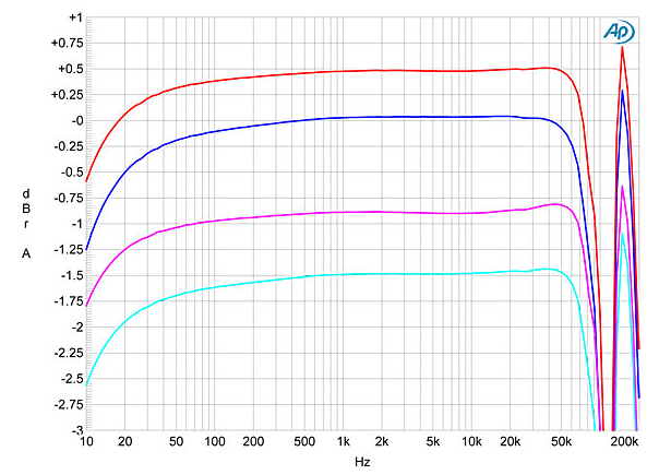

Here's a $19k tube line amplifier ($7k plus for the phono stage) which gets into trouble quickly. I'd suggest that you don't need an SYS2722, just a scope or network analyzer with gain and phase measurement capability out to 1MHz.
Those are the only bricks I am going to throw this morning. Certainly should answer the question of "Why DIY?". One of the advantages of the Impasse is that as the tubes age, the channels are going to "mature" about equally.
