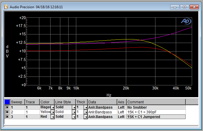

I wouldnt assume that 10k would be the best value. But probably a good safe starting place. Have a look at the datasheet if there is one.
The cinemag data sheet shows that the input impedance varies with load.
I suspect the 15k rating is a nominal rating, a bit like a loudspeaker, but as its a coil its sensitive to ac signals.
I the values on the datasheet examples range from 10k to 15k and I have an 18k resistor with mine.
Theres also space for a capacitor in series with the resistor which isnt used, just shorted.
There were some pictures somewhere, possibly on this thread somewhere. You put a square wave in and using a scope, experiment with different values of resistors and capacitors to see which give the the best loading. I think this means getting the output as square as possible without too much overshoot at the top of the rising edge.

A transformer will just transform the load, so yes, the input impedance will change as you change that resistor. However, the transformer reactances will cause ringing or rolloff if that load significantly deviates from the recommended one. For a transformer optimized for 10k, using a 100k load will result in some overshoot, thus the Zobel to control this. In the article, I gave the Zobel values for the Jensen, but they'll likely be different for a Sowter.

Jumper C1? -- maybe not.
Running a square wave it seemed that 15kΩ did a good job taming the ringing. Nevertheless, I observed a disappointing attenuation of the signal.
I ran the spectrum from 5kHz to 100kHz and observed the peak
Using C=1/2πRf = 390pF I soldered in a 390pF -- seems to be a good tradeoff.
