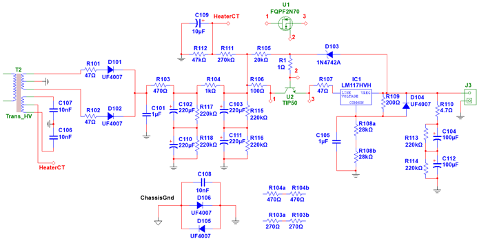

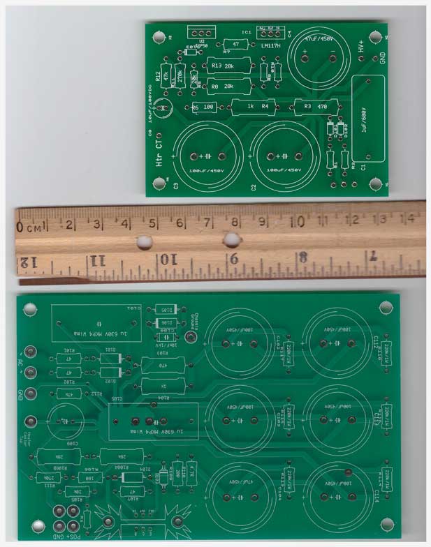

Some new (and old) Maida regulator PCB's with heater take-off. These also allow for using two electrolytic in series when the HV is higher than what SY had originally specified:
