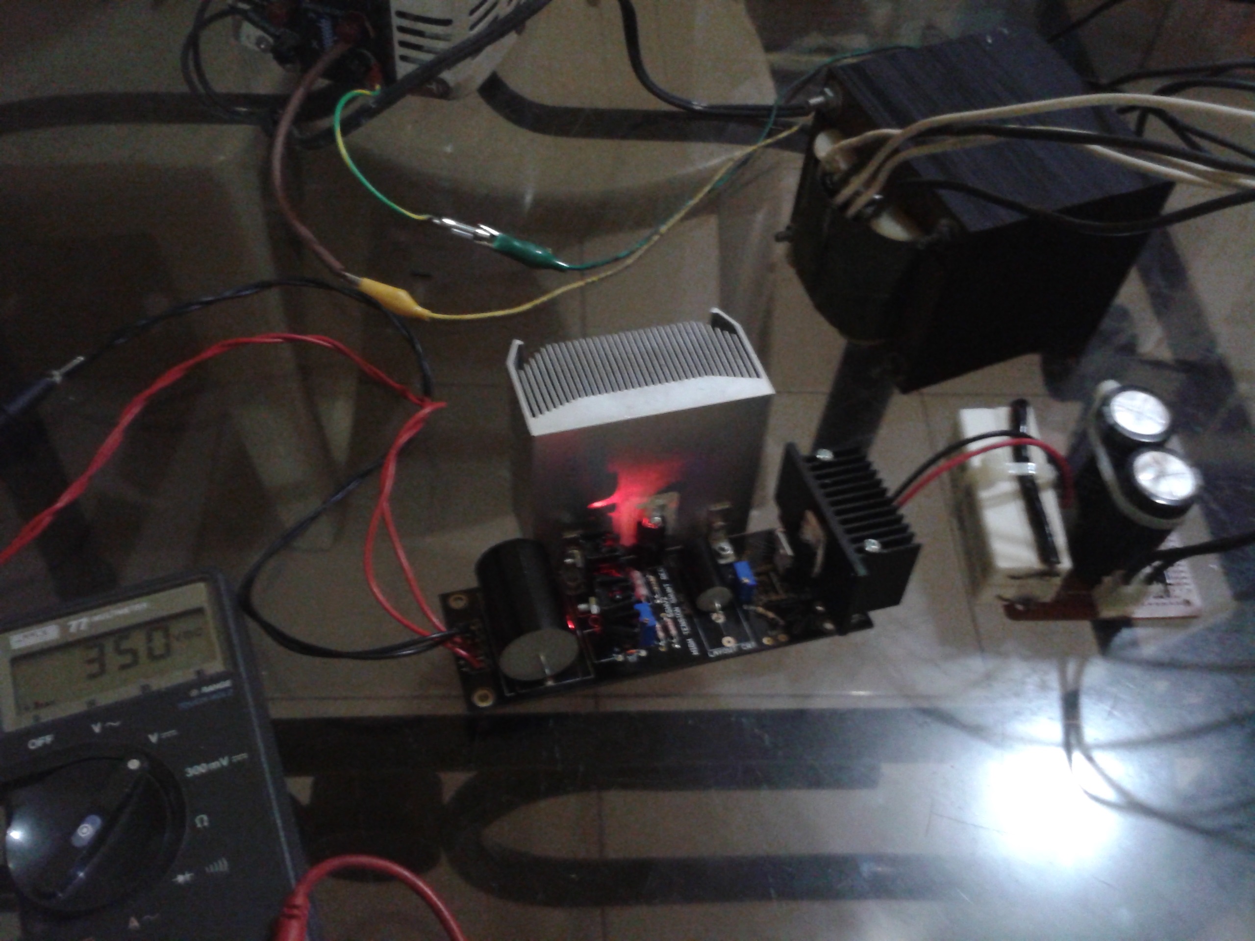

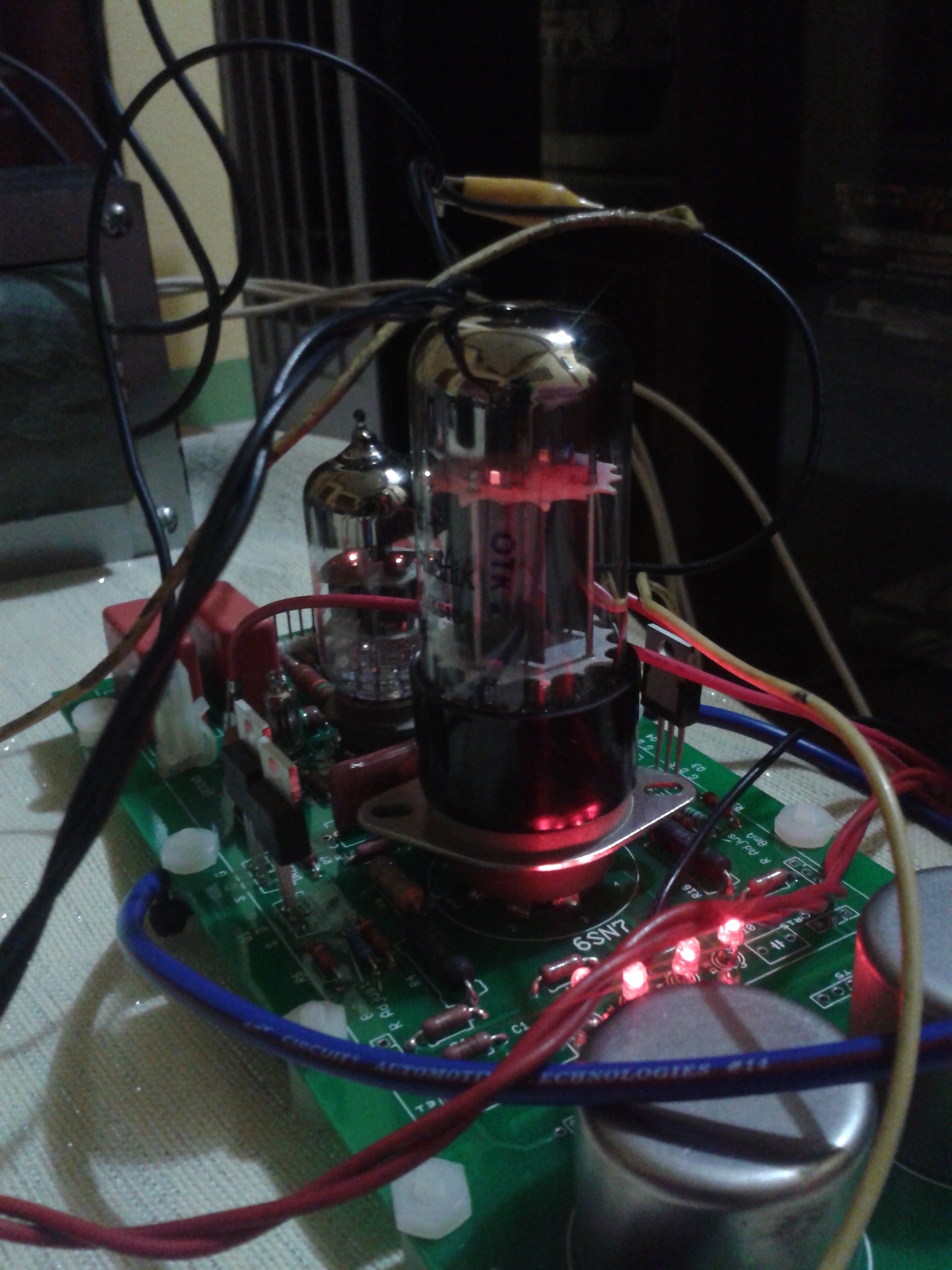

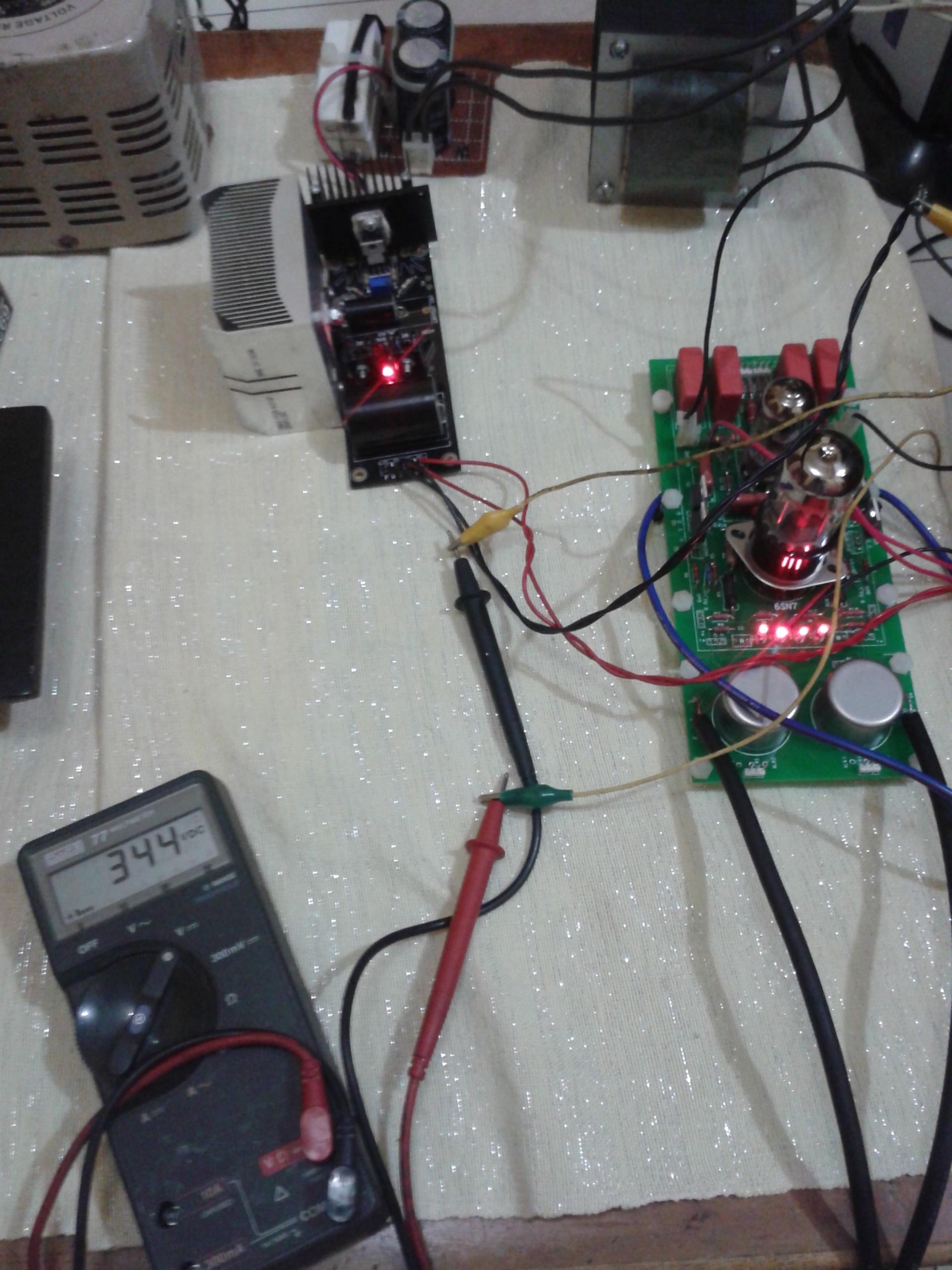

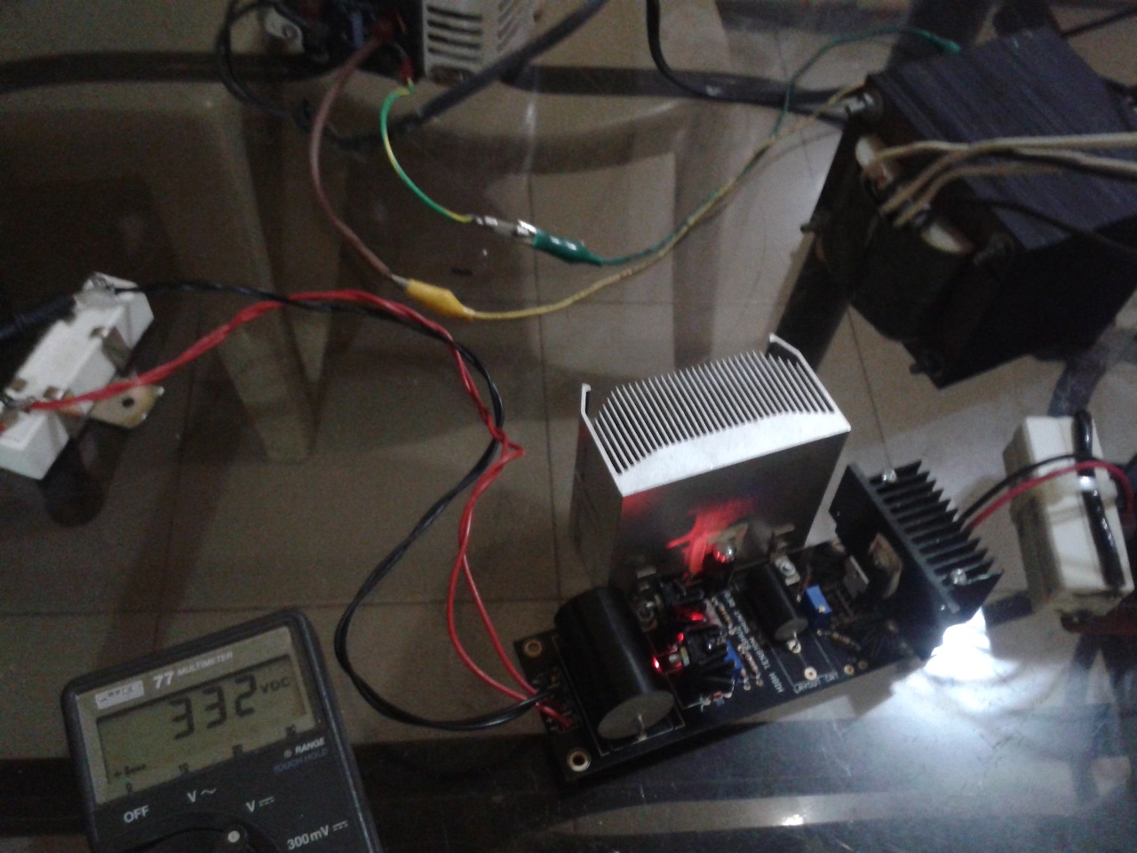

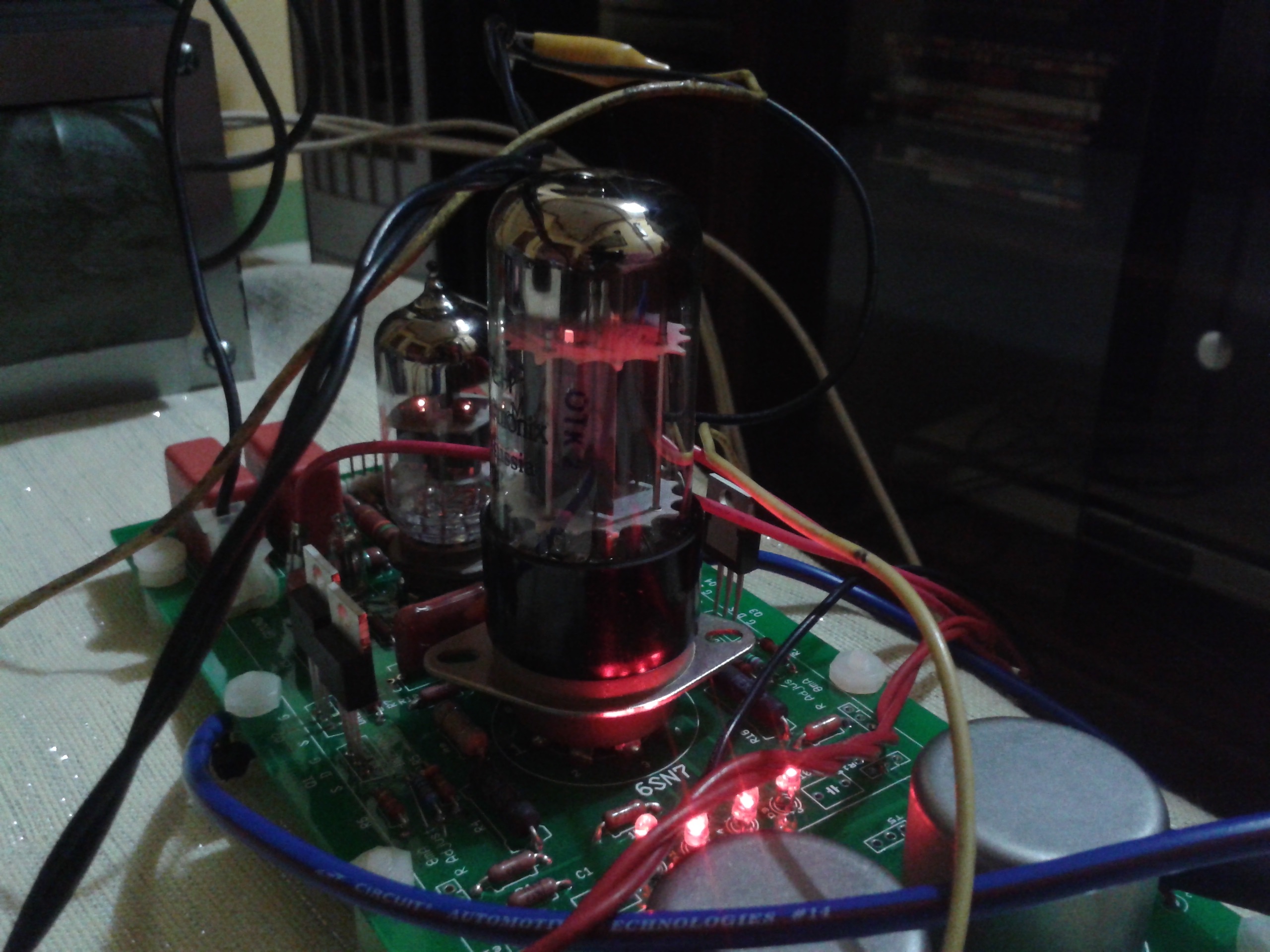

This is my first tube preamp and Gee this thing cooks...
I'm now ready to connect input to source and output to speaker.
To test as single-ended according to SY article I should connect XLR1+XLR2?
Then connect XLR1+XLR2 and XLR3 to speaker terminals?
Also, how do I connect inputs or should I short which pins?

Looks good -- you should probably check the temperature of the depletion MOSFETs (no fingers! use a non-contact IR thermometer)-- I haven't had to heat sink mine, but if the voltage coming off the regulator is too high they give up the excess in heat. I think the voltage drop is ~80V @8mA = 0.64W.
I had to put a small wing of aluminium on mine to keep them warm as opposed to hot.
