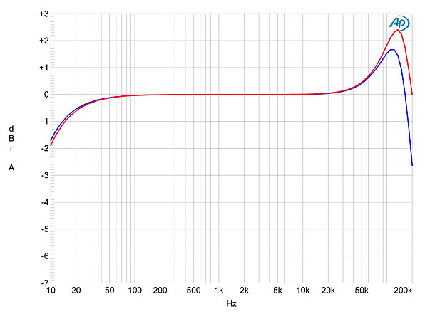

I would think for 25k it would be somewhat better matched than that. In reality though is the peak at 100khz a problem?
I take it you run the milliameter in line rather than measuring the voltage across the 12.5k (like I the artical) because it does away with having to know exactly what the the 12k5 is and gives you the direct value you what.
Similarly, does sy's artical measure the voltage drop as it's a bit simpler in practical terms?
Yes the peak is a problem. Test equipment is cheap enough and yet we see stuff like this often.
Yes, for sure. It shows potential ultrasonic instability, right?
OK. Yes, I remember when modding an alpha 5 CD player I ended up with an opamp that was unstable and oscilated very high (can't remember, but well out of audio) but it didn't sound very good. So I guess the problem is whats causing it to amplify 100khz a little more rather than the fact that 100khz is being amplified more.
Regarding the d MOSFETs, you (sy) mentioned that you had a lot of varience with them and discarded 2/3. Should I be matching those first? I recently had to match vbe for a load of transistors for a ladder filter. Is there a similar method for d MOSFETs and which parameter?
Yes it sure does. I know your circuits don't do that they are very nicely done.
